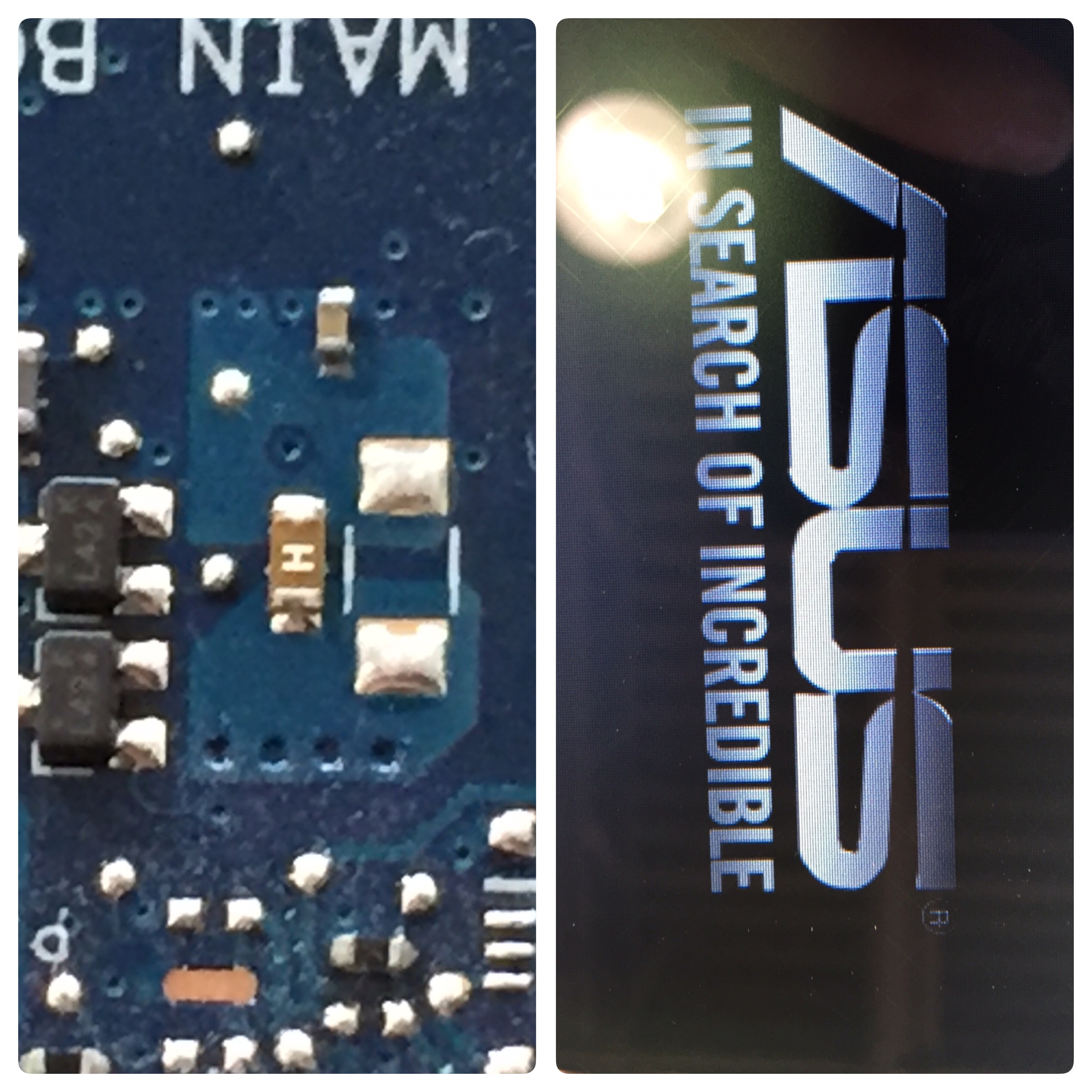

              • kpritchard
                • Aug 2013
                • 4
                Re: asus TP300L-DW07H
                I have a TP300LA that turns on but doesn't turn on backlight in the LCD (even with a replacement). Is this the issue you had? Did you find a resolution?

                  • kpritchard
                    • Aug 2013
                    • 4
                    Mine was the LA and intel only. I found a fuse beneath the LVDS connector, beige colored with an H on it that had blown. Bridged it and I have backlight again.
                    So, for searching purposes:
                    Asus Q302L TP300LA motherboard, no backlight -- fuse is located beneath the board, under the connector and is stamped with an H! I am so relieved this resolved my issue
                    Closeup of fuse attached. Again this is for no backlight, but external video is fine issues.
