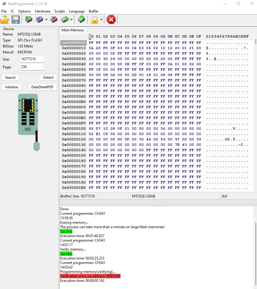

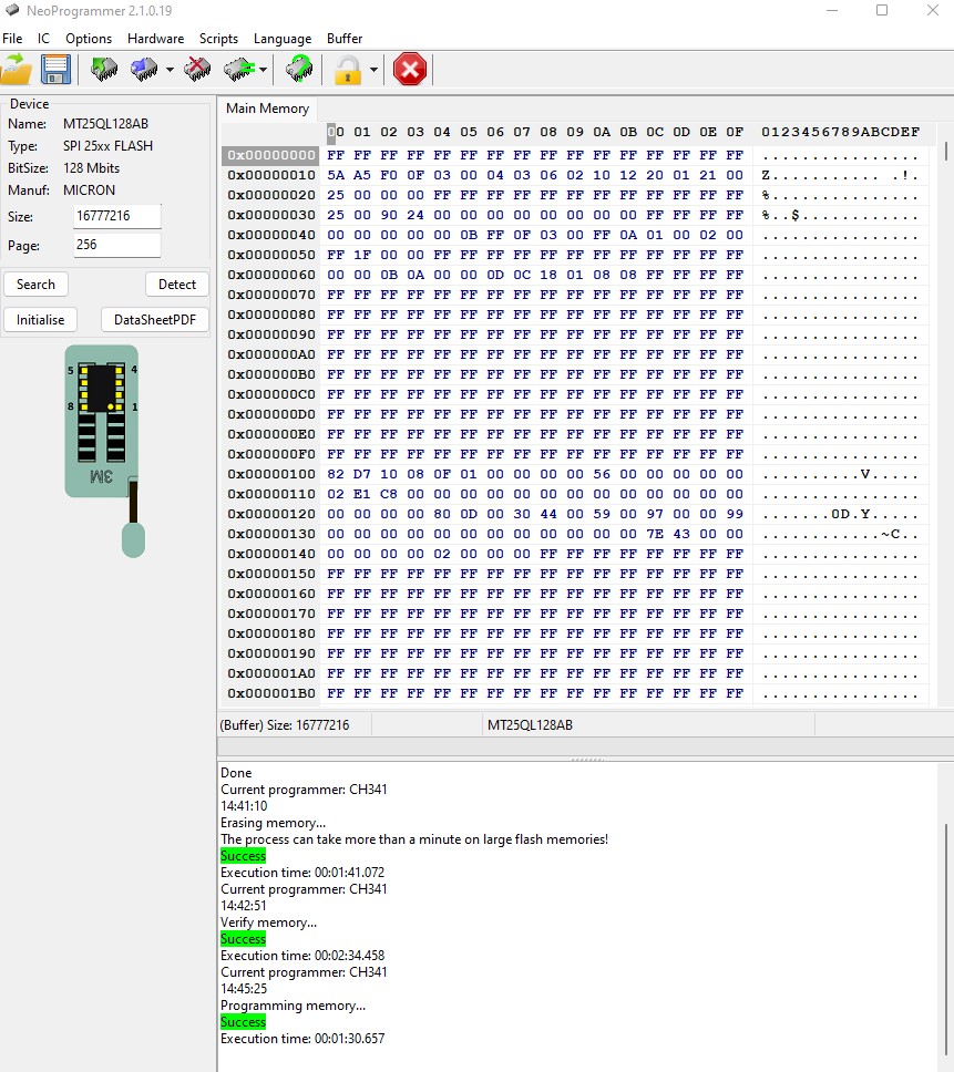

                            I have couple 9470m's to unlock. The ones with w25q128xV BIOS chip, they have UEFI Bios With Win8 pro stickers. These I can read unlock and write back no issues. They are easily get unlocked. But the others they have mt25ql128ab BIOS chip, they have Win7 Pro stickers. Chips get detected. I can read them. Unlock them no problem. When I want to write them they fail at verification. What I am missing here ?? Any help greatly appreciated. I read the chips removed, I use ch341 programmer.
                            • peste
                              • Dec 2016
                              • 13583
                              • ROMANIA
                              #114
                              Re: hp folio 9470m
                              stop the verification and write one like this, see what happens
                              • wolf3d.exe
                                • Jan 2023
                                • 33
                                #115
                                Re: hp folio 9470m
                                Goes well without verifying but the laptop, power light goes between white and orange. No boot, does not power on. I tried this on two laptops with same MICRON chips. In this (https://www.youtube.com/watch?v=96crJwtE1ls) video, the guy uses same chip, same controller and same programmer software with success. It is really annoying.

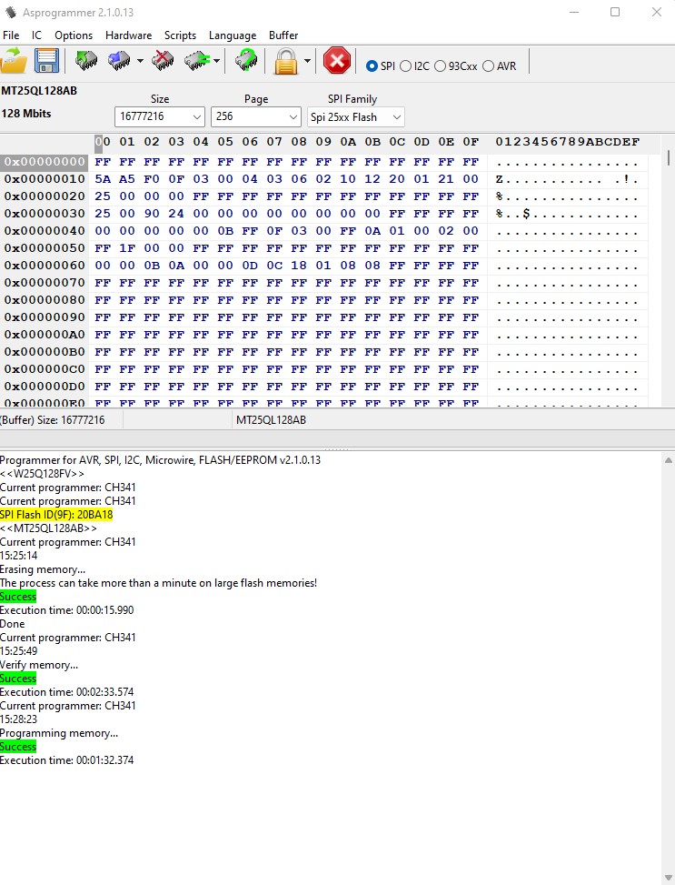

                                  Re: hp folio 9470m
                                  use one of these programs.
                                  https://www.badcaps.net/forum/showpo...6&postcount=10
                                  https://www.badcaps.net/forum/showpo...04&postcount=7
                                  • wolf3d.exe
                                    • Jan 2023
                                    • 33
                                    #117
                                    Re: hp folio 9470m
                                    Tried ASProgrammer with a .bin file that I downloaded from this thread. It worked. But I dont want to flash all the laptops with same bios (or is it ok?) How can I make sure that my dump is ok? (dumping multiple times, I do)
                                    Two laptops that I tried was unlocked with RCLocker. Probably that is the culprit?
                                    • peste
                                      • Dec 2016
                                      • 13583
                                      • ROMANIA
                                      #118
                                      Re: hp folio 9470m
                                      bios unlocked try it..
