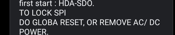

                      #171
                      this error am getting after programming the bios and the speaker is not working. please someone should help me
                      thanks in advance

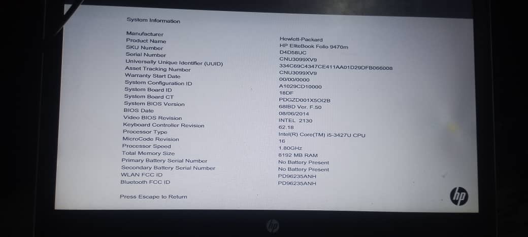

                          #173
                          Originally posted by peste
                          post S/N, full name and model, motherboard model,product number,etc.
                          s|N: CNU3099XV9
                          sku(pid)D4D58UC
                          MOTHER MODEL:9470M
