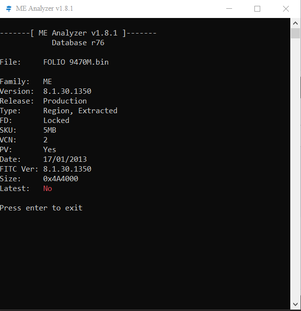

                    This is result from Alihomee's file ( #74 )
                    Maybe your issue from your programmer.

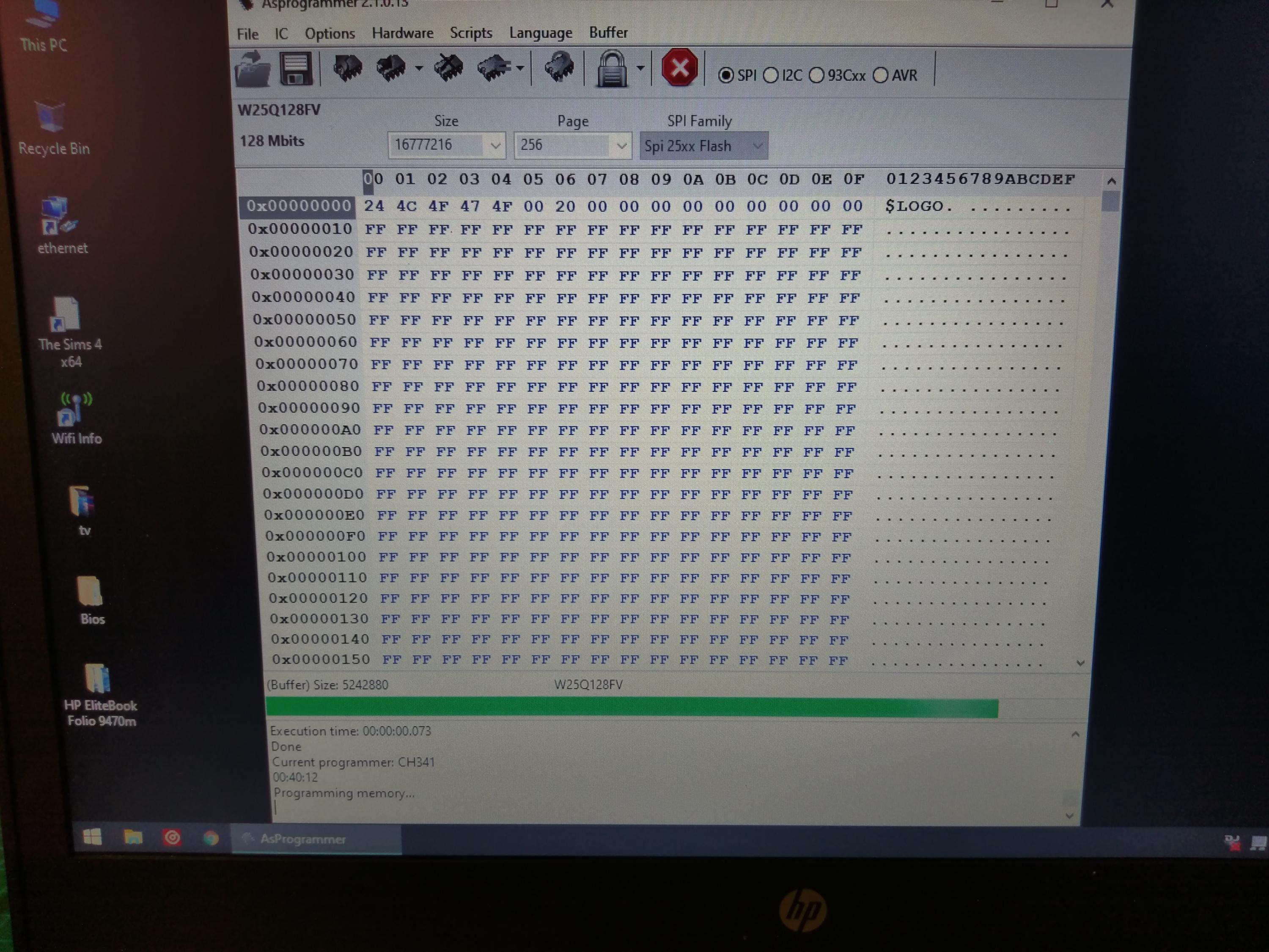

                            So I have manually picked that chip. and nothing. thing doesn't power on at all! I have tried to do lots. I can red the chip all day long. But I write it and it goes through just fine. but power button....NOTHING. (and yes it did work previous)

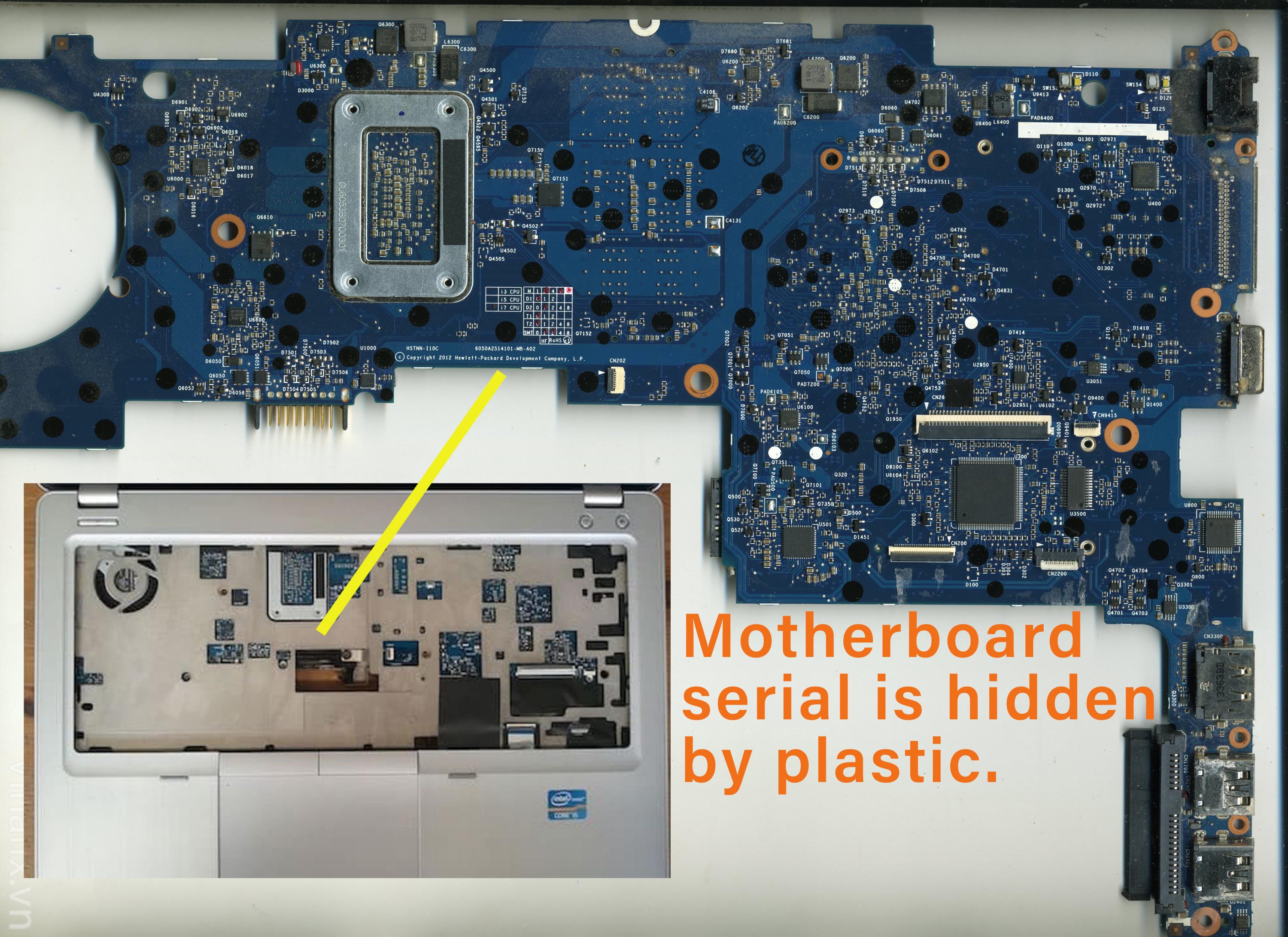

                              what's model of your mainboard ?

                                So I have looked at a bunch of the numbers and none of them are showing the MB model.
                                But im gonna have the i7 version. gonna be like the higher end of the board if that helps? Where can I find it?

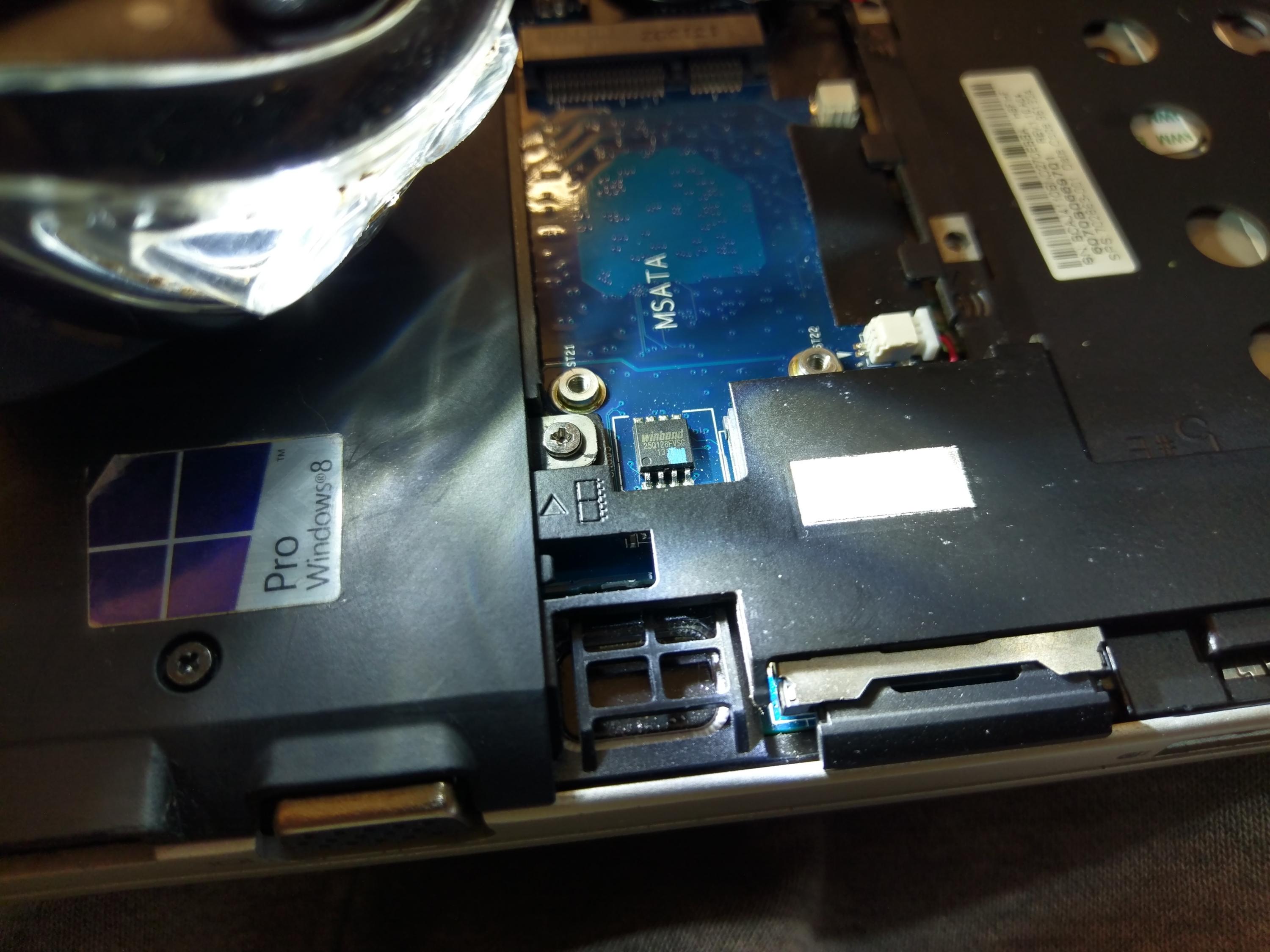

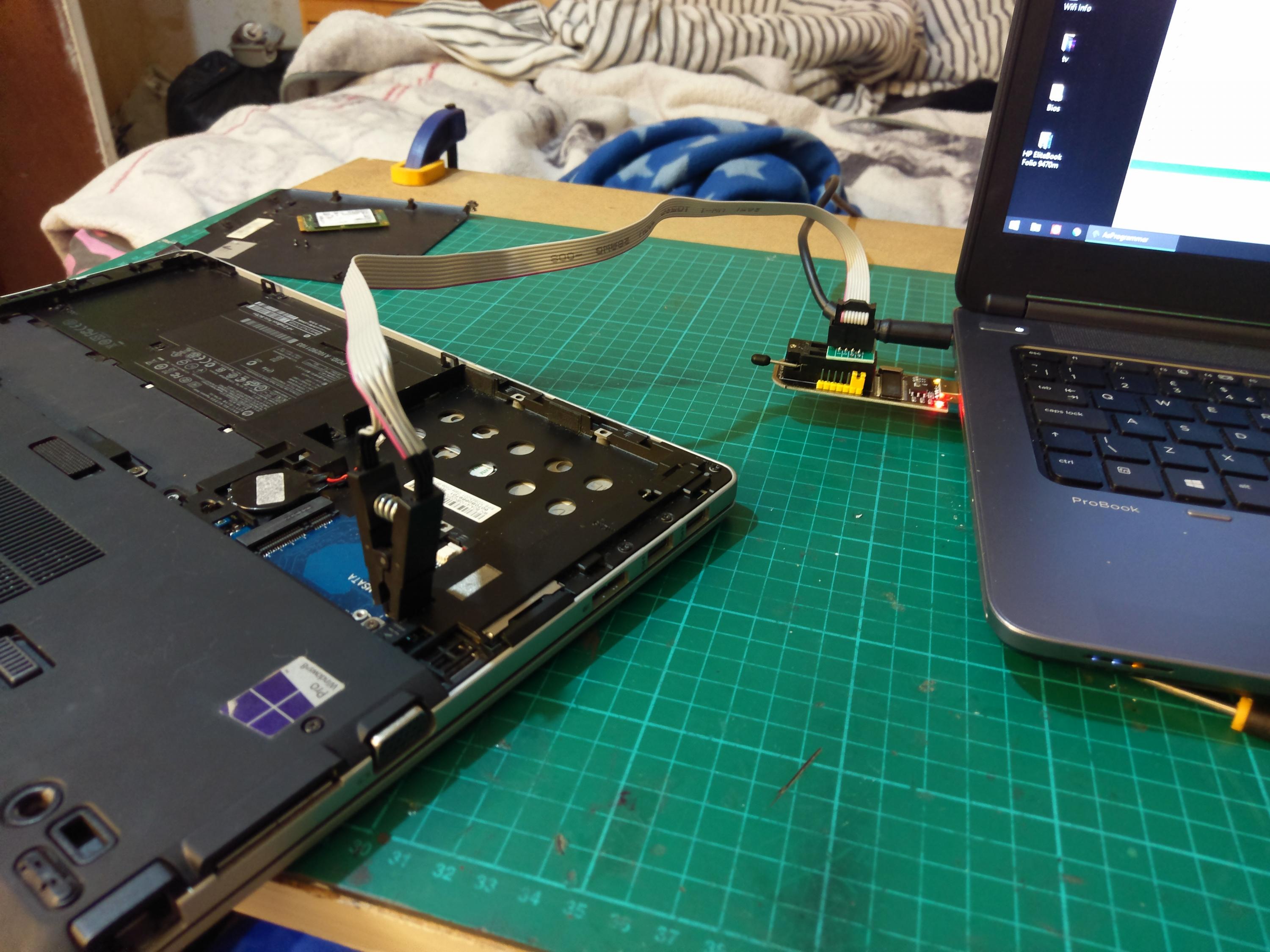

                                  Hello I recently had a corrupted bios on an HP Elitebook Folio 9470m
                                  Symptoms:
                                  No display
                                  Fan Full Speed
                                  Constant flashing caps lock
                                  It had a winbond bios. 25Q128FVSG 1327
                                  I re-flashed the bios using the CH314 programmer from ebay with the 8 pin clamp cable.
                                  I used Asprogrammer for windows 10.
                                  Finally i have attached the 16mb bios that finally worked for me.
                                  Newbfixer

                                      To identify the motherboard you will have to disassemble the laptop
                                      There is a great guide here.
                                      https://www.youtube.com/watch?v=2bRonuysxpc
                                      The model info you are looking for is located here.
                                      Good Luck

                                        so newbfixer, I tried to use yours and it says its protected, and when I click on the unprotect nothing really happens.
                                        I also tried the file that someone attached under your post. that wrote just fine. still no power with power button plugged in with charger.
                                        think it is just toast?
