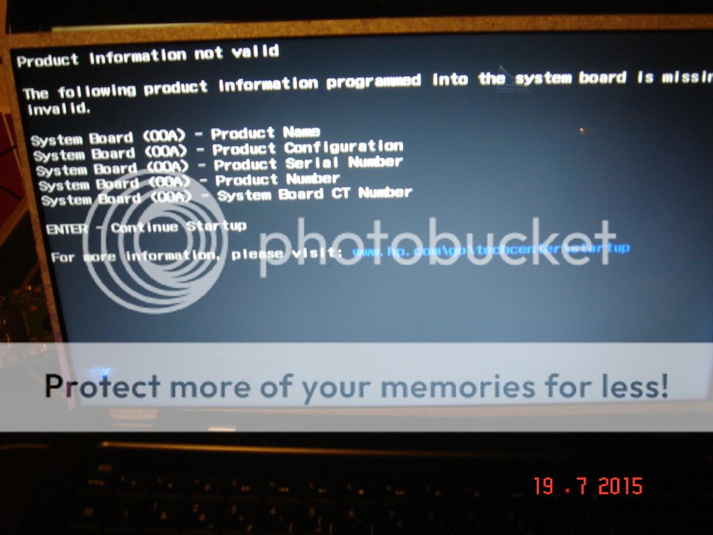

    Hello, I have revived another mobo from a HP g62-A41SF AMD
    Now the pc boot's with this screen :
    Please Help

    Re: HP G-62 AMD Flashed Bios Now SN is gone
    It is normal after flashing bios . Try an utility NBDMIFIT. Bat , make usb bootable and with this utility you put your serial number etc.

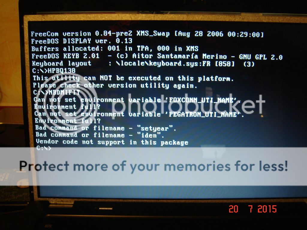

      Can you please be more specific ?
      I have done the above, and I only see C:/ on the screen
      thanks
        Well, I dig a little bit, and here the result :
        Anyone else that can help please ?
                you need to command NBDMIFIT.BAT
                .BAT EXTENSION to take command.
                    Originally posted by ala_borbe
                    do you have backup of old nonworking bios?
                    No change, same result !
                    Other tips ?
                      Problem solved using HPBFO300 application
                      Thank you
