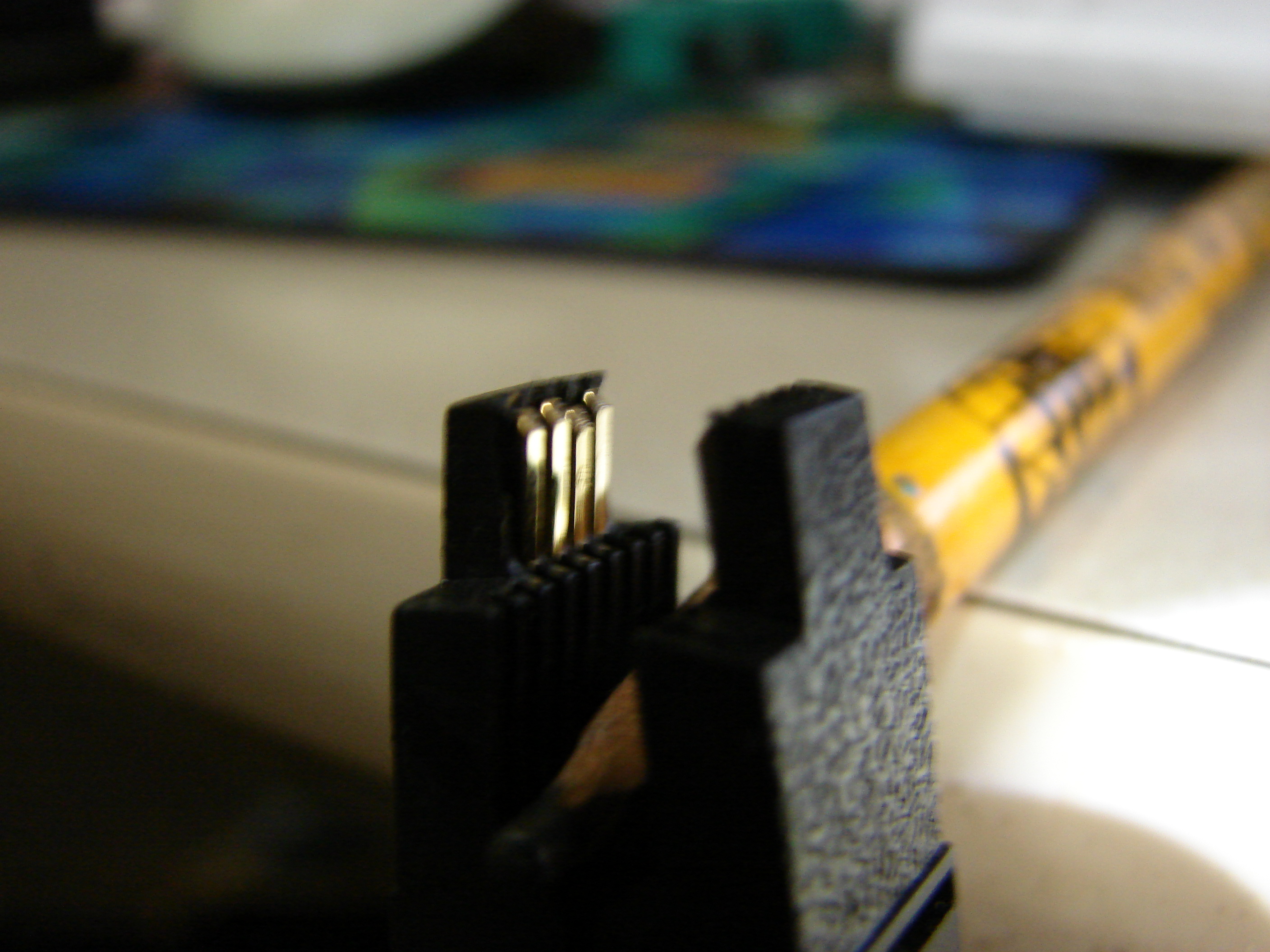

                          • R_J
                            • Jun 2012
                            • 9535
                            Re: DELL E6420 (LA-6591P) U52 U53 Bios Flash with a Raspberry pi B+
                            I ordered a clip from China that did not work, this is what I got, It was replaced with a better one that did work, so check the pins
