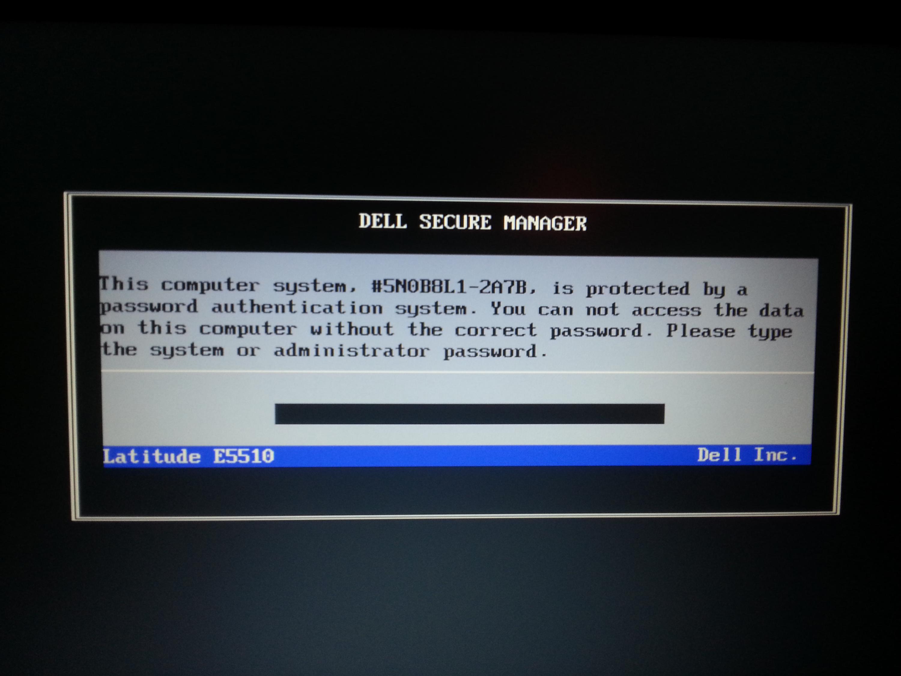

            Please I need help for this machine Dell Latitude E5510 Bios password, I really need help someone please help me.
            Thank You all.

                Can someone help me with this Dell Latitude E5510 because i have try I9HjBCEanhuvGAtn but still is not working I dont know why. please help i cant even sleep!!!

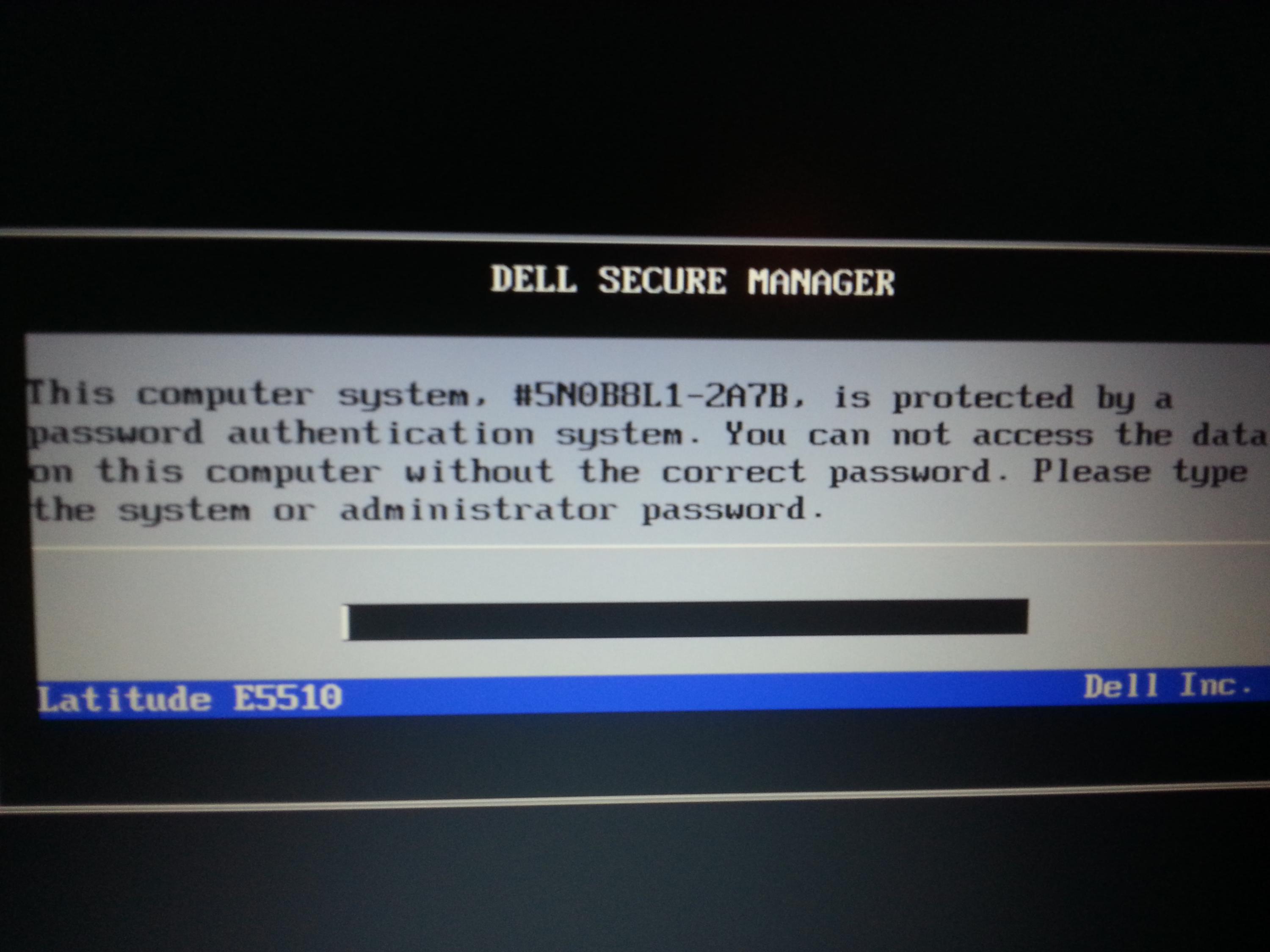

                  Re: DELL Bios Password
                  when I enter the service tag in the picture, (5N0B8L1-2A7B) into the generator,
                  I get, vhM4gyMN1K2DGsRC
                  am I missing something here?
                      Yes Oooh Boss is still not working i dont know why this is happen....so if there is another backdoor?
                      couple of things to go over
                      passwords are case sensitive, so must be entered as seen
                      they are for a Qwerty keyboard US, UK etc
                      after you enter password press enter, but some laptops require you to hold down control button then press enter, and some require you to hold down control and press enter twice
                      hope it helps, good luck
                        Wowwwww trebo You are awsome and I have given all folks on this site the credit for this.
                        I really like and love this site*badcaps.net* Thank You Thank You!!!!!
                        It is Done###
