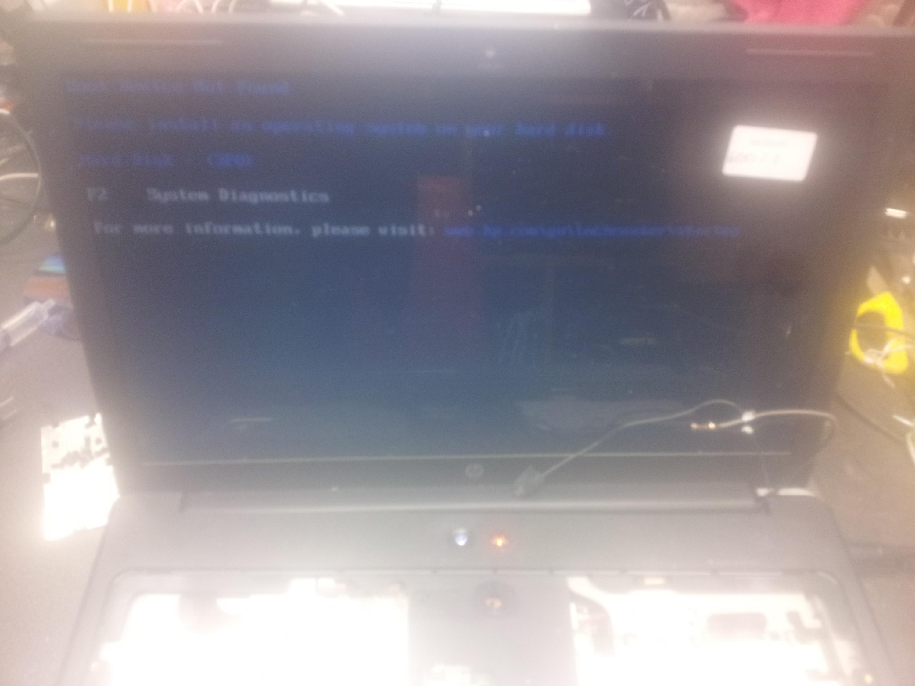

    i need flash dump or rom file for hp g61sa flash Cfeon

    I found in hp site bios update for win 64. when i extract the exe file in a folder i see a file with extension fd (3069F11.fd) and sized 1024 KO. i want to know it'is my full flash and how to change it to rom or bin because my programmer don't know this extension.

      ref moth : DA00P6MB6D0
      PCB 0P6 MB
      REV
      FLASH :cfeon

        Just load the FD file that is your dump you need.

            100% working dump..

              Ty sir
              After flash it blink 3 time .
              New ram and now up and running
