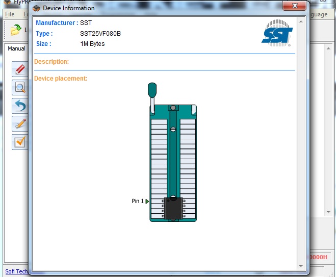

    Hello!
    Started to try a few bios programming, and I tried it in a chip that I had allready dessoldered and all the operations went well , no errors.
    Now that I've tried to program one directly in PCB with help of a SOIC8 clip, I get this error :
    Online Mode
    Programmer Model: SP8-A
    Series Number: 14053130
    Device Type: SST SST25VF080B [SOIC8]
    Pin contact check pass
    Device ID is correct
    Reading...
    Read Completed
    Elapsed Time: 1.5S
    Save File: C:\Users\ZeZ\Desktop\sera.bin
    File Format: Binary
    Save file successful
    Load File: C:\Users\ZeZ\Desktop\Insys_BIOS_M876xSU_ROM12_EC16_INFORL_INSYS_NOSLP_AHCI_NDF\root\ROMs\12IN.ROM
    Date modified: 2009-05-22 10:55:18
    File Format: Binary
    File Start Address : 0H
    Buffer Start Address : 0H
    Warning: Some data out of memory size
    Loaded Size : 1MB (1052022 Bytes)
    Load File Successful
    Erasing...
    Erase Completed
    Blank Checking...
    Blank check failed:
    Device Addr : 01 F692H
    Device Data : E0H
    Is this a symptom of a bad bios chip?
    What would be the errors related to a corrupted chip?
    THanks!

    That says that the chip did not erase
    try erase again than check if it blank, Also some times a different device type might help

      this device can't be programmed in place

        Re: Bios Programming Blank check failed
        Thanks for your feedback.
        Gonna dessolder it ,and try it off board.
        BTW, how do I know which chips will allow the reprogram on the board?

          look at page 5 of user guide
          http://www.tek-tronics.co.uk/SP8_Manual_en-1.pdf
