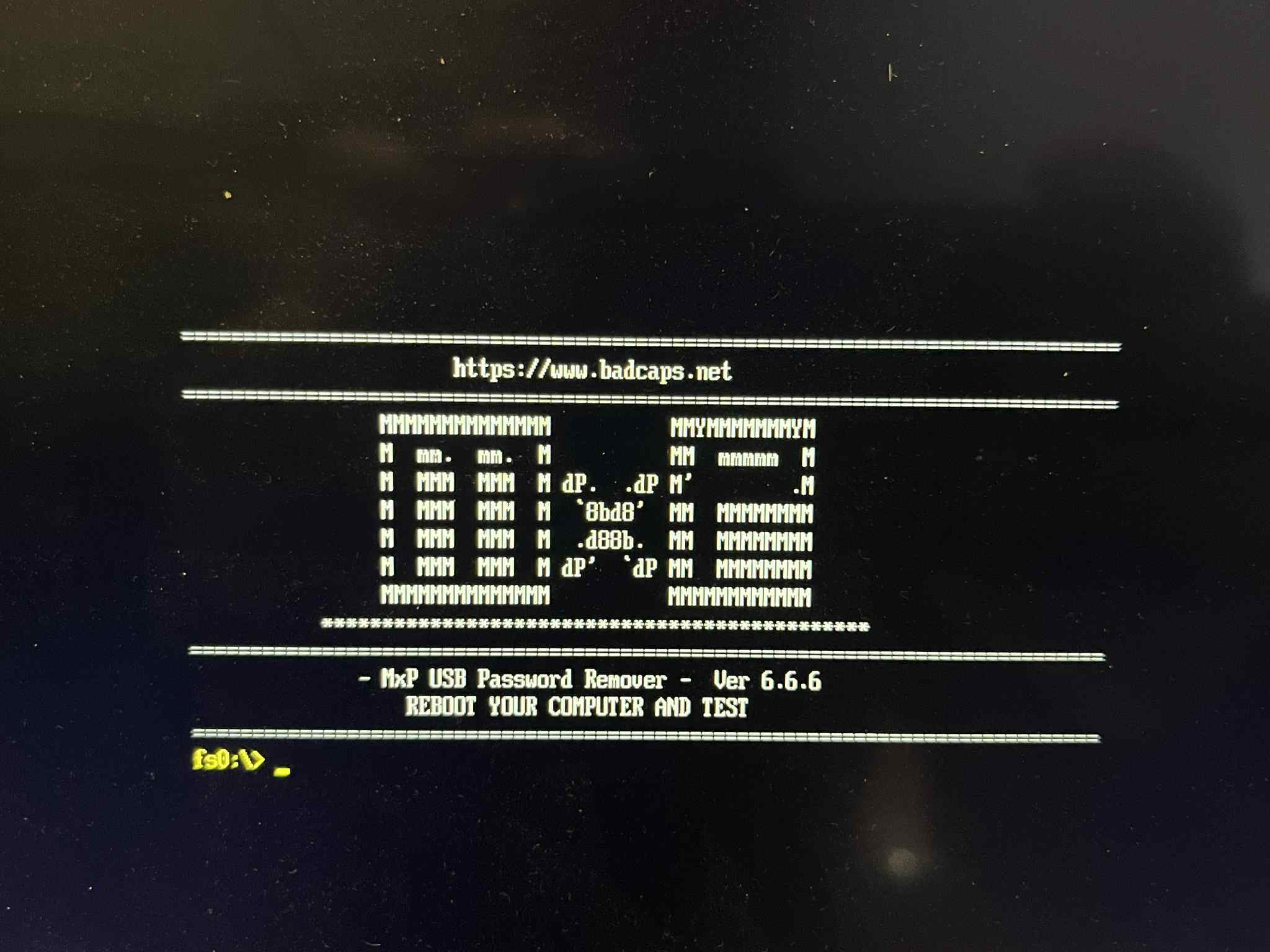

    Try it!
    I tried it on Panasonic and Lenovo Miix.
    It worked.
    https://www.youtube.com/watch?v=ferYtUG7PBw
    https://www.youtube.com/watch?v=x03i_7Ij2rQ&t=3s

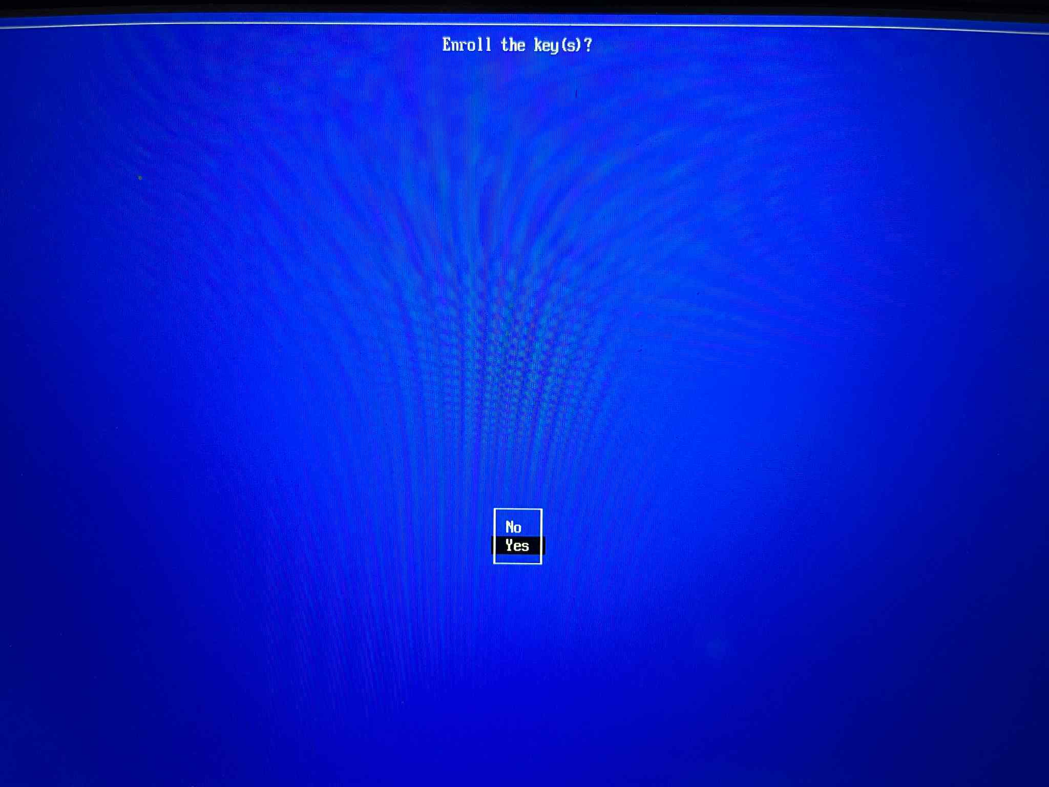

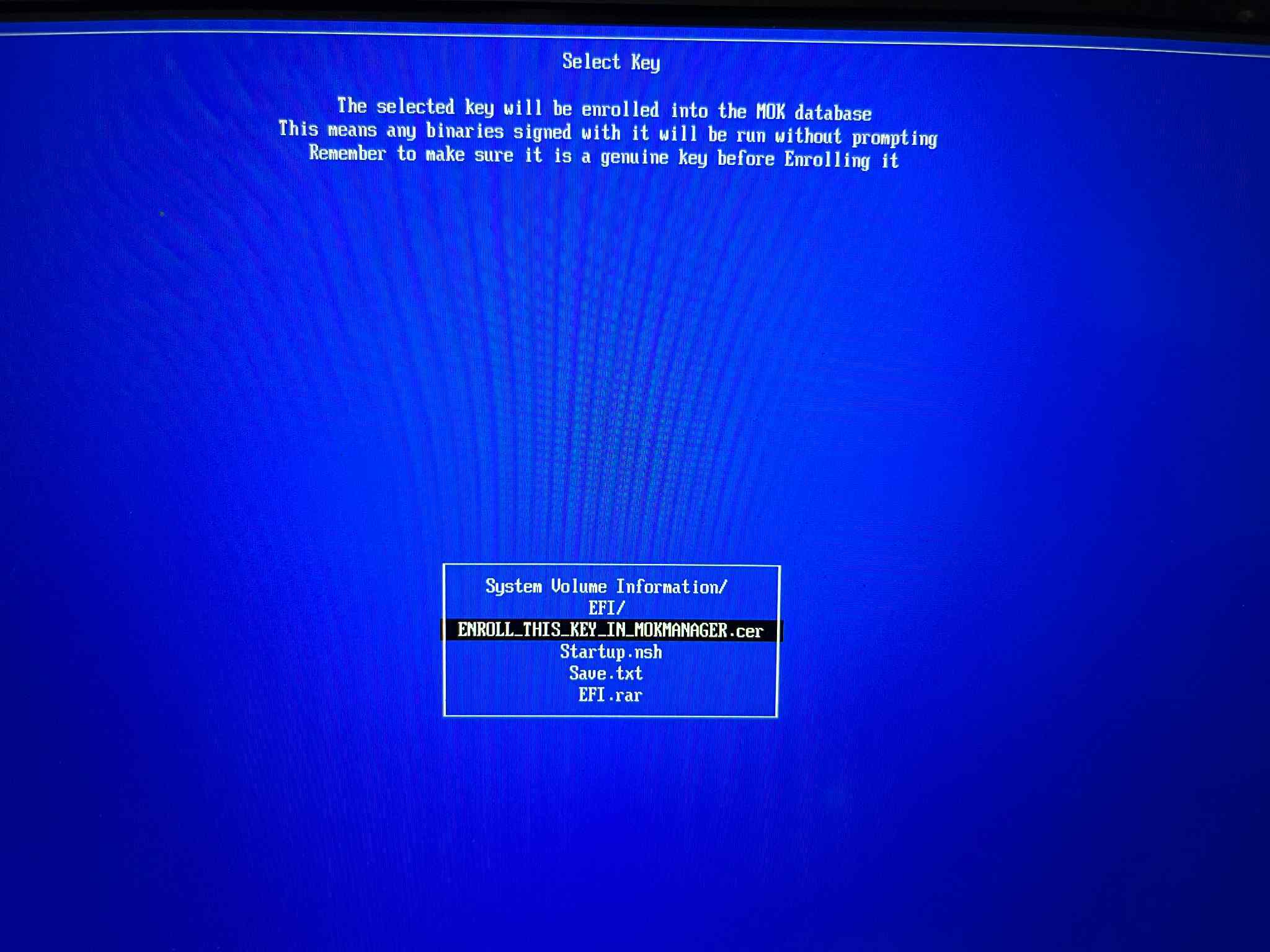

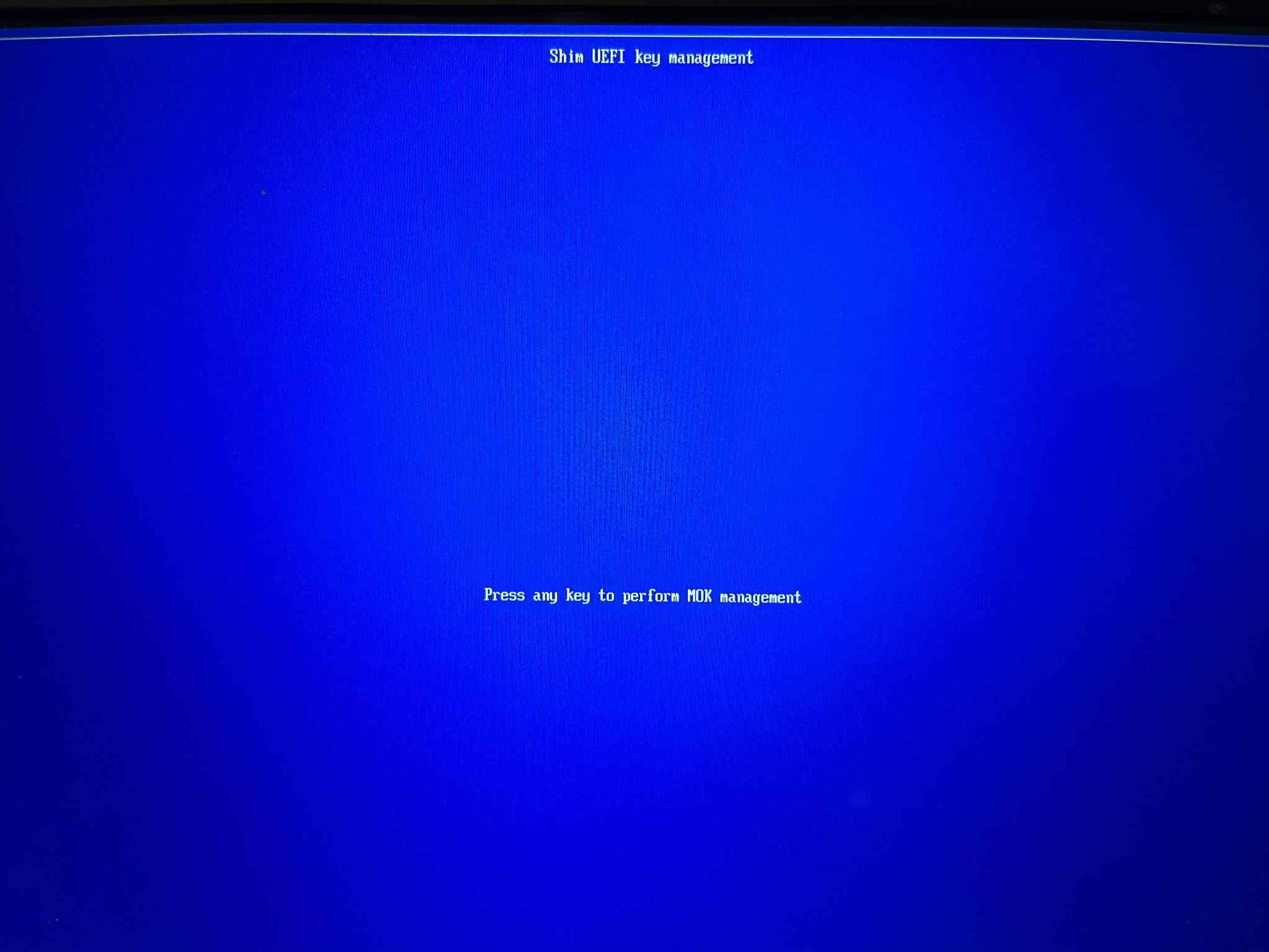

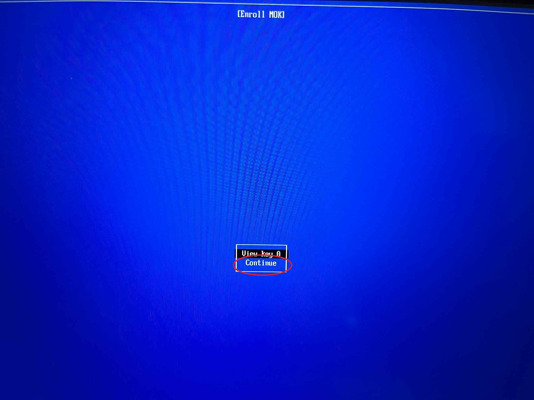

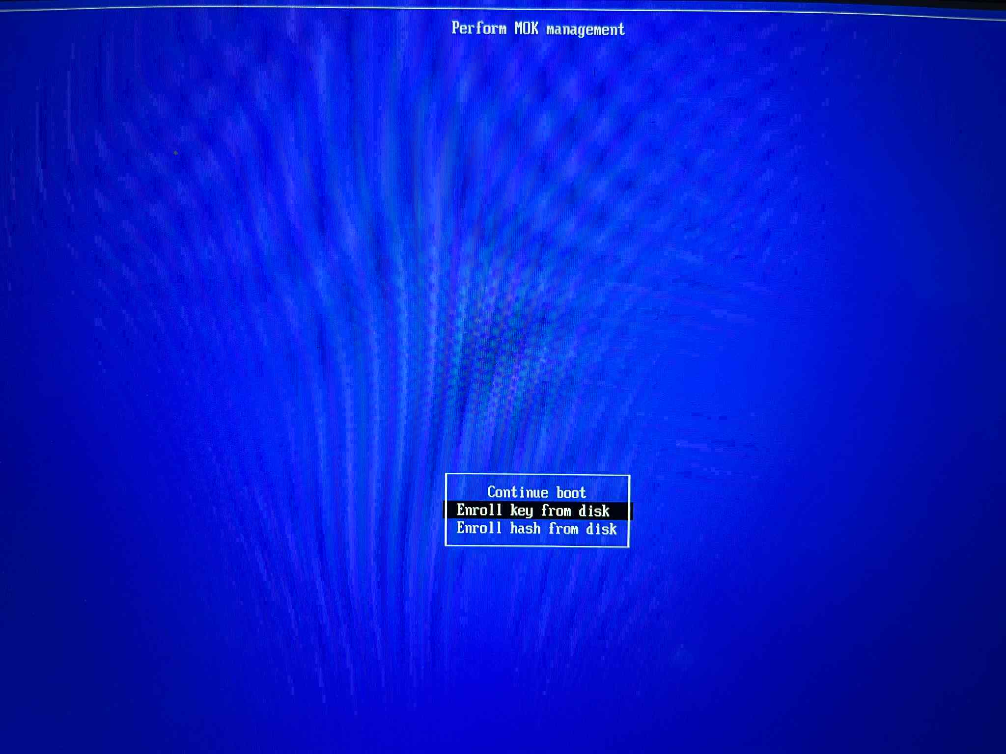

    Create a USB flash drive with the utility and replace all contents with the RAR archive
    Just boot from the stick and wait
    Then reboot and try to enter the BIOS.​
    Do your tests and give your opinion as well as the machine models​
    Getac not tested
    It's probably possible to add other password types.

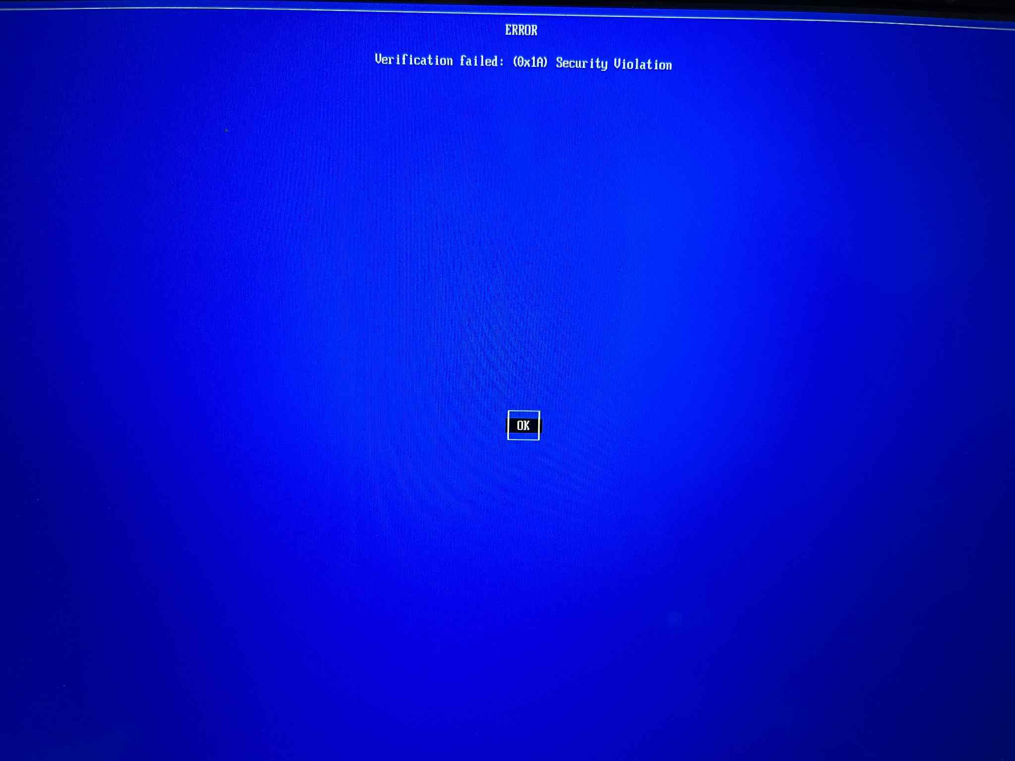

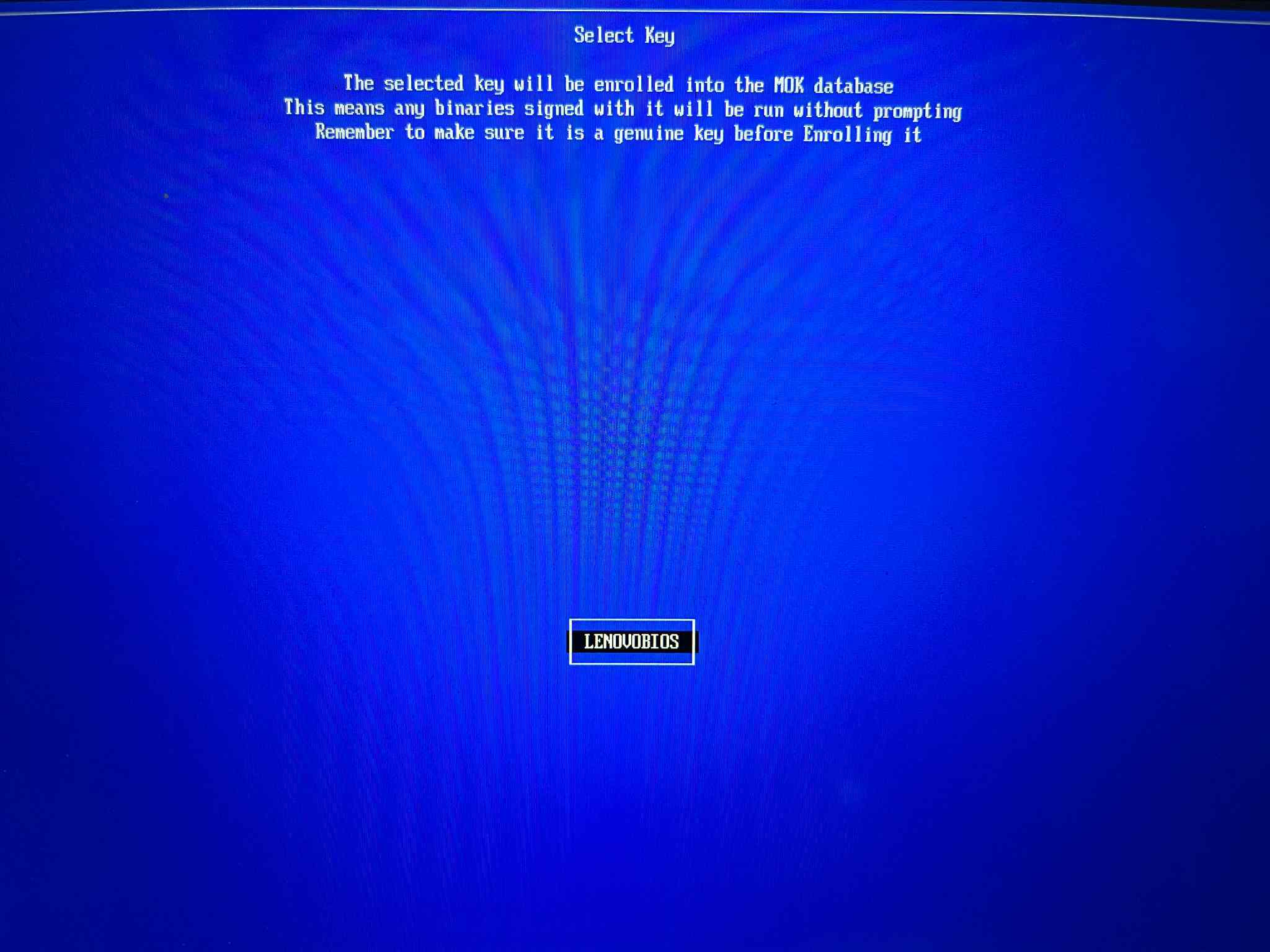

    I tried it on Surface, but unfortunately it didn't work.​
    Support Secure boot
    Need enroll key from disk and retry

        2 Notes
        1) Newer devices block the fedora shim in their dbx now. I use/d it too but now its getting flagged more and more
        2) Here is a loop for searching the device. Shrinks your code:
        Code:
        for %a run (0 6 1)
          # echo Checking FS%a:
            if exist fs%a:\startup.nsh then
            GOTO StartUpFound
            endif
        endfor
        :StartUpFound
        #echo Found UFD at FS%a:

          Originally posted by Pferd5
          2 Notes
          [/CODE]
          Yes, it doesn't work on modern machines.(also 32bit machines don't work either because I only used bootx64)
          And my code is pretty bad.
          I'm sharing this idea to improve it.
          If you have any knowledge that could improve the software, please feel free to make changes.
          I don't understand Linux.
          I'm gathering my ideas with what I find. I'm already happy that it works on some machines.
          This solution may seem absurd to some, because it's already known.
          Thank you for your advice and your messages.
          But I'm not at your level, so it's difficult to follow your instructions.
