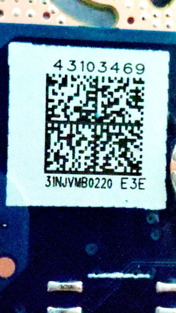

    Hello, forum members. I accidentally flashed the previous BIOS version, and now my BIOS is corrupted. After flashing, just black screen.
    Perhaps someone can help me and provide a BIOS dump.
    Model: Asus ProArt P16 H7606WV
    Board revision: DA0NJVMBBE0 REV:E
    Thank you!

    Post the laptop serial number
    post the contents of the bios chip even if it is corrupted..
    read the forum rules..https://www.badcaps.net/forum/troubl...before-posting
    Also, scan the white QR code on the motherboard and post what it saysor post a good clear picture of it.

      Asus ProArt P16
      SN: S7N0CX11N77531E
      Info for QR: QCCNJV22E43103469,S731NBCX00JAW6MB,H7606WV,60NB1410-MB5010,210

        And I'm attaching QR code.

          Try, BIOS extracted from ASUS website, DMI inserted
          H7606WV
          S/N S7N0CX11N77531E
          BIOS ver. 319
          DMI 1BB0000h-1BBFFFFh

            Great, everything works.
