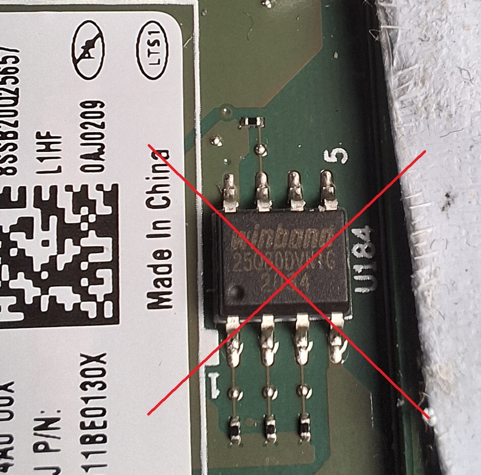

    Click image for larger version  Name:	20250621_105925.jpg Views:	0 Size:	218.8 KB ID:	3726527Hi there,
    As title says, i need to get rid of supervisor password, at bios enter if i let blank, it goes into bios but limited settings can be aplied.
    X1 Carbon gen 8th : 20U9 - 0084MH
    I opened and i think i found the bios chip somewhere near ssd m2.
    Now i have some electronic skills and i have CH341A programmer with an additional 1.8v converter for those chips, but i am not sure if this chip is 1.8v or 3.3v.
    I have read some topics and i saw there is a method to short some pins to get rid of that supervisor password, but i could not find relevant method for x1 carbon 8th gen.
    Can you lead me? How to do it properly?

    This isn't bios chip.

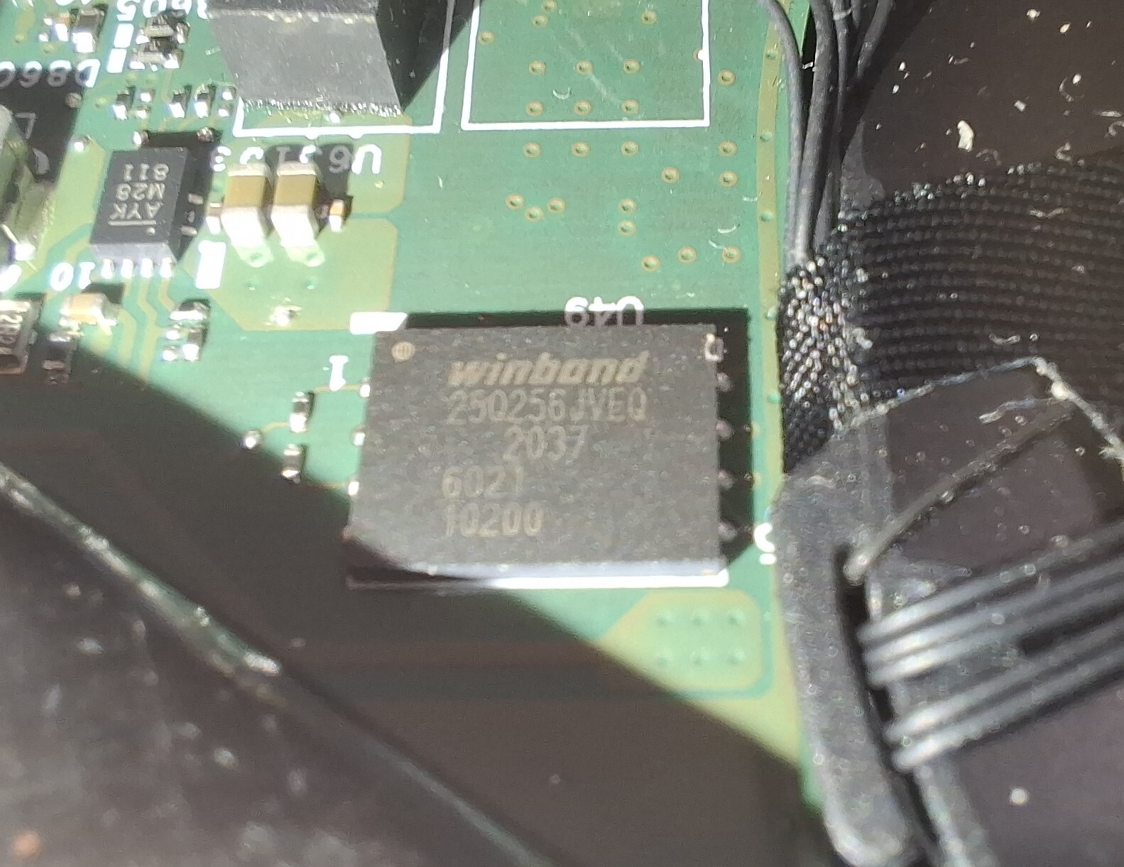

      Hmm, then what are my options, i cannot find any bios chip on laptop.
        SMDFlea commented
        Editing a comment
        That is the bios chip
    • flaviustech
      • Jun 2025
      • 7
      • Romania
      How can i resoft it? I detached from motherboard and put on cha341a mini programmer, i readed chip, i saved original bios. But i do not know which one to download? Is that autopatcher utility good? I use that to patch my original bios?
      • rumpumpel1
        • Jul 2019
        • 165
        • germany
        The password is stored in the EC. See here for a description how to delete it: https://www.badcaps.net/forum/troubl...ssword-removal
