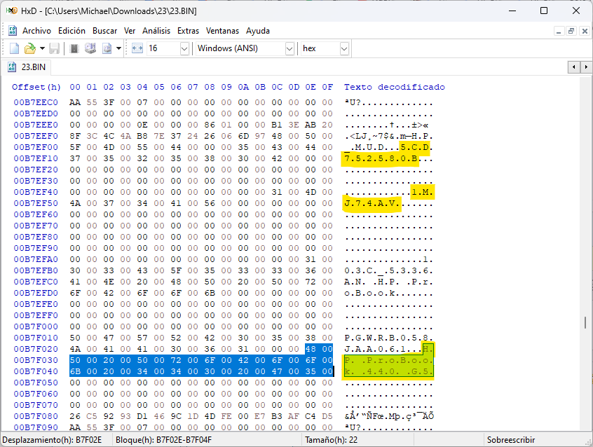

    hi
    I have this file (backup) here .. and I figured out the laptop model exactly from the sticker.
    But is it possible to determine the model exactly just by using a BIOS backup?
    I tried, but I can't do it with this one.

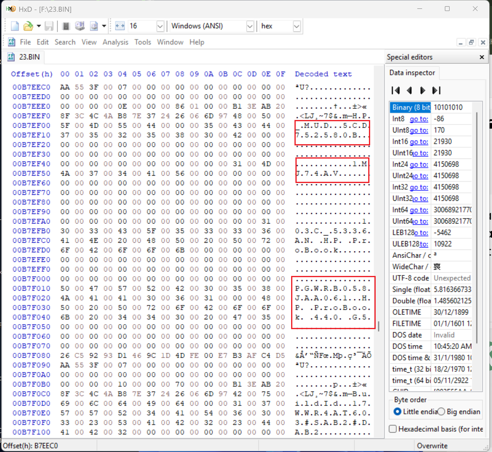

    Originally posted by khalillll
    hi
    I have this file (backup) .. and I figured out the laptop model exactly from the sticker.
    HP ProBook 440 G5
    Serial_5CD752580B
    Product_1MJ74AV
