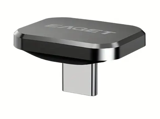

      Sorry, not for spamming but to help others who are too dumb to really solve 2203:
      The solution above together with this USB-C drive i managed to shop in town is great:
      Click image for larger version  Name:	usbcmem.png Views:	0 Size:	70.4 KB ID:	3691343
      It sits at the back of my P15 G1 and is very subtle.
      also i discovered Automute to auto mute my Thinkpad on every reboot or shutdown, so i never hear that nasty beep again:
      Auto Mute for Windows - Free download and software reviews - CNET Download
      These things together create a "i nearly solved it".
      For me that not only means less annoyance but i can also again use WOL!
      So: STILL appreciated if you pro guys can lead me to the real solution.
