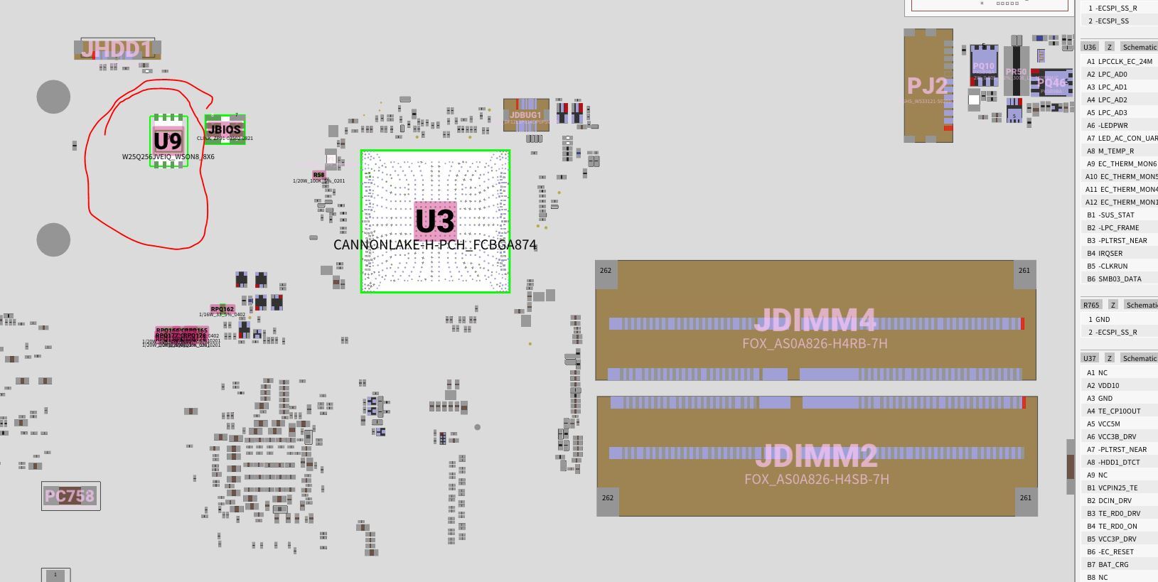

                                You give up too easy it`s gotta be there, somewhere. What`s the motherboard model number, there might be a boardview that will help locate it. Have you peeled back the black plastic sheets and looked underneath
                                • tuxstevo
                                  • Oct 2024
                                  • 14
                                  Hi
                                  Yes I’ve looked under all the plastic. The number on the board is FP530 NM-C262 Rev 1.0.
                                  Thanks,
                                    • 22109
                                    Originally posted by tuxstevo
                                    Hi
                                    Thanks,

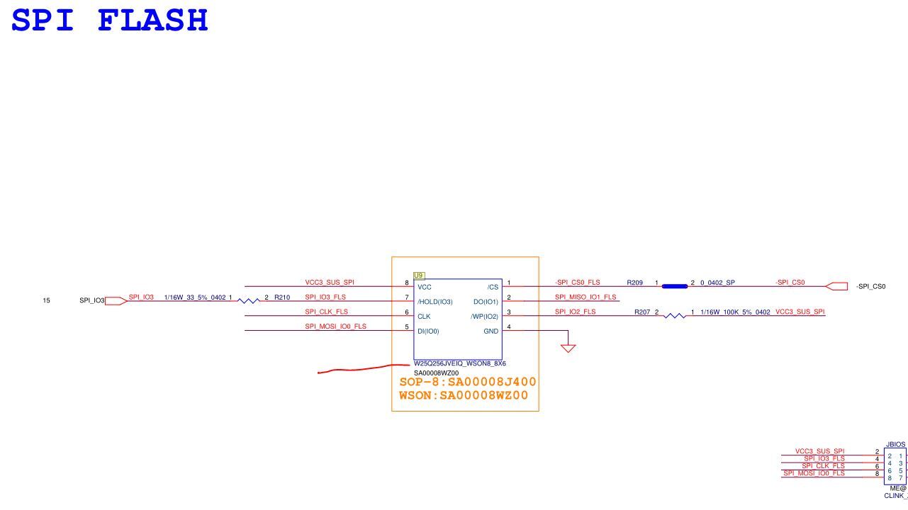

                                    The chip is at U9 in the boardview/schematic. It`s a WSON8 type chip, if you only have a SOP8 clip it will not fit. You will have to desolder it and put it in or on a WSON adapter board, use a WSON pogo adapter (less reliable) ,or solder wires between the programmer and exposed pads - traces - caps - resistors
                                    • tuxstevo
                                      • Oct 2024
                                      • 14
                                      That’s great - thanks. I would never have guessed it was that one. I’ll have a go at reading it and come back, although it might take me a couple of days as I don’t think any of the clips I have will fit.
