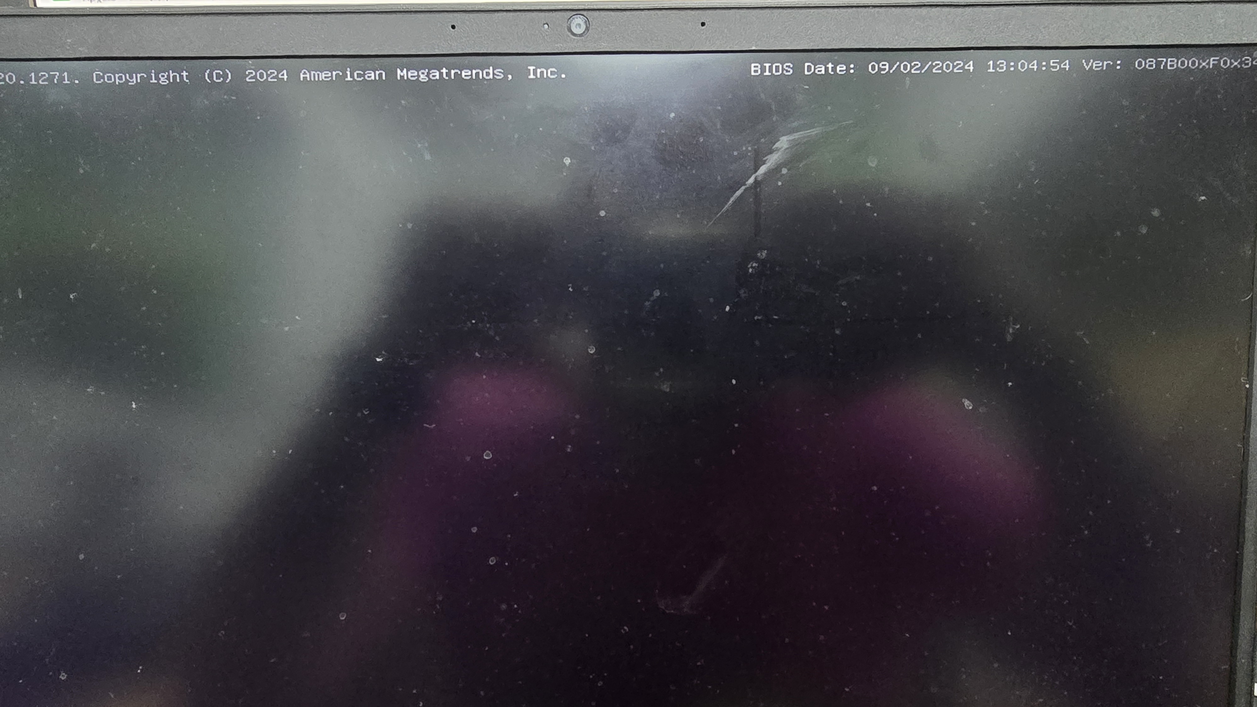

    Hello, Laptop froze and got stuck in a prepost situation. It cannot be updated through a USB flash although it gets the signal to try to update bios through USB.
    I ve read the Original Bios and I post it here. Bios chip seems ok.
    I also post the screen opening if anyone has seen something like that.
    There is a thread about Pavilion 15-EC20XXXX but with different mobo and Ryzen 5th instead of Ryzen 4th, I dont think I should try on this.​

          Thank you hoaca388 laptop recovered, the bios is working, although it left a message for manufacturer unlock mode that I cannot remove.

              Well yes the laptop boots normally after some kind of 5 seconds. I am just worried if it performs as if it was in normal bios mode or if the bios is easier to become corrupt again.

                Missing "MPMLock" at 0x7000, try this one, just in case I copied from 0x6E40-0x700F from your original BIOS to the bios posted by hoaca388
                This should clear the "Manufacturing Programming Mode"
                "Unlock" means you can edit the S/N, etc. with HP BCU, once its "Lock" that info cannot be changed with BCU
