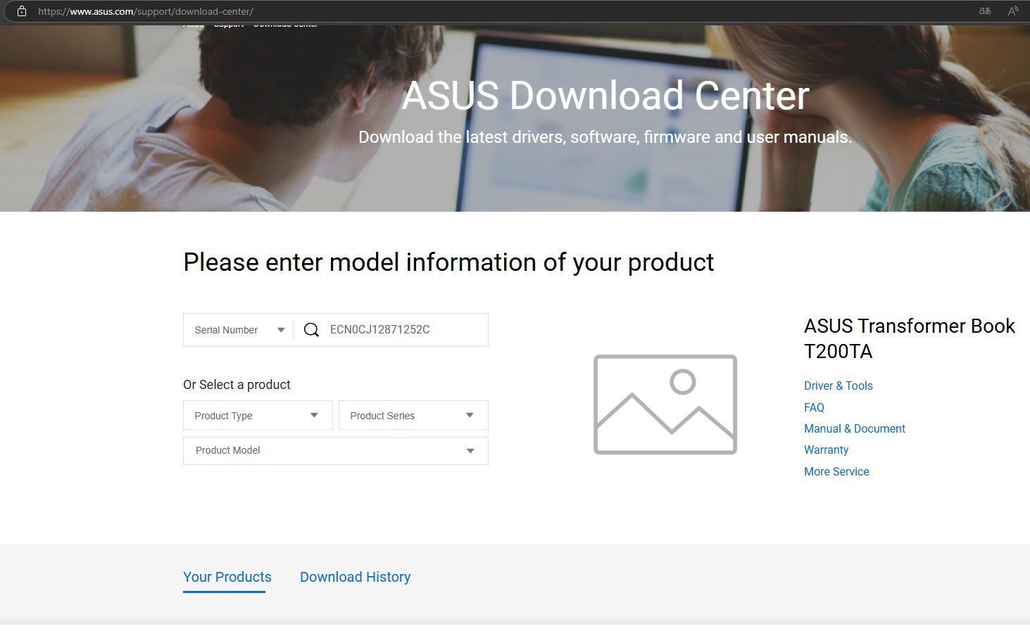

    Do you have the serial number, can't find the model with the information you gave.

        PS:
        lock for Serialnumber please in picture Attachment
