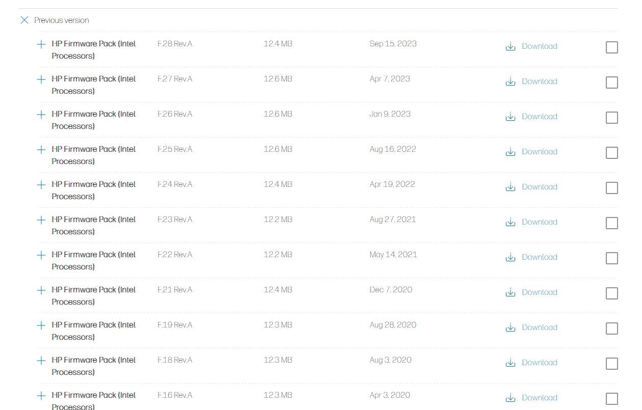

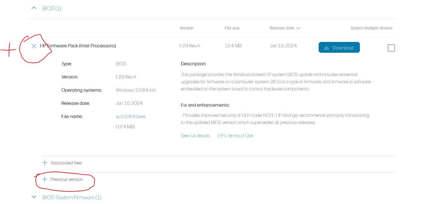

                !BUMP someone have another file to test guys?
                  • 22093
                  Try some older bios versions, there`s around 15 at HP support. Download and run the exe, choose to save to a location.
                  • DavidJocic
                    • Apr 2025
                    • 10
                    • france
                    SMDFlea Thanks for your answer I have checked any component in PC is damaged. Everything is okey, only one problem is that on HP drivers website I can find only one for my model the last one. Second thing is that I hear when we download bios from HP we can't put it with ch341 directly on chip cause there is not all information about PC and there is thing that is not ready. I don't know if is true. But only thing that I know since I deleted chip any bios won't turn the PC. I just want give some try more before the PC is thrown. Thanks again, I even did checksum verification after programming bios from other member but still on red light no fans anything
                      • 22093
                      Bios F28 + DMI.
