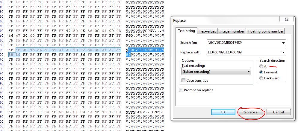

      Im doing it with ch341a(i know), but i modified it couse was error on 25Q winbound chips. Bios is not empty (at third time it read succesfully). Inside this bios is clean bios from Asus page under my model. Bios was cut 800 on begining. I have one bios from internet but little diffrent device and number on winbound ic little diffrent. Im trying to cut and paste only serial number in it which is on laptop cover. But there is more than fifty places with serial number. Maybe this will work?
        • 21038
        You can replace all at once. In the picture is HxD search-replace

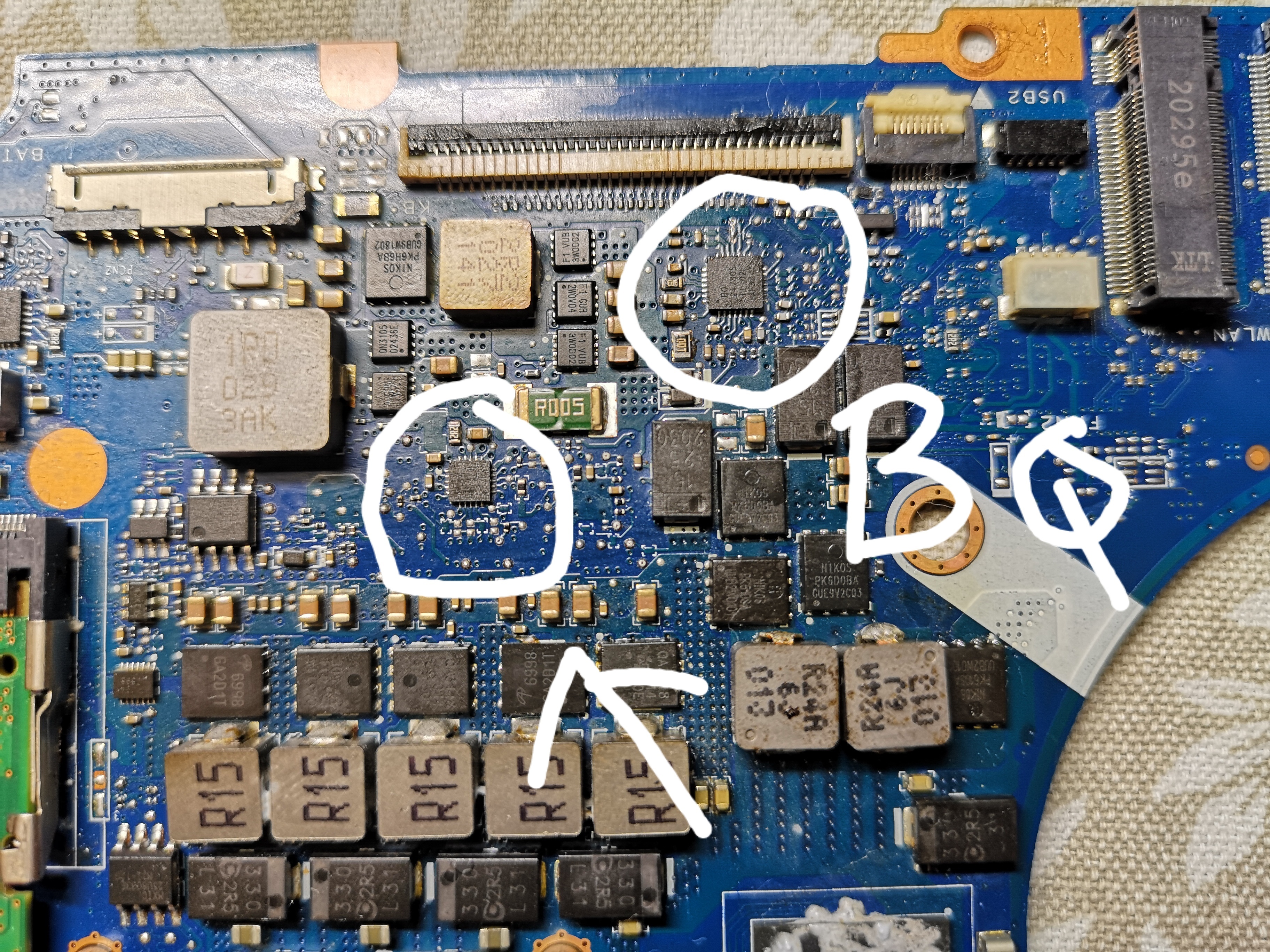

              Hi, can somebody help me I have an Asus Tuf laptop that lights the keyboard and charges battery but won't send image to display or do something, I believe is the BIOS file that is corrupted, but don't know how to repair it.
              Model: FA506IU-HN243T
              S/N: L4NRCX00060414G
              Motherboard: DABKXBMBAD0 rev. D
              Bios chip ic: 25LQ128DSIG

                  • greg1985
                    • Oct 2023
                    • 14
                    • Polska
                    Originally posted by huichoger
                    Hi, thanks a lot but it didn't work, any ideas? maybe a clean bios will work?
                    Hi i had rhe same case. On left side by bq ic there is a small ic (dont know what part it is now, it was few weeks ago) and it was slightly water damaged. Cleaning water damage done the job. Laptop is working now. Try to measure some voltages around and check ic data sheet, maybe you need to remove this ic and place new one. On picture this ic is marked. Sry for my English Im from Poland.
                        Thanks I'll check, I quickly inspected the whole board under microscope and everything seems normal, also power consumption seems fine but will double check that IC or see if I have a replacement
