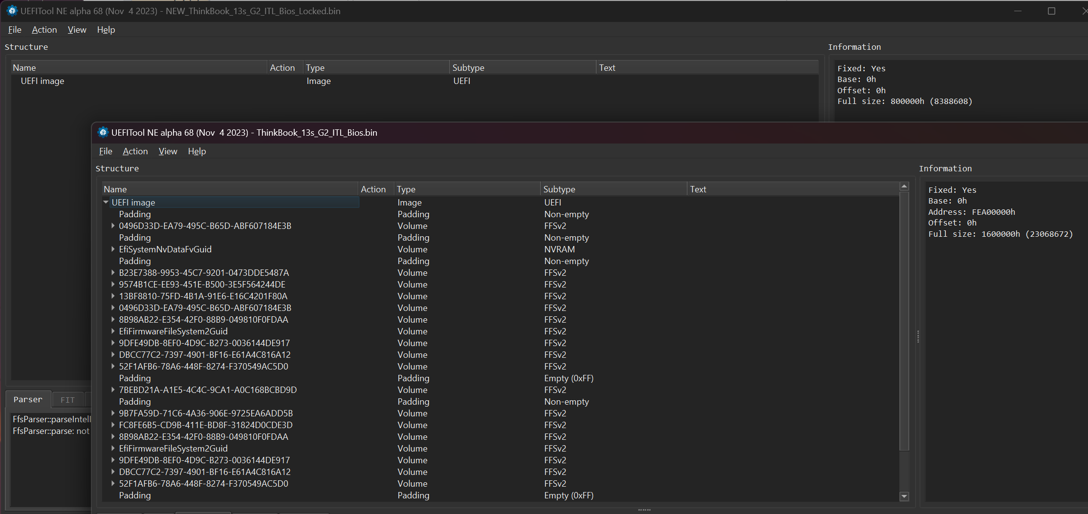

        Hi, I tested the above but SctWinFlash64 didn't like it. I opened the bin you posted with a hex editor and can't find my serial in it? Was it generated from my dump and which tool did you use? Thanks!
        hardware1 Looks like you've done this laptop model before, any advice?

          It is 22mb. It should be 8mb or 16mb or 32mb ....​
          post the original bios of the laptop even if it is corrupted

                you have to read full content of bios chipset with a programmer. You only have bios region extracted with some bios backup tool.

                      retry with SctWinFlash64
                      Originally posted by DigitalDrifta
                      After great difficulty I've managed to get a dump via CH431A and a PCBite!
                      bad file

                        What about the most recent post with the NEW dump? That bad as well?

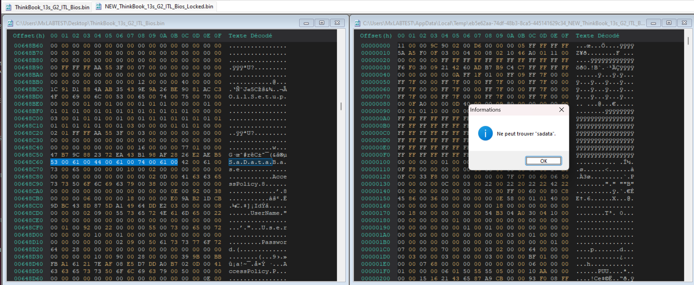

                                Third time is the lucky charm hopefully. Dump with NeoProgrammer... Thanks!
                                  try

                                      That worked! Thank you so much Maxpower3! You\re amazing 🤯
                                      In my hopes to continue learning, could you please teach a man to fish explain how you got to that offset or point me to a guide that explains this magic 😂

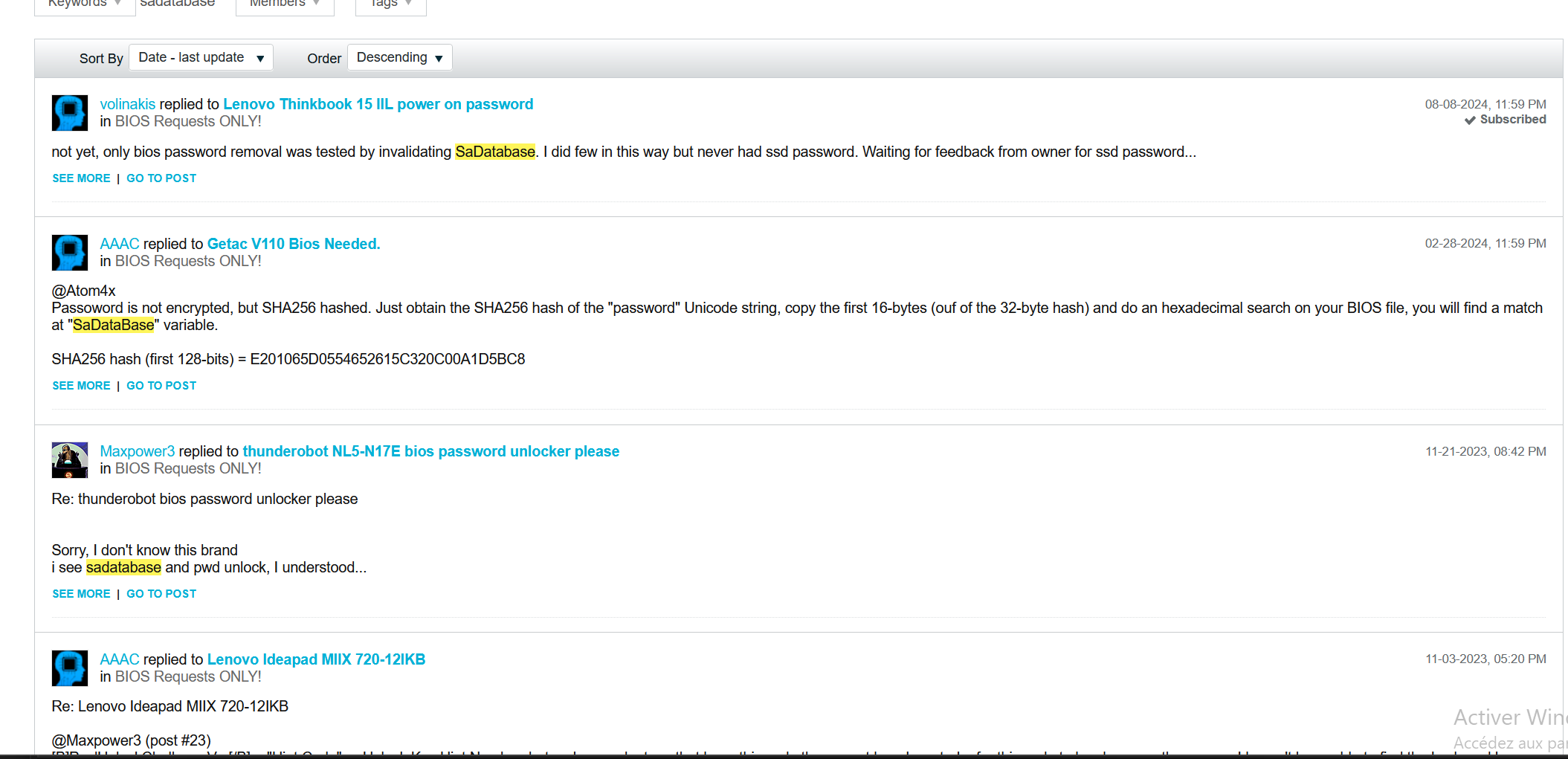

                                        Click image for larger version  Name:	image.png Views:	0 Size:	190.7 KB ID:	3594238

                                          Thanks, read through all those posts, and if my understanding is correct the solution is to invalidate the SaDatabase variable? Does changing the length of the stored password from 3F (63) to 3C (60) do that?
