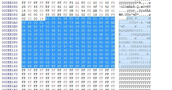

    Hi folks,I have problems unzipping the file I downloaded to repair the BIOS of this notebook just nothing appears when I open only one file with 571kb 7zip or winrar
    leave you the original file and the one I managed to download from the internet, the equipment turns on randomly does not recognize the NVMe and when I bot with a pendrive after 4s the installer load is crossed
    model NP850XBC-XG1BR
    sn: 096Q9QANA00250B
    I hope you can help me solve this dilemma

    You can extract the update with find_gz software https://www.badcaps.net/forum/troubl...update?t=88206

        [850XBC] Odyssey2-15 BIOS/MICOM (P08AHL)
        NP850XBC-EXP, NT850XBC-CSM

          with this one here he does not generate any kind of image, In the same way I thank you for your intention to help you are welcome

            thanks noname2024 I have no problems when it comes to editing, but just in case you know the address of the DMI
              Hex search: 01 00 00 00 00 00 00 00 01 00 00 00 00 00 00 00 1D 00 00 00
              Text search: BSA_

                Happy week to all, I am pleased to announce that this computer was successfully repaired thanks to the collaboration of SMDFlea and noname2024 my best thanks
