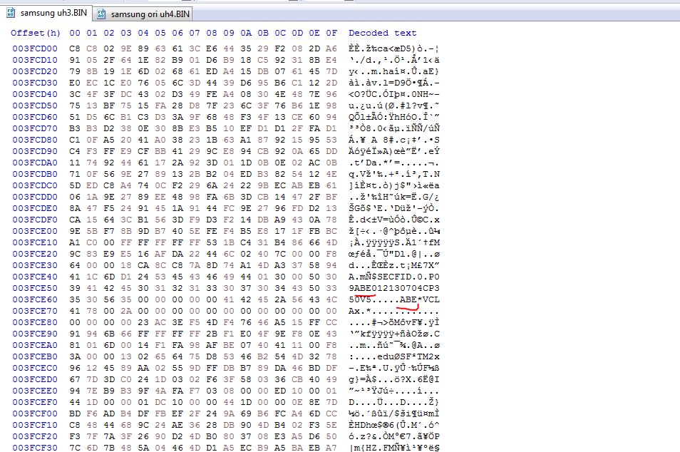

    A quick guide how to ID a samsung bios,and download the official update.

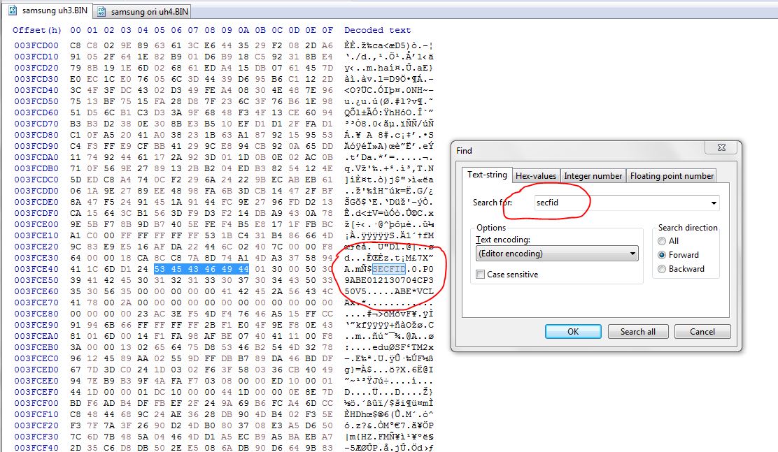

    1. Open your backup with your hex editor of choice and search for the word SECFID ,SEC,SECWUP,$FID or $Revision ,(search with unicode if there are no plain text results) after that is the bios version with platform ID.
    2. After the word SECFID,SEC,SECWUP,$FID or $Revision will be the bios version and platform ID .In the picture you can see P09 (bios version) and ABE (Platform ID) EDIT: The bios version and platform ID can also be found on a sticker on the motherboard,often on the ram slot https://www.badcaps.net/forum/attach...1&d=1414404215 (Credit to dycc )

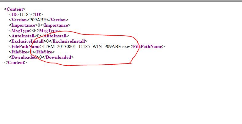

    4. Copy and paste the link into your browser and open the site to reveal an xml file.
    5. Copy the line between <FilePathName> and </FilePathName>.In this guide its: ITEM_20130801_11185_WIN_P09ABE.exe
    6. Edit the line onto the end of the link (see attached text tile),copy and paste the full link into your browser to download the bios:
    http://sbuservice.samsungmobile.com/...IOSUpdateItem/
    http://sbuservice.samsungmobile.com/...WIN_P09ABE.exe
