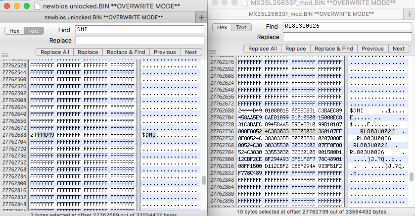

            Originally posted by CraigR
            I decided to take it apart, can;t find a motherboard id but here is the bios.
            here's your unlocked bios

              BIOS_LEGEND take a break and don't waste peoples time with your bios without having even DMI. I'm very curious how you determine "what type of lock tablet has" after a picture ...

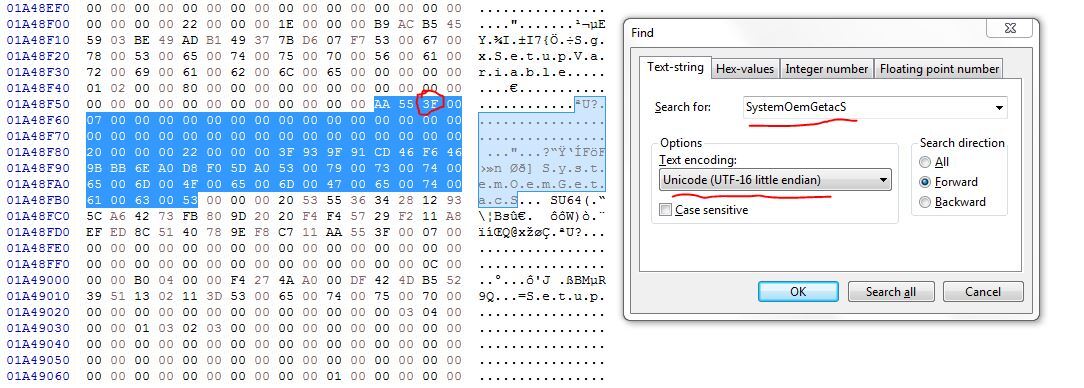

                  unlocking Getacs is quite simple, search for "SystemOemGetacS" and invalidate it. I understand that you have many tablets, so try do it yourself. See photo.

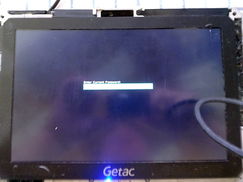

                        Here is what I see when trying to enter the Bios.
                          • 21562

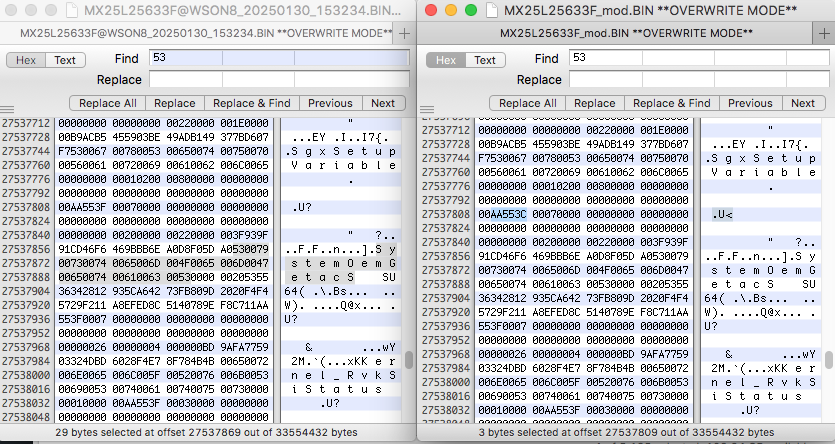

                          With HxD hex editor search for SystemOemGetacS as Unicode. Change the AA 55 3F to AA 55 3C and save, that`s it.
                            Did that but it did not work.
                              hi try and feedback
                              • CraigR
                                • Dec 2013
                                • 965
                                That did work. Did you do anything different than SMDflea said? I swore that I did it exactly like he said.
