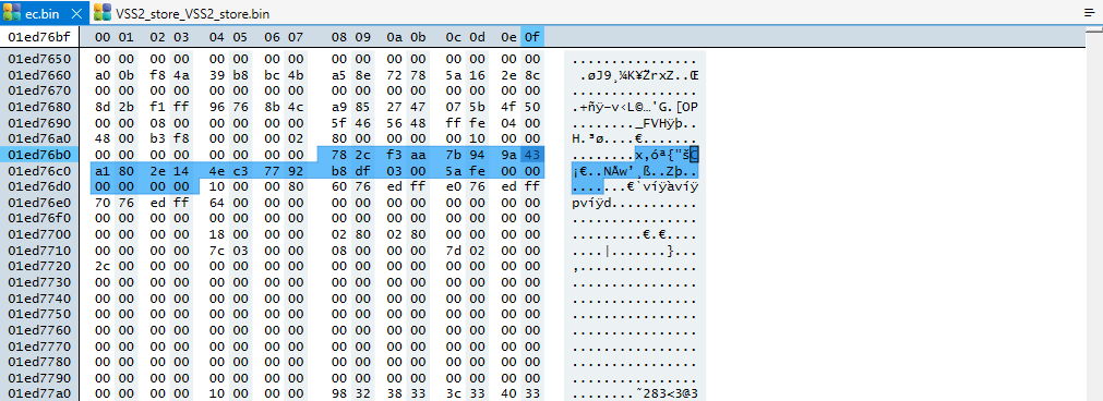

          Tried another way. Basically I've replaced the entire ME Reg part of the BIOS with info from a Firmware recovery file from the HP site. After more than one hour everything was done 👍🏻 Laptop starts and...informed me about the mismatched information and that it's doing a quick recovery ... after two restarts, the password is there of course 😖😖😖 How the h*LL can I stop it from doing this sh*t recovery? I didn't find any cmos battery on this model, the power is out long enough....How does it remember?😢😢😢

                            Hey there. Back from my vacation, armed with a bunch of new BIOS chips 💪🏻 Tried both files first one starts the laptop but the password comes back, second doesn't work at all. Tried the first one only the EC file with a main file that I've done using HP recovery, started but same sh*t happened, some information on the screen telling me that the original BIOS file was recovered from the embedded memory because someone tempered with the BIOS and...the password came back. I don't know...this embedded memory controller is the EC chip or is another chip hiding on the MB? If you want to try tempering some more, my original Main and EC files are on the first post from the second page of this topic. If you can do something with them, please let me know and this weekend or the next I'll try to rewrite the Chips. The newer they are, the shitier they get ...

                                I did try every variants available here. Only one doesn't POST, but those that post are immediately reverted to the locked BIOS. I need to find a third Chip (usually smaller than BIOS and EC chips) that trigger that fu*king recovery. I did found a 1MB Chip that GPT says it might be responsible and patched it for me. Now I have to flash all three chips back and try again. If the recovery is still triggered I just give up...

                                    I'm sorry, I'm done with this laptop. Doesn't matter what dump I flash on those chips, it gets reverted. Now I've patched 3 Chips and still recovered. Where the hell does the BIOS copy stais? I have no idea and to be honest I lost my patience...I have now the clean BIOS main, Clean EC, and clean 1MB that has the HP sure on it. Still my password returned. It's not about the dump you throw on it anymore... it's about finding the chip that keeps a copy of the original BIOS and force it back to the main and EC chips . I'll search for further information in the future . Thanks for all the help I've received here. Take care guys and much success with this laptop!

                                      Here is something interesting:
                                      "Inside the EC’s own MCU flash (again, not in the external EC SPI we patched — lives on the Nuvoton/ITE microcontroller itself).
                                      -than I think I found the responsable chip. NUVOTON NPCX499HA tells you anything ?-
                                      Yes — that’s your Embedded Controller (EC).
                                      The Nuvoton NPCX499HA is a high-end EC MCU HP uses in newer EliteBooks to handle:
                                      • Keyboard, battery, fan control
                                      • Power sequencing
                                      • Firmware verification for HP Sure Start
                                      • Storing/triggering the BIOS recovery payload
                                      Here’s the key point:
                                      • It has its own internal flash (not the external EC SPI chip we patched).
                                      • HP Sure Start Gen5+ can embed a signed golden BIOS image or recovery script inside that internal flash.
                                      • On boot, the NPCX499HA compares the main BIOS SPI against its stored hash/image, and if mismatched, pushes the “golden” image back into the main BIOS.
                                      • This process works even if the EC’s external SPI is wiped — which is exactly what you’re seeing.
                                      Why this matters for you
                                      The only way to stop that recovery from the NPCX499HA is to:
                                      1. Reflash the EC’s internal flash via its programming interface (SWD/JTAG/ICP).
                                      2. Replace the NPCX499HA with a blank or donor chip from a similar board that doesn’t have the Sure Start payload.
                                      3. Disable Sure Start in firmware — but that’s locked behind the same password you’re trying to remove.
                                      Challenges:
                                      • The internal flash is protected; without HP’s signed EC firmware, the chip will reject changes.
                                      • Replacing the chip is possible, but it’s BGA — requires hot-air rework and exact part sourcing.
                                      • Blank EC means you must flash both its firmware and configuration to get keyboard, charging, and power working again."
                                      So...that particular chip lives on the other side of the MB under the keyboard...and here is where I say ENOUGH, HP has taken the security to a level that, for the moment, doesn't alow me to go any further.
                                      If someone want's to dive dipper, be my guest.
