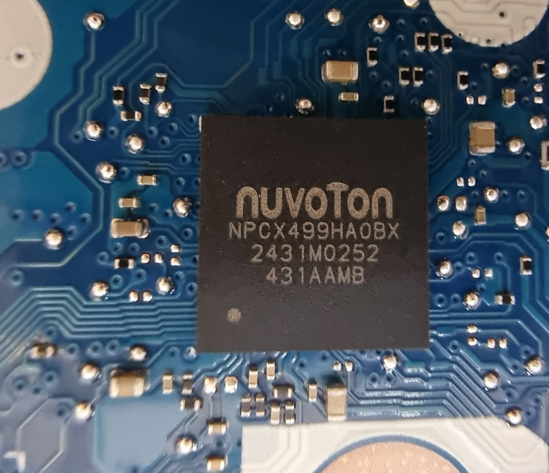

request unlock HP EliteBook 640 G11 password bios
  • danito
    replied
    Originally posted by lavie
    EliteBook 640 G11 please unlock
    SN/ 5CD51776
    processor type ULTRA 7 165U
    sn is wrong
    Leave a comment:
  • lavie
    replied
    EliteBook 640 G11 please unlock
    SN/ 5CD51776
    processor type ULTRA 7 165U
    Leave a comment:
  • quyet306
    replied
    Originally posted by kouider
    i removed the password by downgrading the version this files is working fine with me
    hp elitebook 640 g11 bid=w74
    sn= 5CD50294DR
    processor ultra 5
    hello sir
    i flash this dump, first power on laptop look like working, then it shutdown and no power on again, only blinking charger light
    back to orginal dump but notthing change. any solution sir?
    Leave a comment:
  • kouider
    replied
    i removed the password by downgrading the version this files is working fine with me
    hp elitebook 640 g11 bid=w74
    sn= 5CD50294DR
    processor ultra 5
    Leave a comment:
  • Stefan Steff
    replied
    Originally posted by essaadi
    Helo every body,
    I have tried modded BIOS dump on Elitebook 640 g11... Laptop restart 2 times and password return.
    Thank you for your feedback!
    Leave a comment:
  • essaadi
    replied
    Originally posted by Stefan Steff
    Before you give up ...please try this modded bios dump. Thanks.
    Helo every body,
    I have tried modded BIOS dump on Elitebook 640 g11... Laptop restart 2 times and password return.
    Leave a comment:
  • VirVir
    replied
    Here is something interesting:
    "Inside the EC’s own MCU flash (again, not in the external EC SPI we patched β€” lives on the Nuvoton/ITE microcontroller itself).
    -than I think I found the responsable chip. NUVOTON NPCX499HA tells you anything ?-
    Yes β€” that’s your Embedded Controller (EC).
    The Nuvoton NPCX499HA is a high-end EC MCU HP uses in newer EliteBooks to handle:
    • Keyboard, battery, fan control
    • Power sequencing
    • Firmware verification for HP Sure Start
    • Storing/triggering the BIOS recovery payload
    Here’s the key point:
    • It has its own internal flash (not the external EC SPI chip we patched).
    • HP Sure Start Gen5+ can embed a signed golden BIOS image or recovery script inside that internal flash.
    • On boot, the NPCX499HA compares the main BIOS SPI against its stored hash/image, and if mismatched, pushes the β€œgolden” image back into the main BIOS.
    • This process works even if the EC’s external SPI is wiped β€” which is exactly what you’re seeing.
    Why this matters for you
    The only way to stop that recovery from the NPCX499HA is to:
    1. Reflash the EC’s internal flash via its programming interface (SWD/JTAG/ICP).
    2. Replace the NPCX499HA with a blank or donor chip from a similar board that doesn’t have the Sure Start payload.
    3. Disable Sure Start in firmware β€” but that’s locked behind the same password you’re trying to remove.
    Challenges:
    • The internal flash is protected; without HP’s signed EC firmware, the chip will reject changes.
    • Replacing the chip is possible, but it’s BGA β€” requires hot-air rework and exact part sourcing.
    • Blank EC means you must flash both its firmware and configuration to get keyboard, charging, and power working again."
    So...that particular chip lives on the other side of the MB under the keyboard...and here is where I say ENOUGH, HP has taken the security to a level that, for the moment, doesn't alow me to go any further.
    If someone want's to dive dipper, be my guest.
    Leave a comment:
  • VirVir
    replied
    Originally posted by Stefan Steff
    Before you give up ...please try this modded bios dump. Thanks.
    I'm sorry, I'm done with this laptop. Doesn't matter what dump I flash on those chips, it gets reverted. Now I've patched 3 Chips and still recovered. Where the hell does the BIOS copy stais? I have no idea and to be honest I lost my patience...I have now the clean BIOS main, Clean EC, and clean 1MB that has the HP sure on it. Still my password returned. It's not about the dump you throw on it anymore... it's about finding the chip that keeps a copy of the original BIOS and force it back to the main and EC chips . I'll search for further information in the future . Thanks for all the help I've received here. Take care guys and much success with this laptop!
    Leave a comment:
  • Stefan Steff
    replied
    Originally posted by VirVir
    I did try every variants available here. Only one doesn't POST, but those that post are immediately reverted to the locked BIOS. I need to find a third Chip (usually smaller than BIOS and EC chips) that trigger that fu*king recovery. I did found a 1MB Chip that GPT says it might be responsible and patched it for me. Now I have to flash all three chips back and try again. If the recovery is still triggered I just give up...
    Before you give up ...please try this modded bios dump. Thanks.
    Leave a comment:
  • VirVir
    replied
    Originally posted by Aditya11ttt
    can try post 32 bios once if display or not ?
    I did try every variants available here. Only one doesn't POST, but those that post are immediately reverted to the locked BIOS. I need to find a third Chip (usually smaller than BIOS and EC chips) that trigger that fu*king recovery. I did found a 1MB Chip that GPT says it might be responsible and patched it for me. Now I have to flash all three chips back and try again. If the recovery is still triggered I just give up...
    Leave a comment:
  • Aditya11ttt
    replied
    Originally posted by VirVir
    Hey there. Back from my vacation, armed with a bunch of new BIOS chips πŸ’ͺ🏻 Tried both files first one starts the laptop but the password comes back, second doesn't work at all. Tried the first one only the EC file with a main file that I've done using HP recovery, started but same sh*t happened, some information on the screen telling me that the original BIOS file was recovered from the embedded memory because someone tempered with the BIOS and...the password came back. I don't know...this embedded memory controller is the EC chip or is another chip hiding on the MB? If you want to try tempering some more, my original Main and EC files are on the first post from the second page of this topic. If you can do something with them, please let me know and this weekend or the next I'll try to rewrite the Chips. The newer they are, the shitier they get ...
    can try post 32 bios once if display or not ?
    Leave a comment:
  • VirVir
    replied
    Originally posted by rex98
    can someone test this use the 1st one
    if it doesn't work use the second one.
    you should flash both main and EC
    and let me know if it boots to MPM thanks.
    Hey there. Back from my vacation, armed with a bunch of new BIOS chips πŸ’ͺ🏻 Tried both files first one starts the laptop but the password comes back, second doesn't work at all. Tried the first one only the EC file with a main file that I've done using HP recovery, started but same sh*t happened, some information on the screen telling me that the original BIOS file was recovered from the embedded memory because someone tempered with the BIOS and...the password came back. I don't know...this embedded memory controller is the EC chip or is another chip hiding on the MB? If you want to try tempering some more, my original Main and EC files are on the first post from the second page of this topic. If you can do something with them, please let me know and this weekend or the next I'll try to rewrite the Chips. The newer they are, the shitier they get ...
    Leave a comment:
  • Aditya11ttt
    replied
    try and feed back !!
    Originally posted by black0hackers
    I HAVE TEST 2 FILE. 1ST WORK BUT NOT BOOT TO MPM, STILL HAVE PASSWORD, 2ND DONT WORK
    i have one 640 g11 bios pass
    SN: 1H850824LY
    PROD ID: A58TVUC#ABA
    Leave a comment:
  • black0hackers
    replied
    Originally posted by rex98
    can someone test this use the 1st one
    if it doesn't work use the second one.
    you should flash both main and EC
    and let me know if it boots to MPM thanks.
    I HAVE TEST 2 FILE. 1ST WORK BUT NOT BOOT TO MPM, STILL HAVE PASSWORD, 2ND DONT WORK
    i have one 640 g11 bios pass
    SN: 1H850824LY
    PROD ID: A58TVUC#ABA
    Leave a comment:
  • rex98
    replied
    Originally posted by VirVir
    You mean, that part should be replaced with FF or 00? For the moment I've gave up, due to lack of time and, after writing and rewriting the BIOS chip 4-5 times...it said enough and burned... I'm waiting for an order of 10 chips from AliExpress but it will take some time. Keep it touch πŸ€˜πŸ»πŸ––πŸ»
    you should not remove the chip if just testing, just put jumper wire and use ISP in rf809f or h.
    Leave a comment:
  • VirVir
    replied
    Originally posted by rex98
    i know there's always a way. we haven't tried it yet. every security there's always a loophole. like this in g11 EC its very similar VSSTORE in bios main i haven't tried this yet, if i only have G11 laptop here i would try all possible means.
    You mean, that part should be replaced with FF or 00? For the moment I've gave up, due to lack of time and, after writing and rewriting the BIOS chip 4-5 times...it said enough and burned... I'm waiting for an order of 10 chips from AliExpress but it will take some time. Keep it touch πŸ€˜πŸ»πŸ––πŸ»
    Leave a comment:
  • rex98
    replied
    Originally posted by VirVir
    Hello guys! Found some troubling info about the HP security from 2024 onward:
    HP Endpoint Security Controller 2024
    Attacks against PC firmware are on the rise. Unfortunately, protecting the PC BIOS and other critical firmware is often not seen as a priority. HP addresses this with our Endpoint Security Controller (ESC), a dedicated chip that validates the integrity of the BIOS and other firmware to enhance the security of every HP business-class PC. The ESC validates that the firmware is not infected by malware before the CPU is allowed to boot. If any corruption has been detected, it will restore a clean copy held in the ESC's isolated flash. HP is the only vendor offering this unique security solution as a standard part built into business-class PCs to safeguard our customers against IT security threats.
    Bottom line is...no matter if you can "unlock" the main BIOS as long as the ESC provide a backup and restore the old blocked BIOS before you can access it...
    i know there's always a way. we haven't tried it yet. every security there's always a loophole. like this in g11 EC its very similar VSSTORE in bios main i haven't tried this yet, if i only have G11 laptop here i would try all possible means.
    Leave a comment:
  • VirVir
    replied
    Hello guys! Found some troubling info about the HP security from 2024 onward:
    HP Endpoint Security Controller 2024
    Attacks against PC firmware are on the rise. Unfortunately, protecting the PC BIOS and other critical firmware is often not seen as a priority. HP addresses this with our Endpoint Security Controller (ESC), a dedicated chip that validates the integrity of the BIOS and other firmware to enhance the security of every HP business-class PC. The ESC validates that the firmware is not infected by malware before the CPU is allowed to boot. If any corruption has been detected, it will restore a clean copy held in the ESC's isolated flash. HP is the only vendor offering this unique security solution as a standard part built into business-class PCs to safeguard our customers against IT security threats.
    Bottom line is...no matter if you can "unlock" the main BIOS as long as the ESC provide a backup and restore the old blocked BIOS before you can access it...
    Leave a comment:
  • rex98
    replied
    can someone test this use the 1st one
    if it doesn't work use the second one.
    you should flash both main and EC
    and let me know if it boots to MPM thanks.
    Leave a comment:
  • mesdova
    replied
    Originally posted by mesdova
    need unlock and patch
    HP ELITEBOOK 640 G11
    SN: 5C4377dfl
    PRODID: 901d4av
    bump
    Leave a comment:
  • zenius
    by zenius
    12-08-2024, 06:13 AM
  • Godfather79
    Dell Latitude 5520 3FE2 Bios password Unlock Request (TGL SuothPeak15) bios
    by Godfather79
    Hello everyone in the community
    Dear Sir,
    I need help removing/unlocking the BIOS Service Tag password on my Dell Latitude 5520 laptop.
    Problem details:
    * Model: Dell Latitude 5520.
    * Board ID (from BIOS file): TGL MB 8L 19819-1 (Southpeak15).
    * Required Password Code: 3FE2 (BIOS Service Tag Lockout Code).
    * Service Tag: (Enter your actual Service Tag from the laptop here)
    * ​BIOS Status: I successfully modded the BIOS file and created FINAL_CLEANED_ME.bin (32MB) with a clean ME region (CSME 15.0), because the original dump was corrupt....
    11-08-2025, 10:04 AM
  • cr4zychriss
    [Problem/ Request] Bricked TongFang GK7MRFR BIOS
    by cr4zychriss
    I am requesting urgent assistance to unbrick my laptop, a rebranded TongFang GK7MRFR chassis. The laptop is completely dead following a faulty in-OS EC flash attempt.
    I have successfully used a CH341A programmer and can read/write/verify both flash chips, but using my backups/extractions has failed to restore power. The root cause is likely a corrupted Intel Management Engine (ME) region or an incompatible EC/BIOS pairing. System & Hardware Details
    • Barebone / Chassis: TongFang GK7MRFR
    • MB: MB: GK5MP5X V1.0 Prod :GK5MRFV10T04201310281
    • Rebrand: PC Specialist
    Yesterday, 04:04 PM
  • overclocker1786
    [Bios Password Unlock Request] [Dell OPTIPLEX SFF PLUS 7020] [8FC8 method]
    by overclocker1786
    Hello I have a dell optiplex SFF plus 7020 with a password that I recovered from e-waste. It is possible to get the password removed via the bios patch method? I managed to dump the 32MB bios chips and would like help patching it to MFG mode so I can clear the password.
    Thanks.
    1hj4z24 = Service tag
    A schematic would also be amazing if anyone has one!...
    08-31-2024, 08:46 PM
  • traxformania
    TONGFANG "GM7TG7P" Bios Password Problem?
    by traxformania
    I'm using TONGFANG "GM7TG7P" model laptop for over 3 years and i'm entering the same bios administrator password everyday. My laptop has Aptio BIOS (American Megatrends, AMI).
    But today it's not accepting my password. I'm %100 sure i'm entering the correct password.
    I'm trying to reset my bios without success.
    I tried :
    -I removed the BIOS battery and main battery. Waited for a long time but it didn't work. They already stated in the user manual that the password will not be reset even if the batteries...
    11-15-2023, 07:32 AM
