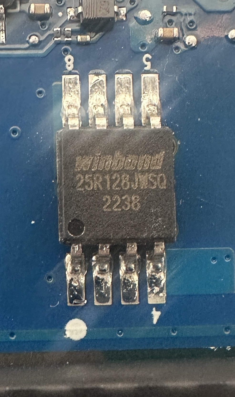

      Click image for larger version  Name:	IMG_9946.jpg Views:	0 Size:	491.3 KB ID:	3543827
    • hardware1
      • Sep 2021
      • 2936
      • N/A
      Okay, this is your BIOS chip and it's 1.8v so you will have to use 1.8v adapter if your programmer doesn't support that voltage.
      You will have to read the content of this chip and upload it here to let us help you.

        Here is the bios file from the laptop
