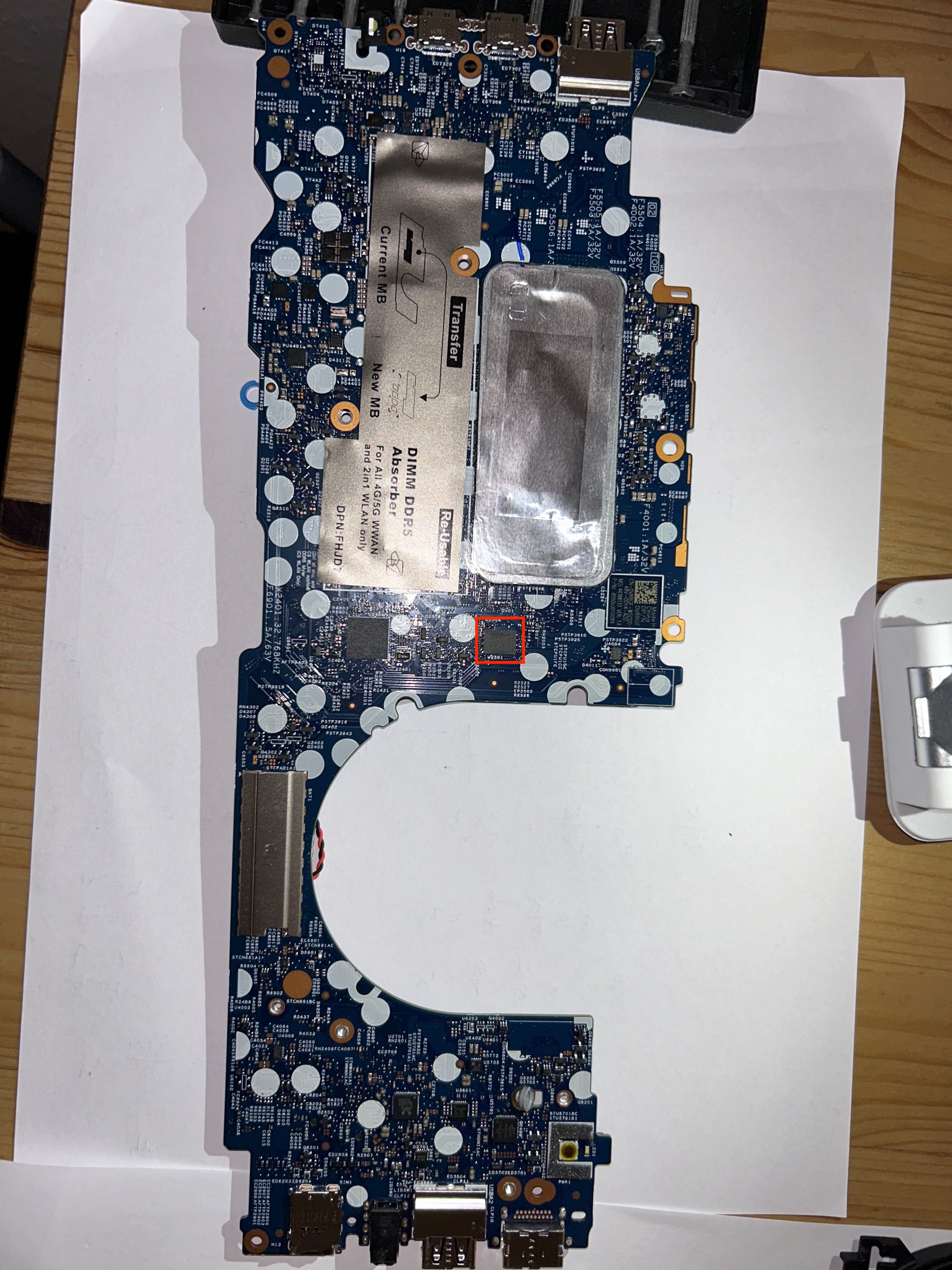

    It is for me the first time that i try to read a bios chip.
    Can someone please tell me where the bios chip is located on the Dell latitude 5350?
    Or maybe send a link where i could identify the location.

    Hello guys,
    i removed the board and searched for other bios chips, but as you can see from the pictures, there are no others on the lower side.
    This model has apparently only one bios chip.

        • volinakis
          • Jan 2021
          • 2865
          • N/A
          Originally posted by Cofabast
          Hello guys,
          U2501

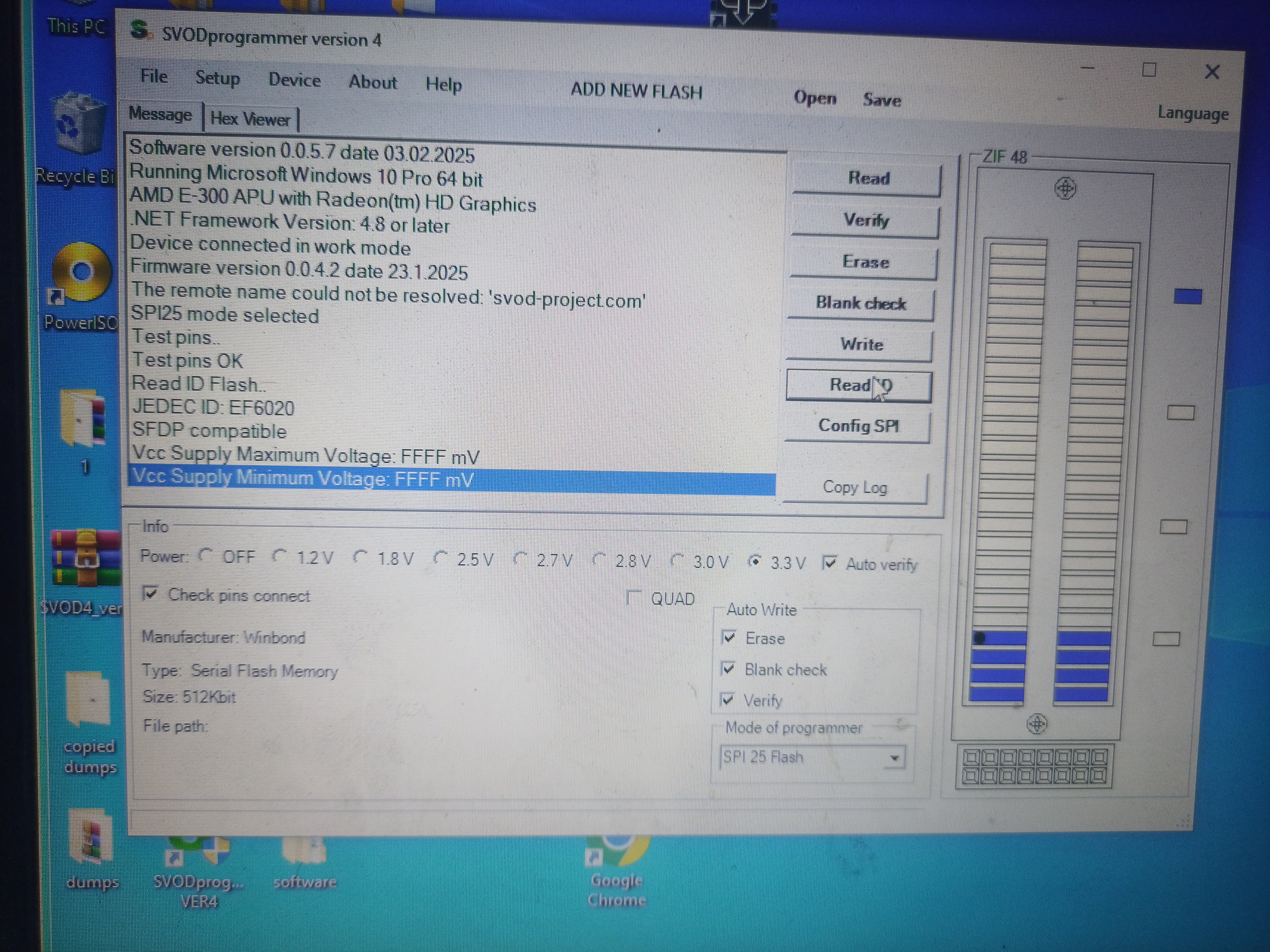

                #29
                it has ME Fw 18.0.5.2141 and MEAnalyzer doesn't recognize it. Without having 2 identical backups of bios chipset I don't advise to erase it. Pay attention, is 1.8V chipset.
                Sorry for responding late. I had to place order for another bios programmer to enable me read it correctly. The bios chip now reads 512kb instead is 512 mb. The bin file is saved as 64kb instead of 64mb. I got a new bios chip with the same number and it still reads the same 512kb . What do I do at this point sir.
                  What is the part number on the chip, read what is written on top of it. Post chip part number and the 64kb backup
                    Here is the part number and the backup. Thanks. Winbond 25R512NWEQ
                        The chip isn`t supported, yet. The chip is 1.8V . Choose a different 1.8V 512MB chip in the support list and click on Read , NOT Read-ID. Untick Auto-verify
                        EDIT: Correction, the chip is supported, you have to select 1.8V
                            I told you chipset is 1.8V yet you chose 3.3V to read it!

                              #36
                              I have changed it to 1.8V but still got the same reading.
                                it means you burned chipset.
                                  I ordered 5 pieces of that chip and the chip that I used right now at 1.8V gives the same reading
