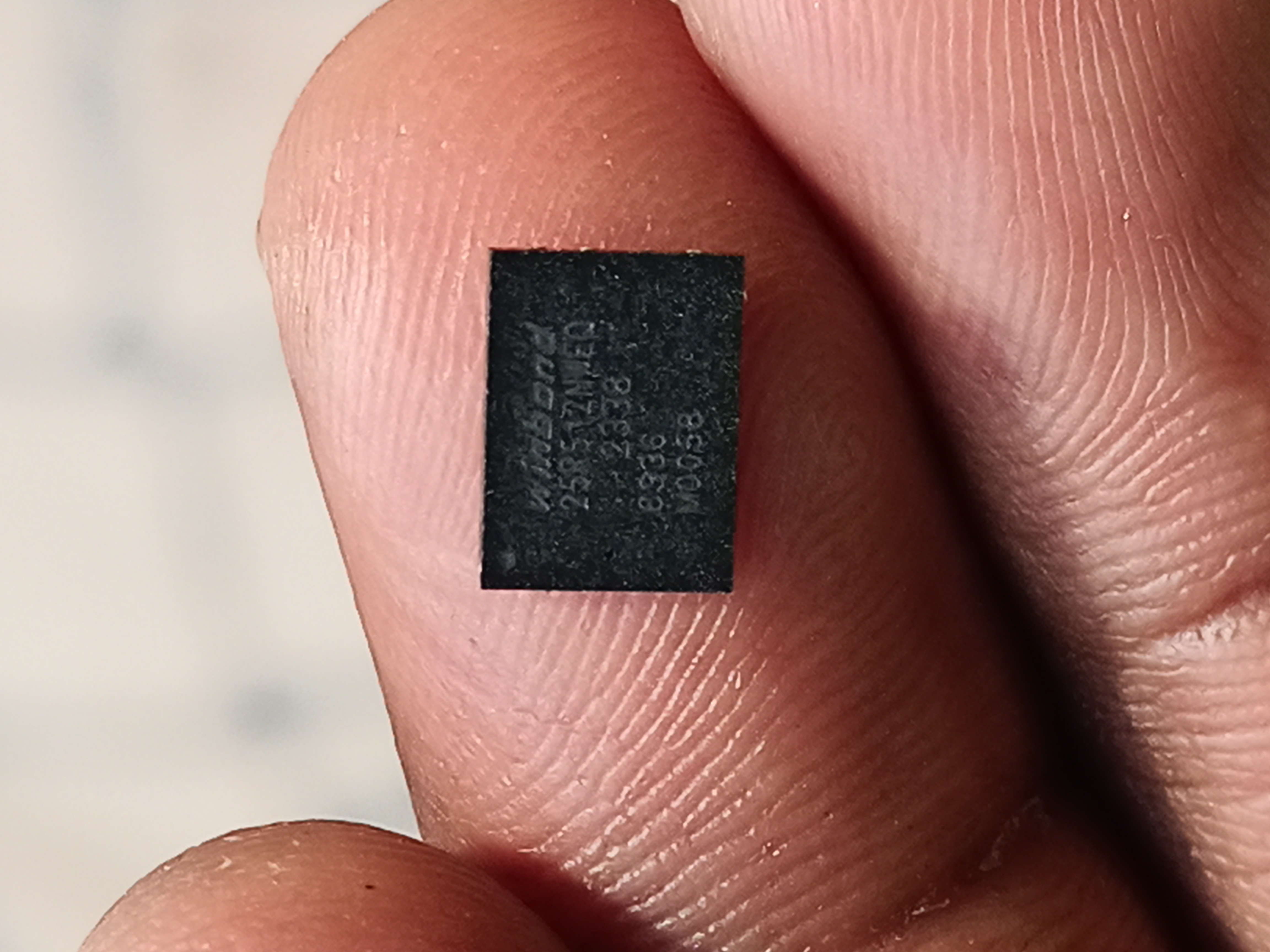

                      I got a Latitude 5350 with a locked bios, it uses only 1 bios chip (W25R512NWEQ) 64mb file. I've already made 6 different backups and none of them are the same, making the comparison with HxD. The most bizarre thing is that this model does not contain Intel Engine/Graphics/Independent Firmware. I'll leave some files here so you can analyze them, this model is very strange.

                        it has ME Fw 18.0.5.2141 and MEAnalyzer doesn't recognize it. Without having 2 identical backups of bios chipset I don't advise to erase it. Pay attention, is 1.8V chipset.
                        • santoslao
                          • Apr 2017
                          • 131
                          • BZ
                          Exactly! I've made 6 backups so far, and none of them are the same, the ones I put here are just 2 of 6. I made backup using CH341 with Neoprogram and 4 others with rt809f, and none of them are the same.
                          • santoslao
                            • Apr 2017
                            • 131
                            • BZ
                            I was able to make identical backups! I simply removed the 1.8v adapter and made the backup on the CH341, selecting the chip "W25Q512JV", and the RT809f already has the correct chip, which is "W25Q512NW".
                            The backups were all identical, and I was able to remove the BIOS password. I hope the information will be useful to future colleagues in the area.​

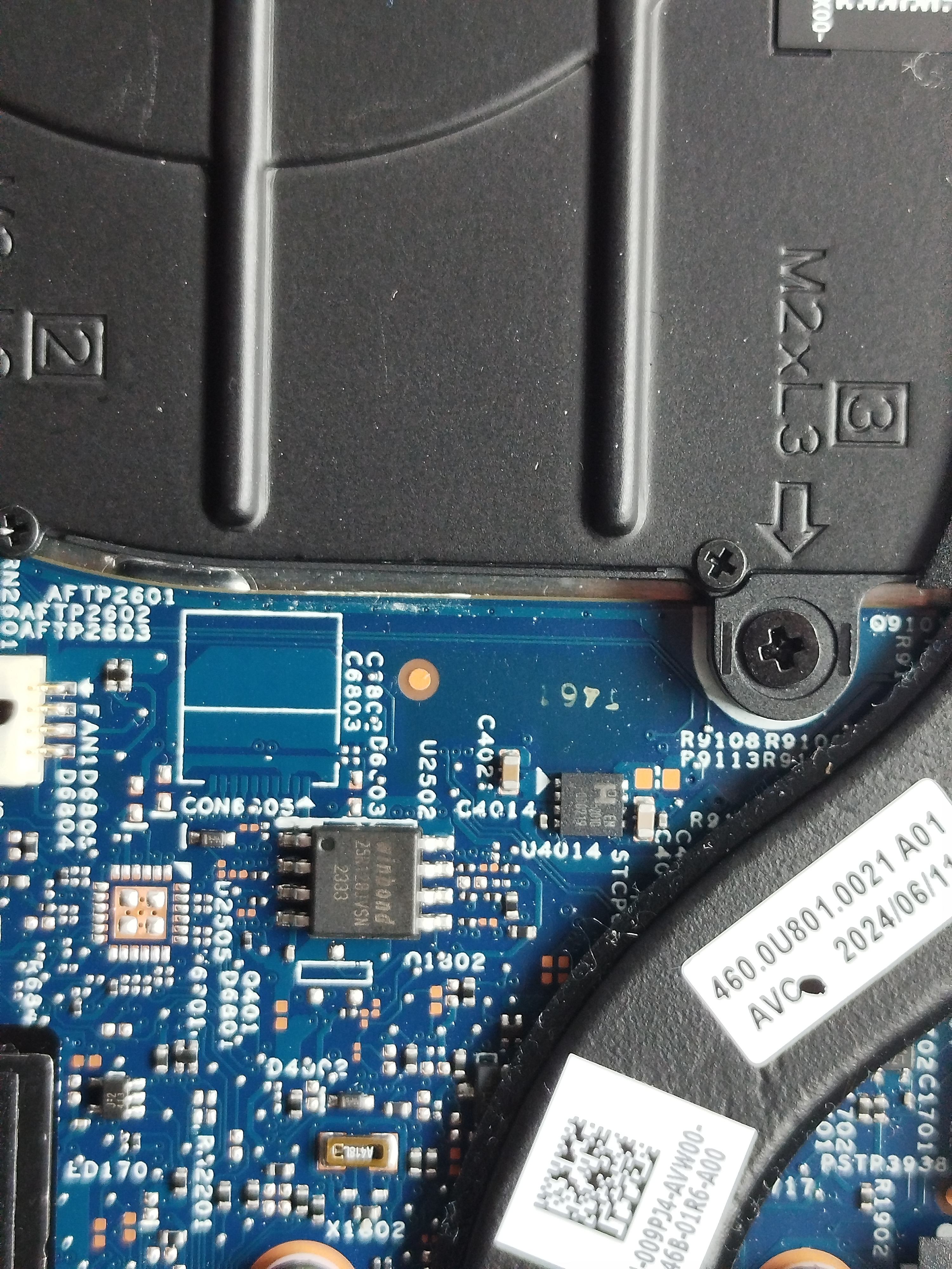

                              Hello, i bought a Dell Laptop Latitude 5350, but unfortunately the bios is locked with password.
                              unfortunately i cannot find the S/T.
                              Attached is the bin file of the current bios.
                              can you please help me and remove the bios password?
                              any support is really appreciated.

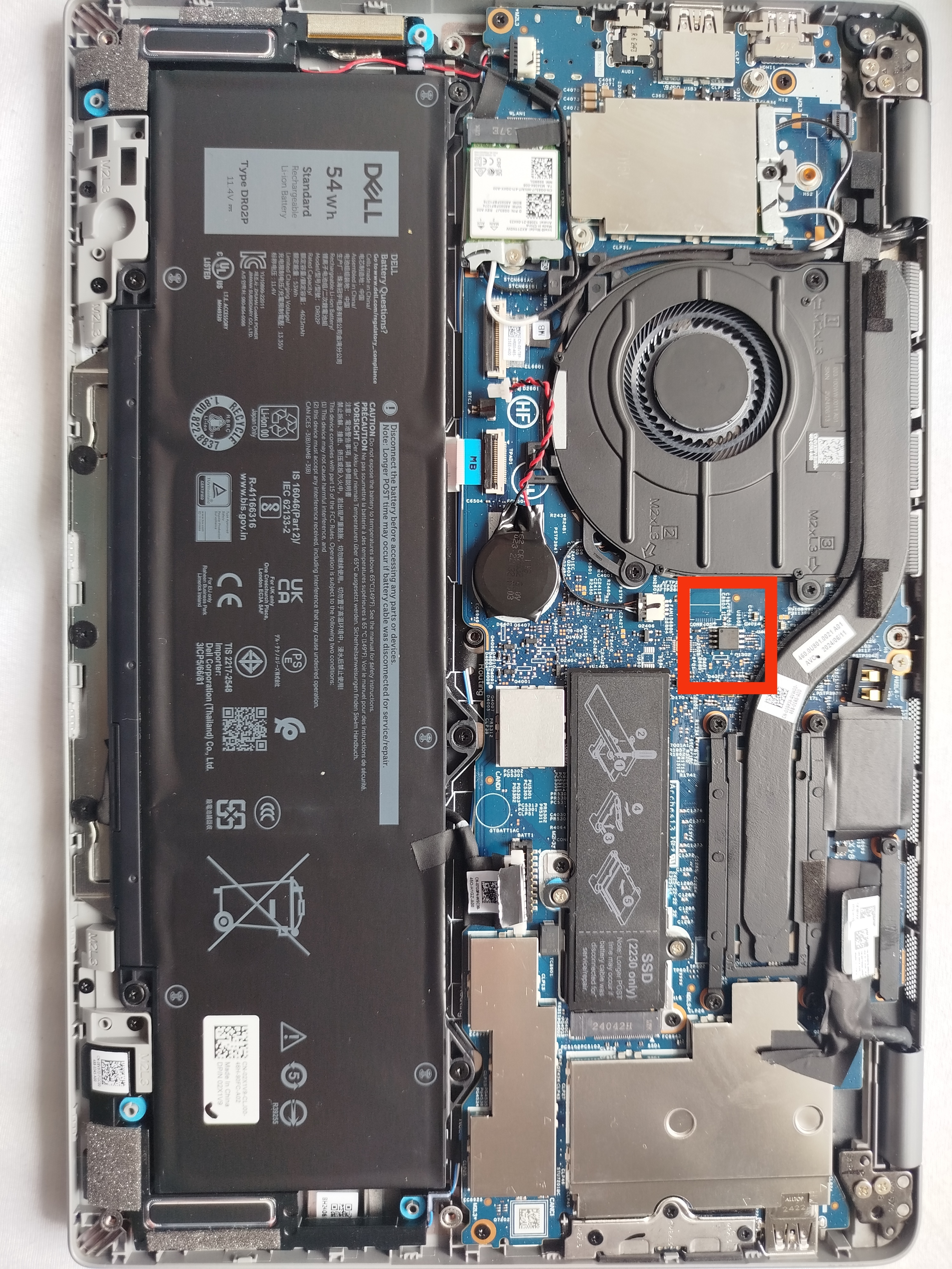

                                  • Cofabast
                                    • Feb 2025
                                    • 8
                                    Attached 2 pictures of my laptop (opened from below housing).
                                    I found only one chip. I suppose it is the bios chip.
                                    Please correct me if i am wrong.
                                    • danito
                                      • Jun 2016
                                      • 1054
                                      • Romania
                                      possibly on the other side
