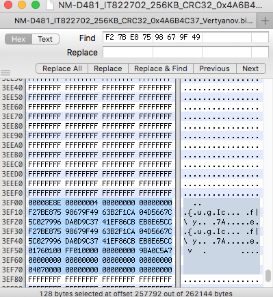

    I have attempted to remove the BIOS password from an E14 Gen 3 AMD:
    System Unit Serial Number PF30PWYB
    Machine type model 20YDS03T00
    Based on my experience with Intel machines and assuming that the password is stored in the EC, I made a backup of the EC, erased the EC and restored the backup.
    Unfortunately the password is still there.
    Can someone please tell me the correct way to do this?
    Attached is the backup of the EC.
    your backup is too short, 131Kb. Read it again and chose 256kb and 392Kb in SVOD4 settings

      I see the point, on the chip it says 256. But I was not able to read 256KB with SVOD4. I'll try Vertyanow.

        ok, so here comes the complete backup 256kB read with Vertyanov.

            pass seems to be as in photo, try fill with 00 and if not work fill with FF

              here you have a clean EC extracted from update, same version as yours - R1OHT28W - but you have to write DMI with Lenovo Maintenance Utility (LMU)
