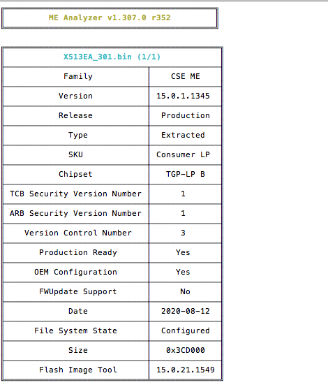

    Hi, I have problem with asus vivobook k513e. Came to with no pictures I found dump and flashed in to it, was working but did not see in bios ssd, so found another bios file now I can see ssd but laptop lagging evenin bios, also i opened hex editor and change serial number, maybe i did something?
    sometimes not usable so i think its need beter bios, maybe fixing original or brand new but i don't know how to make it. Please can someone help me with this. Thanks for your help and time. asus original k513e.bin have black screen, Newdmi k513e.bin lagging.​

        try an older version of bios, yours is 209 but is no longer on asus drivers site, so try 301.

            hi, unfortunately bios is still very slow, example laptop powers in to bios take very long than whwn press f7 to take to advance setting is very 5-7 seconds and mouse point freeze.

              you are having a hardware problem, bios is extracted from update with clean_ME

                Just want to check, is there a QR code sticker on the motherboard like this one https://www.badcaps.net/filedata/fetch?id=2080836 , if there is post a picture of it or post the model number on it Also, you have tried another charger havn`t you ?

                    Ok , so that confirms that the bios posted by Volinakis should be working and it`s a hardware fault.

                      do you think its can be a problem with battery, as just found out on charger is fast and that battery is brand new but not original.
