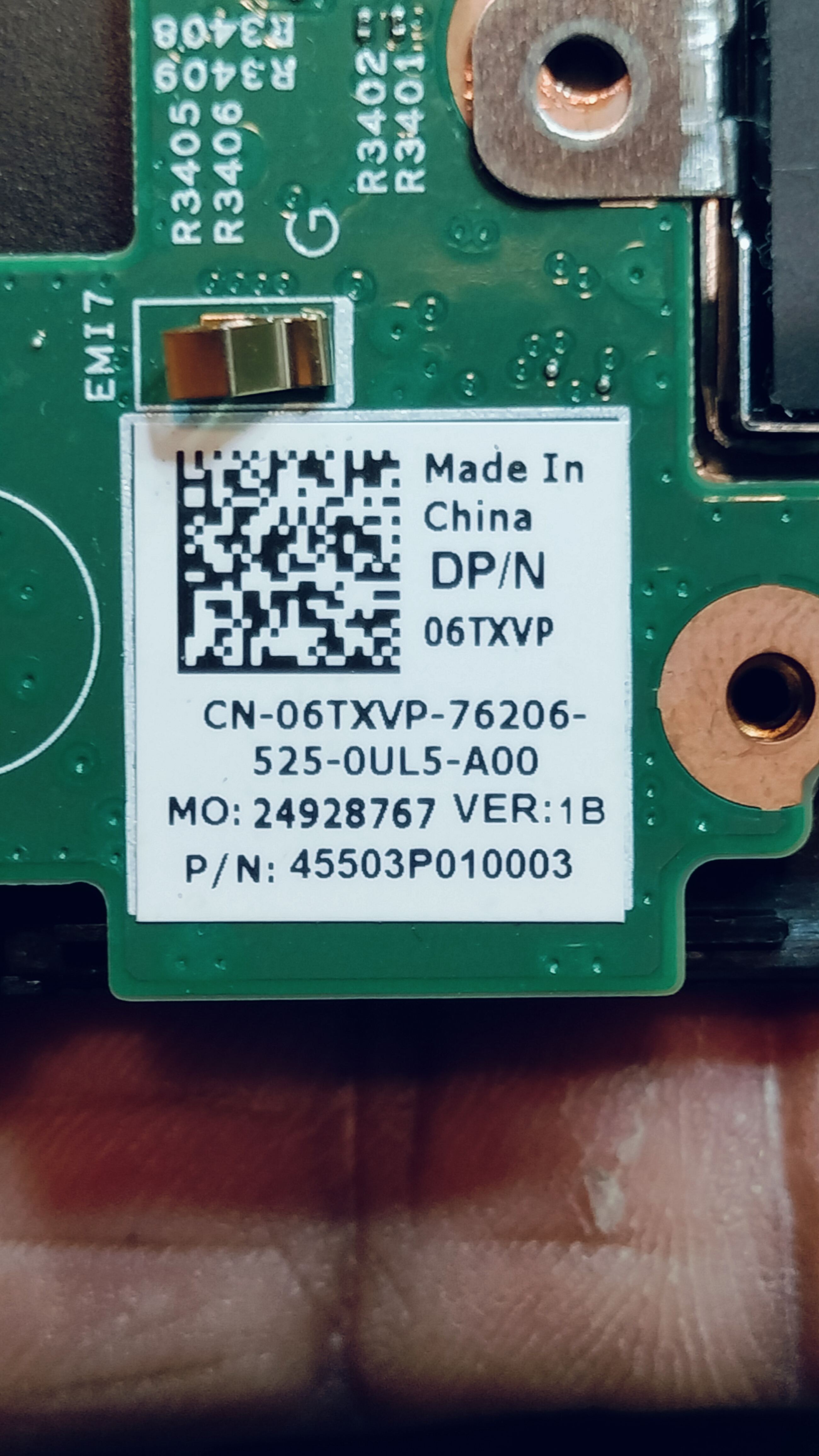

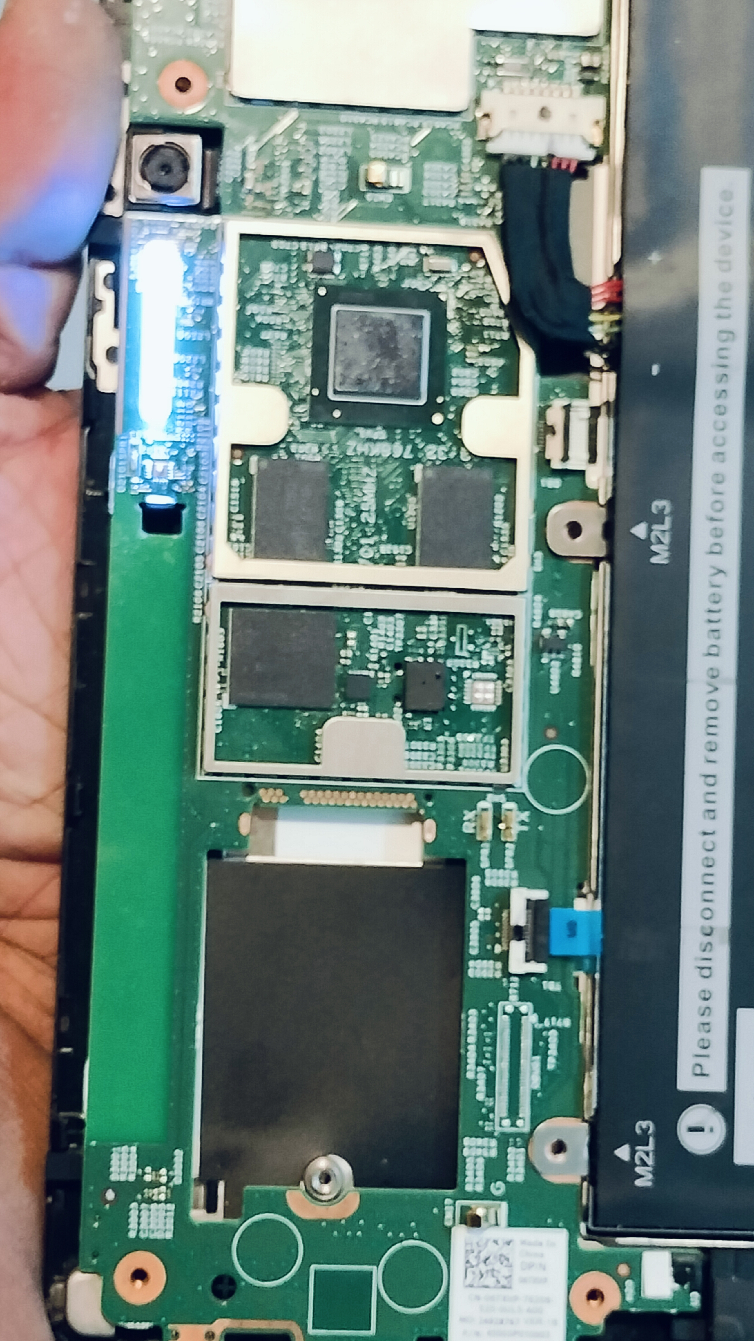

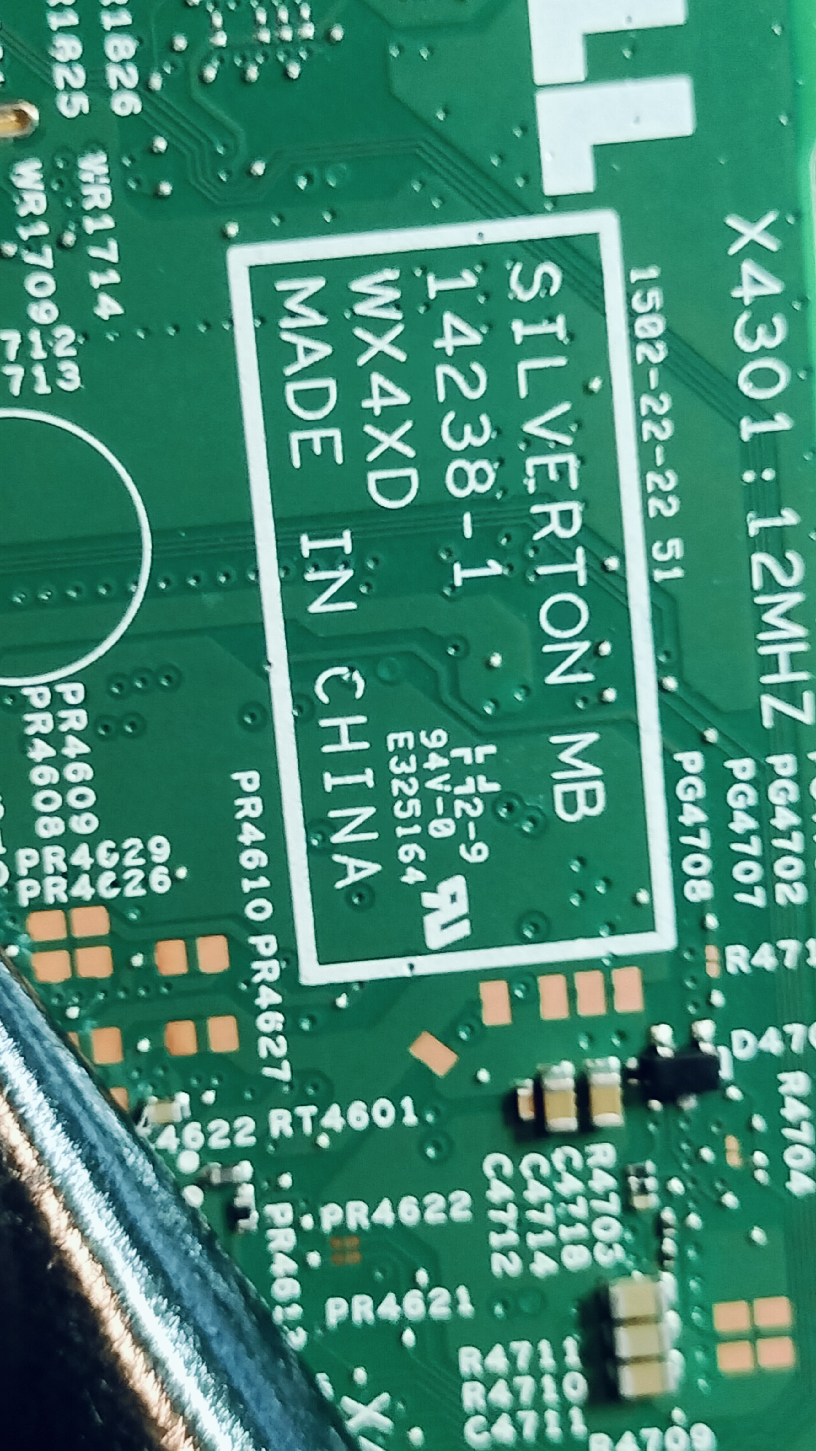

    I already write 2 bios files. For both files it is not on.
    Only light up top cover LED..
    Machine Model : Dell Venue 10 Pro 5055
    Service Tag: GWV0G32
    Board Model Number : SILVERTON MB
    14238-1
    WX4XD
    Please help to fix this problem.

                The bios also appeared in the end..., take a long time for it, send to you, try !!!
                • jeewantha
                  • Nov 2016
                  • 88
                  • Sri Lanka
                  File is working.
                  Thank you very much
