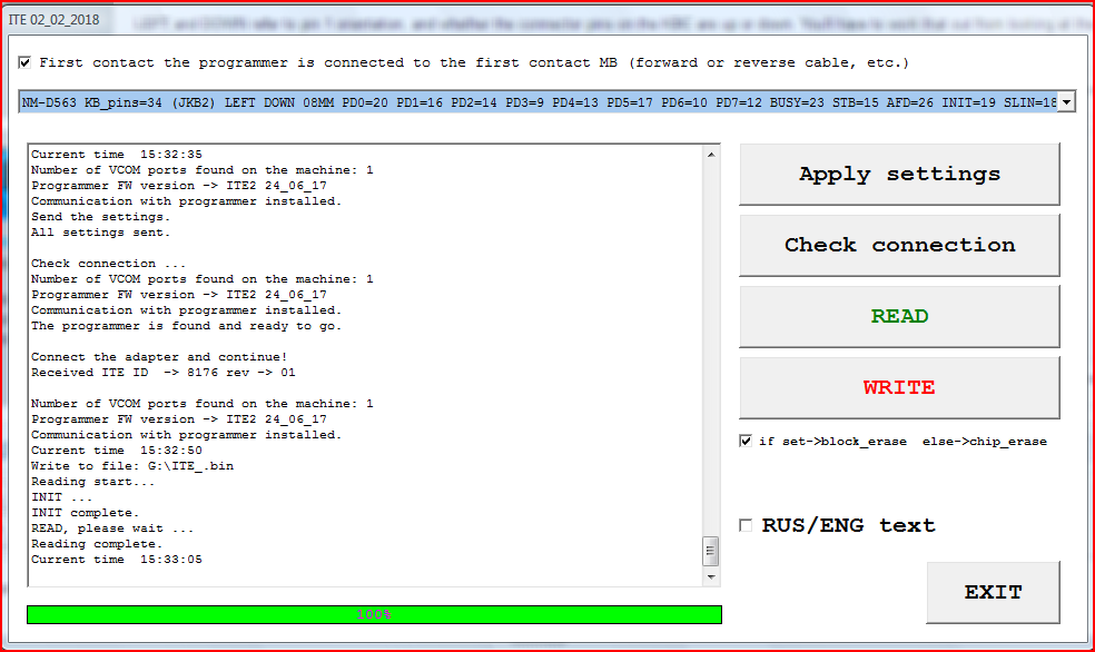

            Finally I have managed to read the IT8176 with Vertyanov programmer using the NM-D563 configuration. I've search on internet and found the following:
            NM-D563 KB_pins=34 (JKB2) LEFT DOWN 08MM PD0=20 PD1=16 PD2=14 PD3=9 PD4=13 PD5=17 PD6=10 PD7=12 BUSY=23 STB=15 AFD=26 INIT=19 SLIN=18 KSI4=22 KSI5=21 FLASH=56 CHIP=IT8176FN-56A
            This way I could read the chip and make a backup of its data. I have not write the chip, seems that it takes this data from bios when booting the first time.
            This is the working backup:

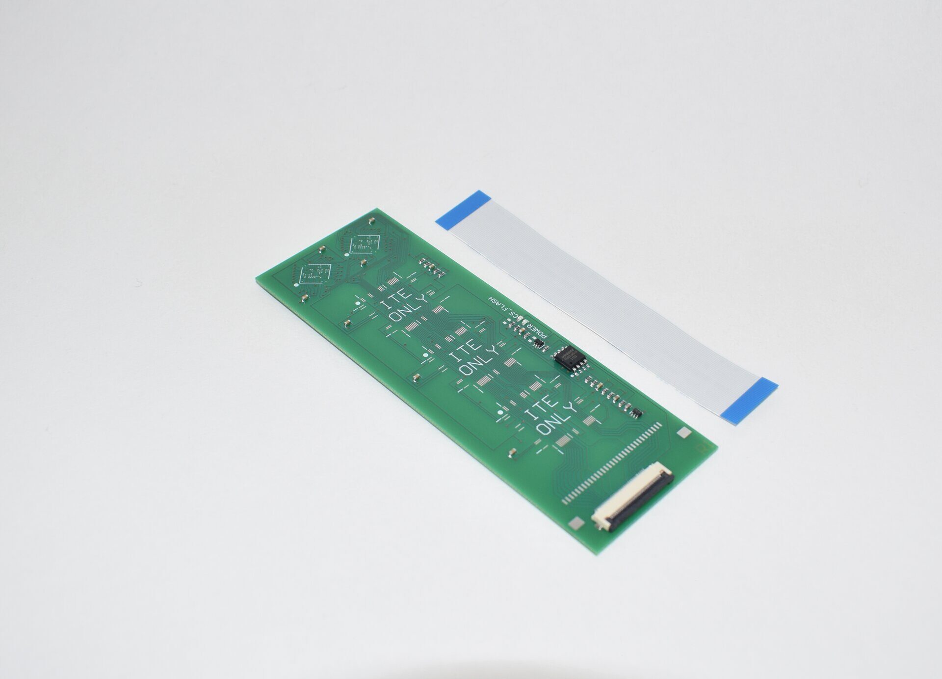

                            • Fencus
                              • Oct 2022
                              • 16
                              • Hungary
                              Originally posted by theused13
                              what kind of adapter you use , i have a SAS programmer
                              I dont familiar with that programmer. I've attached a photo from the adapter i used. I think it should work with other programmers but i m not 100 sure.
