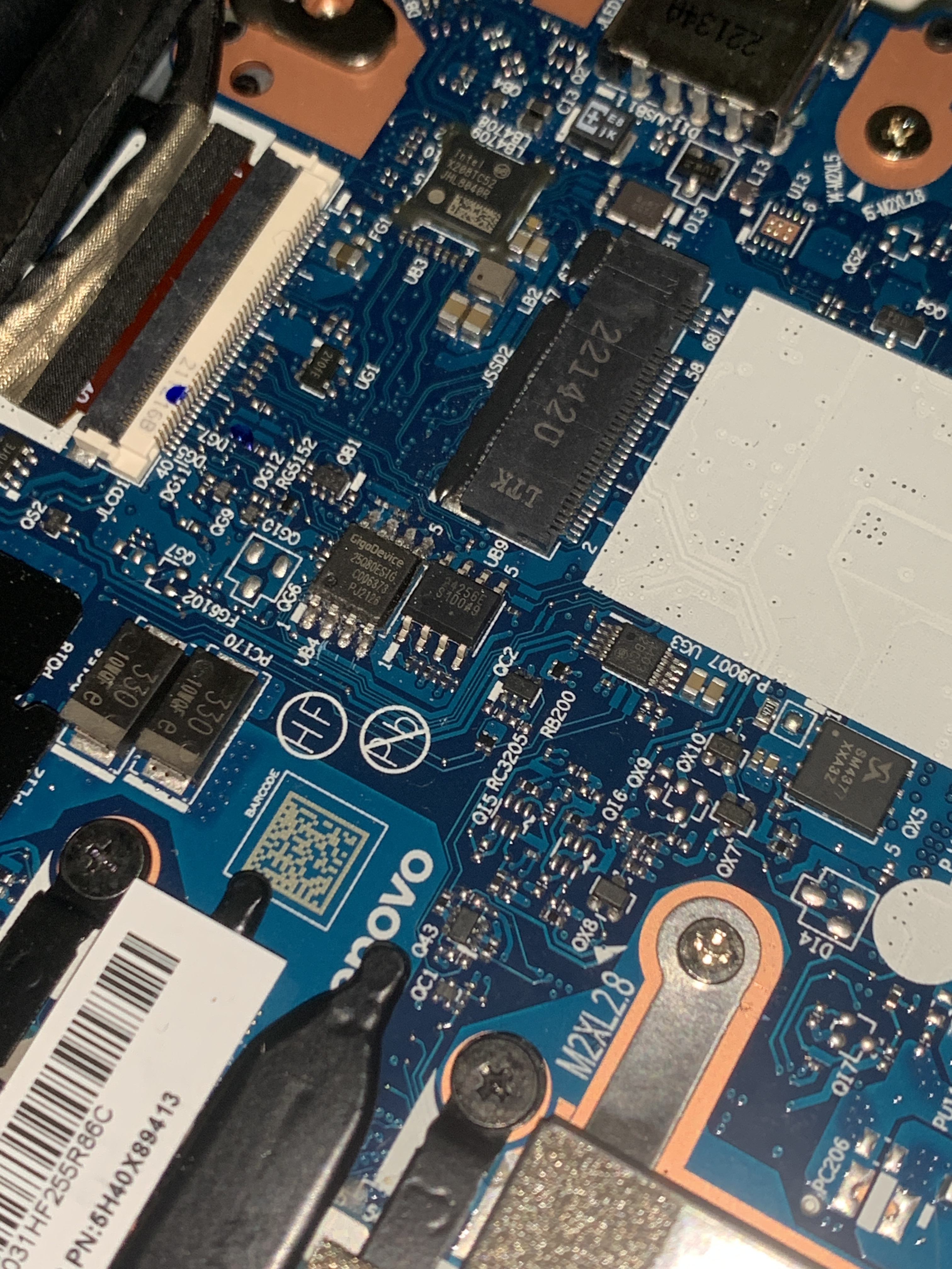

    I have 2 laptops E14 and one E15 with the same problem: don't turn on (no led) I suspect the bios and I have buy an CH341A.
    But now I need a new bios...
    I give below the older bios, can you check it please, or give a valid version of BIOS?
    I will be very grateful to you
    At first, this is the numbs of a e14: 20TA-00EWFR
    with a bios chip: Gigadevice GD25Q80
    Motherboard: GE4B0/GE5B0 NM-D011
    thanks​

    Gigadevice GD25Q80 is not bios chip.

      Hello, Thank you very much for your answer,
      if this is not the bios, what is it?
      and what is the bios? i have another chip near the gigadevice, an st device with 8 pins, i don't know
      But Have you a valid Bios for me please?
      Have a nice day
      • yop_FR
        • May 2024
        • 16
        • France
        Maybe the 24256E chip?

          Find other chip.

            What chip? i don't found another chip which match,
            Have you a valid bios for this pc?
              • 20918
              What is the point in giving you a bios,what are you going to flash it to.A bios can only be flashed to the correct chip. You must make a backup before erasing or flashing any other bios. Find all SPI chips using the schematic/boardview https://www.badcaps.net/forum/troubl...-1-0-schematic

                I just found in shematic this component: CAT24C256WI-GT3_SO8 it's the chip i was mentionned. is it the BIOS?
                  SMDFlea commented
                  Editing a comment
                  No,thats not it.

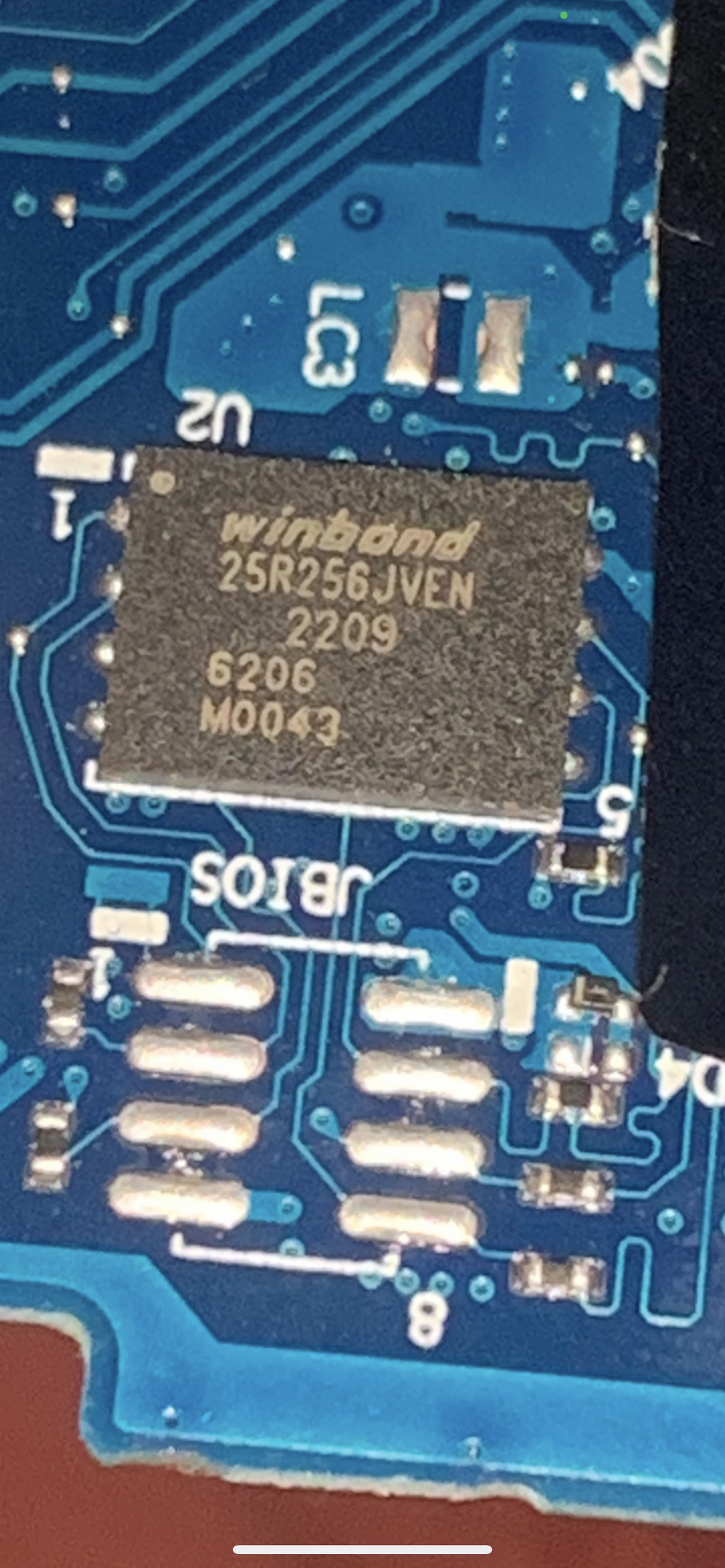

                  Hello, I think i have maybe found the bios, is it this chip? (winbond)
                  otherwise how can I find it?
                  Thank you in advance

                    It's exactly this chip.

                      oh thank you,
                      can i solder it in my CH341A?
                      and now, have you a valid bios for it?

                          If you have a WSON adapter board yes.Its essential that you make a good backup before erasing the chip or trying to flash any other bios.Post your backups here and we can check if they`re any good or not.If you don`t make backups you will make more problems for yourself.

                            Ok I buy on aliexpress the WSON adapter and I recontact you in 3 week,
                            Thank you very much!

                              Hi
                              I've done it, here is the bios file, from my thinkpad E14 gen 2 20TA-00EWFR with GE4B0/GE5B0 NM-D011 rev 1.0
                              this is a winbond W25R256JVEIQ but my software said to me W25Q256BV or W25Q256FV, I have export the bios with this two options cause idk.
                              The problem is: pc don't boot, no leds
                              Can you repair my bios? thanks you very much in advance , and can you say me which of two bios chip it is?

                                    ok, I actualize my message:
                                    here is the bios file, from my thinkpad E14 gen 2 20TA-00EWFR with GE4B0/GE5B0 NM-D011 rev 1.0, serial number is: PF-3S3RCV and PF-3RNC6_ (i have 2 same e14)
                                    Can you repair my bios? thanks you very much in advance , and can you say me which of two bios chip it is?​
