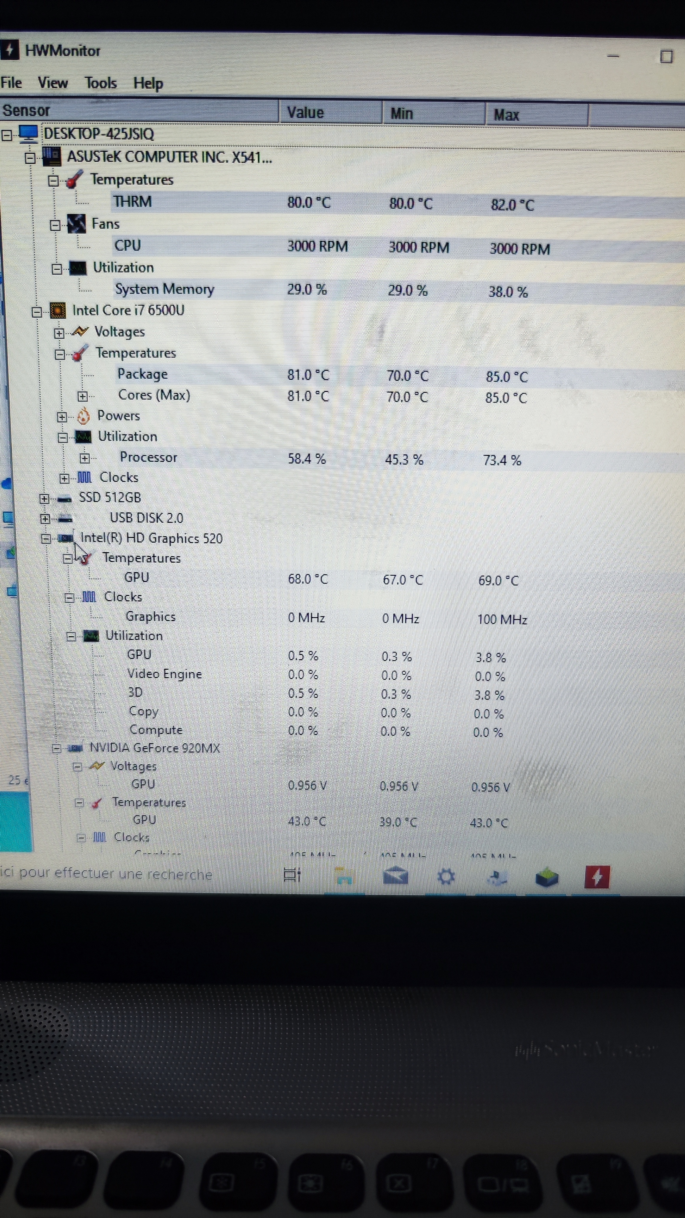

        • Yacine007
          • May 2024
          • 92
          • Maroc
          This is my first request and I am very grateful, thank you very much it works very well everything works correctly.
          • Yacine007
            • May 2024
            • 92
            • Maroc
            Originally posted by hoaca388
            Try and feedback
            Hello my friend hope you're fine, well after testing everything i have a problem with the fan it turn very high 2400rpm in normal condition.
            Is there a program to control the fan? Or it's a problem with the bios version! Thank you in advance
            • hoaca388
              Badcaps
              • Jan 2022
              • 12394
              F541UV
              • Yacine007
                • May 2024
                • 92
                • Maroc
                F541UV
                Thank you very much for your intention and cooperation 🙏 apparently it's a manufacturer defect, it works like that. Thank a lot my friend may god protect you.
