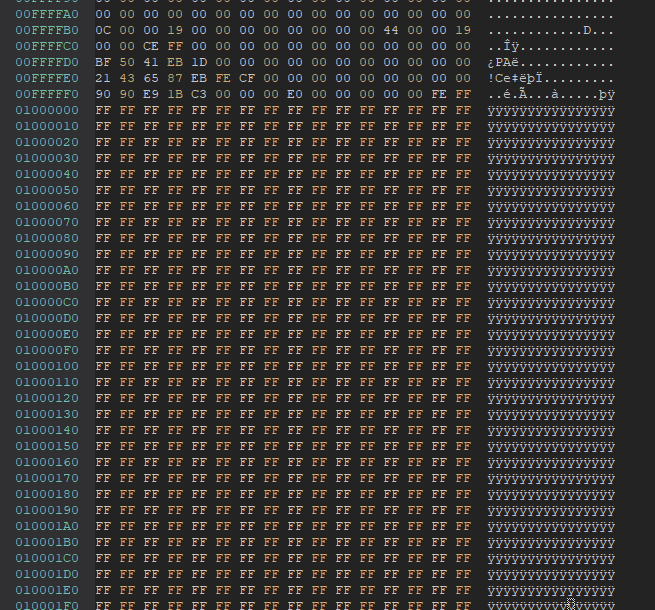

                        Try
                        This is your original bios. Did it work before?
                        Hello Max, many thanks for your reply.
                        No, it not do the flashing. My original bios that i post here is bad and also have admin password. :/
                        • mape92
                          • Jul 2025
                          • 10
                          • ITALIA
                          say to me " Chip main memory with the contents are in disagreement".
                          • Maxpower3
                            Bad Veteran
                            • Feb 2018
                            • 1319
                            • France
                            your file is too big
                            Click image for larger version  Name:	image.png Views:	0 Size:	8.6 KB ID:	3727742
                            retry with cutting
                            • mape92
                              • Jul 2025
                              • 10
                              • ITALIA
                              retry with cutting
                              Same error no power no video nothing.
                              that is bad read i think. :/
                              with this bios take from another post i've red light, power button light and fans spin but no video no post no boot nothing.
                              this machine worked regular but have admin password, after first flash try stop to work :/

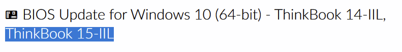

                                try
                                15-IIL clear me ThinkBook 15-IIL - DALVACMB8D0.rar
                                https://www.badcaps.net/forum/troubl...40#post1539440
                                djcn15ww instead of djcn16ww
                                revive file is DJCN27WW
                                • mape92
                                  • Jul 2025
                                  • 10
                                  • ITALIA
                                  Laptop is 14-ILL do you think is the same?
                                  • Maxpower3
                                    Bad Veteran
                                    • Feb 2018
                                    • 1319
                                    • France
                                    .Click image for larger version  Name:	image.png Views:	0 Size:	15.7 KB ID:	3727791
                                    • mape92
                                      • Jul 2025
                                      • 10
                                      • ITALIA
                                      not work :/
