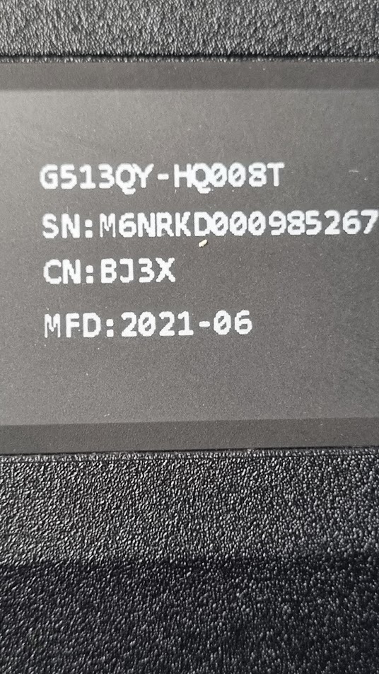

    Hi,anyone who can help me with a good bios or an older version please?
    The laptop turns on,i can use the bios but when i want to install winows get stuck at the first image
    I`m not sure if is a bios problem but worth to try
    And the bios
    • 21948
    Please read the rules and type the serial number. Your backup is no good,its only 991 bytes compressed,open it with a hex editor and look at the code its all zeros.Make another backup.

      Sory
      SN is M6NRKD000985267
      But i can`t compress the bios,maybe the file is corupted,the bios chip is a Winbond 74M12 and is different
