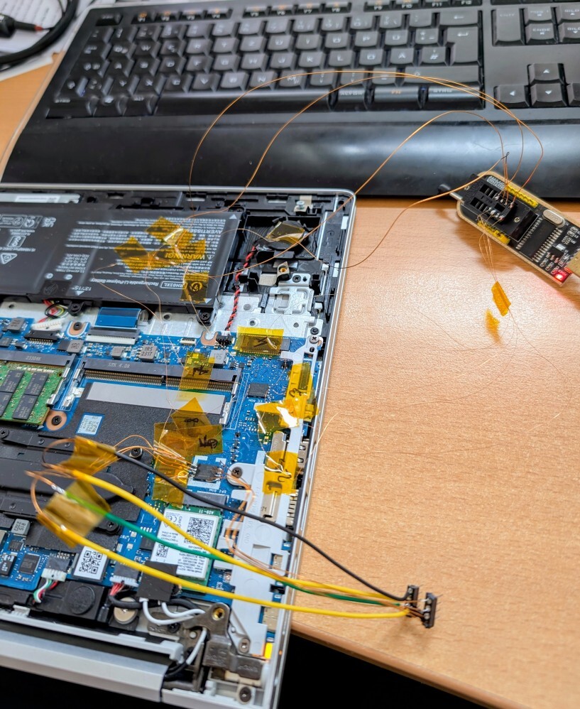

                              Originally posted by rex98
                              I noticed there's a lot of unlock request for this model HP ProBook 450 15.6 inch G10
                              The patch won't work if the bios version is latest. use this bin flash both it won't work if you only flash the main you should Flash Both.
                              first boot press f10 apply factory defaults and restart, 2nd boot reset security settings to defaults and exit.
                              use HP BCU(HP Bios Config Utility) and put your original DMI.
                              frequently asked questions:
                              can i use this to my HP ProBook 450 15.6 inch G10- yes
                              This is only for BID V72 only if you have different BID it won't work.
                              To determine your BID use hex editor and search V72 in your main bios or EC, you know the rest.
                              Thank you !!!
                              It worked like a charm. I had exactly this V72 version of the BIOS.
                              With a little soldering practice and a cheap programmer, everything is possible.
                              Click image for larger version  Name:	Bios_Flash.jpg Views:	0 Size:	254.1 KB ID:	3758799
