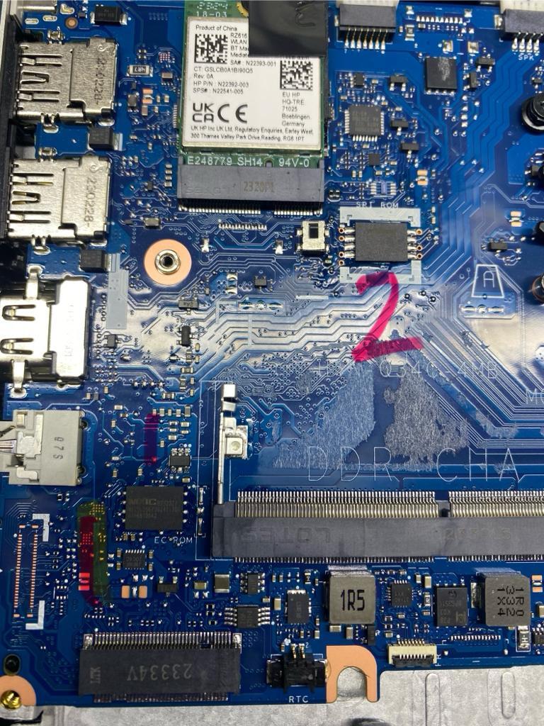

                    hello i have this hp probook 455 g10 with bios password. sn 5cd40303zg
                    • Ghamidi
                      • Mar 2020
                      • 303
                      • France
                      first boot press f10 apply factory defaults and restart. 2nd boot restore security settings to defaults
                      Plz feedback
                      • Hachem25
                        • Aug 2021
                        • 45
                        • algeria
                        Plz feedback
                        no work, still with password
                        • Ghamidi
                          • Mar 2020
                          • 303
                          • France
                          Please upload EC
                          • Hachem25
                            • Aug 2021
                            • 45
                            • algeria
                            here is the ec file.
                            • ahmed100
                              • Mar 2023
                              • 41
                              • Maroc
                              Help me to remove bios password please
                              HP Probook 445 G10
                              SN : 5CD401965W
                              BoardModel: DA0X9TMB8D0 REV: D​
                              • Hachem25
                                • Aug 2021
                                • 45
                                • algeria
                                main after reflash
                                • Ghamidi
                                  • Mar 2020
                                  • 303
                                  • France
                                  main after reflash
                                  Try this file please need feedback
