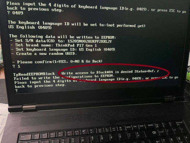

    Originally posted by keczuk
    hmmm why u not answer me ? i see you are online everyday
    Click image for larger version  Name:	222.jpg Views:	0 Size:	94.9 KB ID:	3175478
    My version is not finished at the moment
    I don't have time to take care of it and it is not available .
    Write access is locked, if your usb key is well done with the utility provided,
    you must have the rights.
    No access, weird.
    Rest of password, or Ec corrupted may be ?
    try to load the default setup, clean the security tab etc. and try again.
    For block 84, I have no idea what it corresponds to
    I don't know what you originally did to the PC, it's hard to help you anymore
    try this one ThinkPad Maintenance Utilities V1.19(X64)
    https://www.badcaps.net/forum/troubl...57#post1831957

      Sorry i didn't see your post.
      But i found solution now!!!
      Problem ist SVOD4. In some cases the svod4 programmer makes the mec chip (some kind of) locked. If this happenes the notebook is running, but mec isn't writable.
      Then you need RT809H, write the dump back with this programmer and the problem ist gone, now i can write all data like B0 etc with U1. No Problems anymore and no error messages.
      The funny part is: once programming with RT809H, programming with svod4 is possible again.

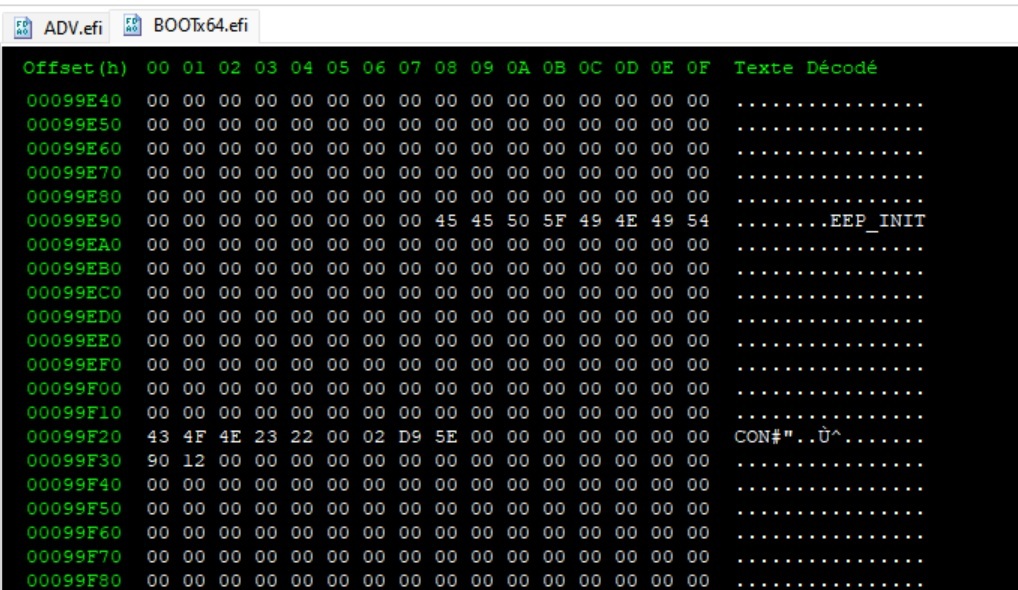

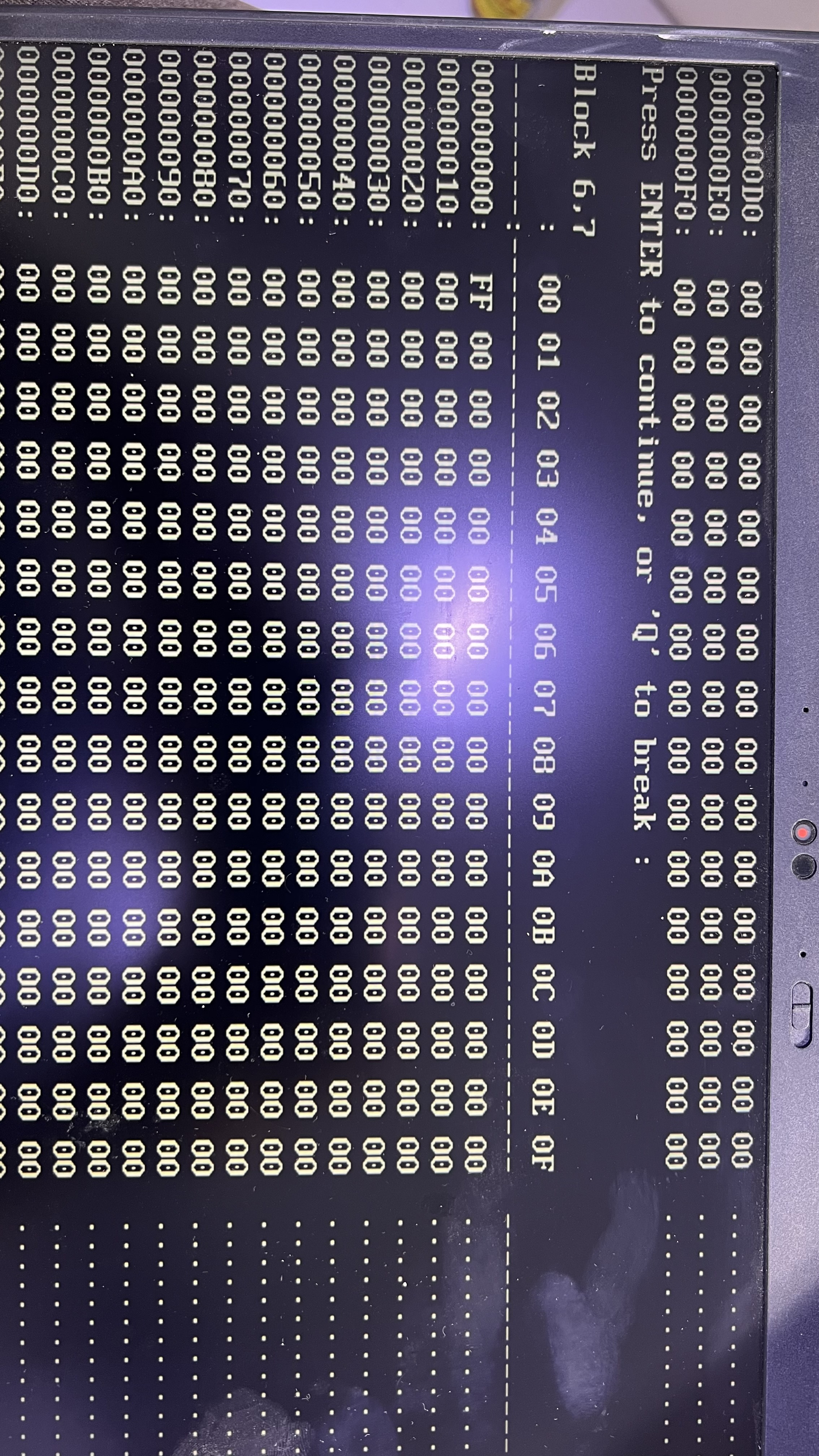

            we find the different pages in bootx64 written on EC
            This bit in bios with no password if password in bios this bit is moved in block 6-7

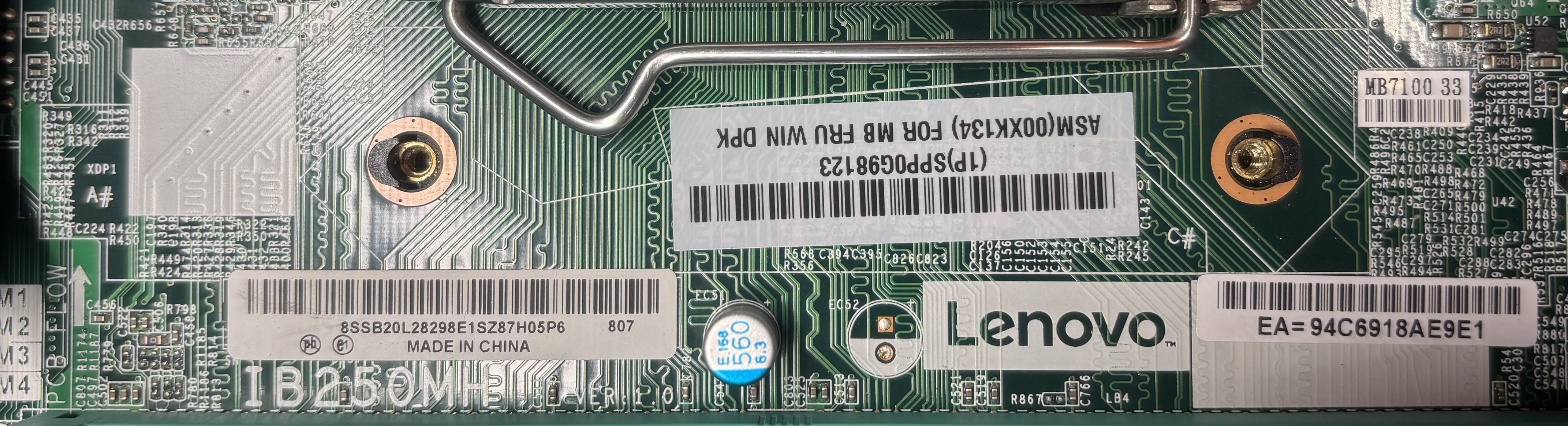

                        Originally posted by caphamxa
                        where can i get the other serials such as b0 etc, is it necessary to have other data too. I think initializing eprom removed all the information.
                        Usually there must be a sticker for B0 like in attached image...
                        For C0 you can put together like this example:
                        1. Machine Type Model : 20S0002UAD
                        2. Serial Number : PF2BMNC6
                        3. 1S + Machine Type Model + Serial Number
                        4. Final: 1S20S0002UADPF2BMNC6
