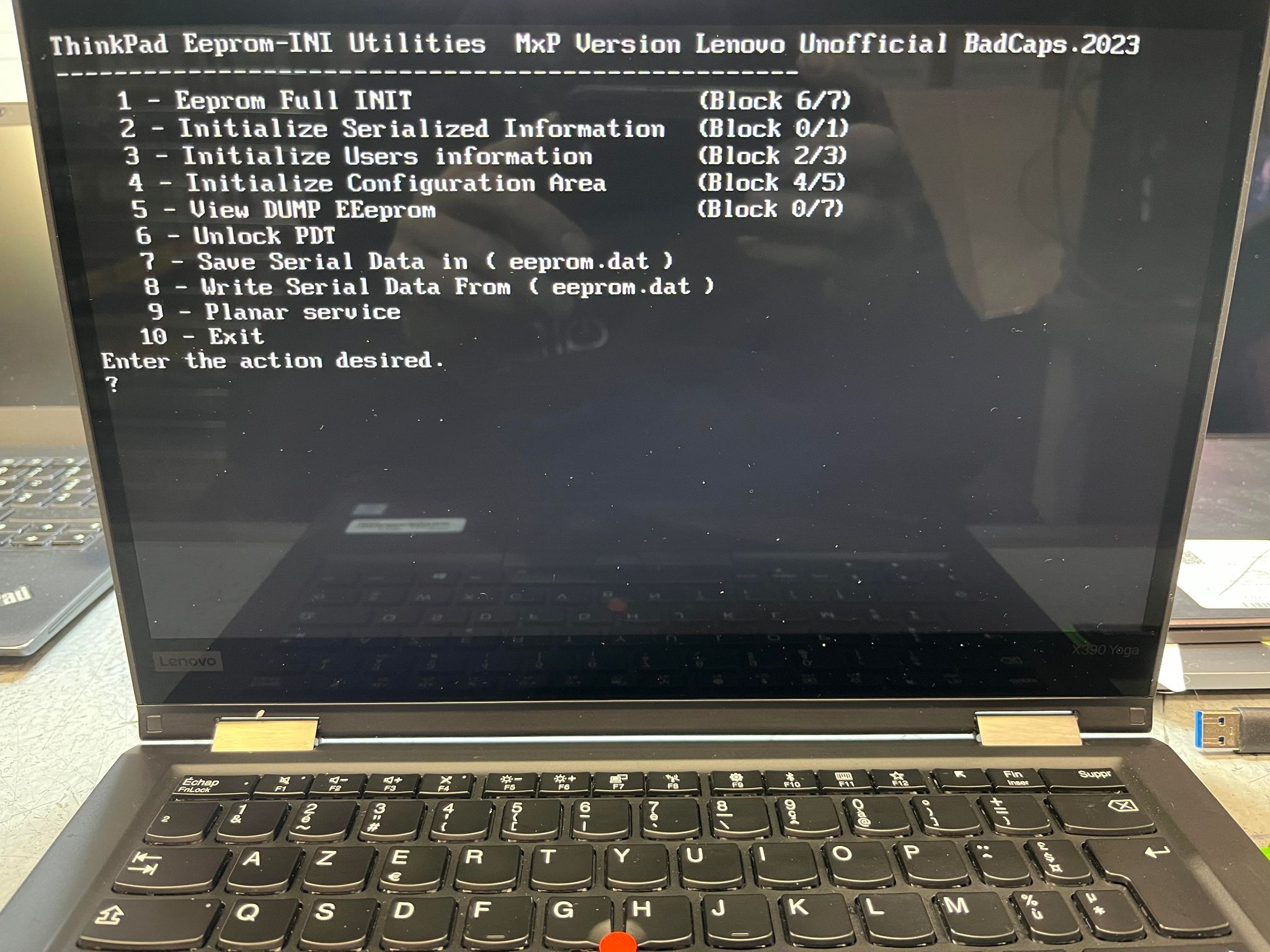

    can you post your EC dumps?
    have you tried planar services?

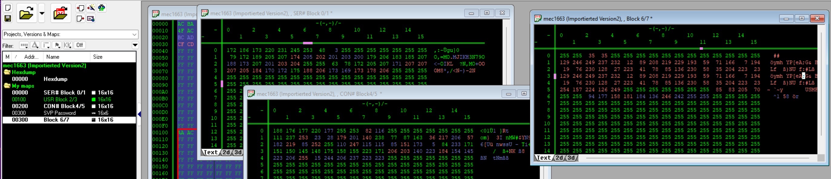

    with dump eeprom (5), are there serials and information marked in it ?
    you can try with SERUPDT (exemple 7 and 8 in my pics)

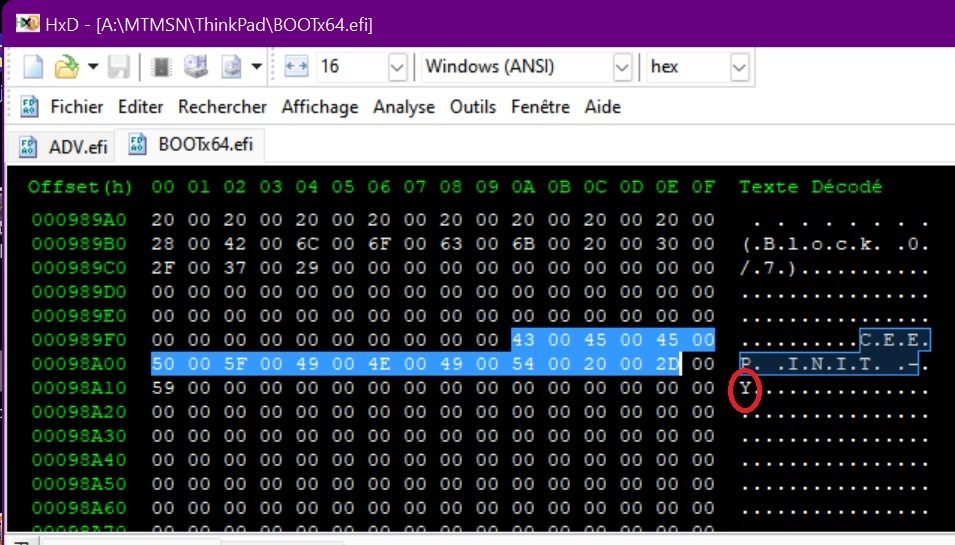

      Do you have the page titles block 0/1 SER# Block 2/3 USR# Block 4/5 CON# displayed with dump eeprom?
      in A:\MTMSN\ThinkPad\bootx64
      with HxD
      find two times 43 00 45 00 45 00 50 00 5F 00 49 00 4E 00 49 00 54 00 20 00 2D replace Y by C
      and go init eeprom
      -S (Initialize serialize information)
      -U (Initialize user information)
      -C (Initialize configuration information)
      -Y Full init

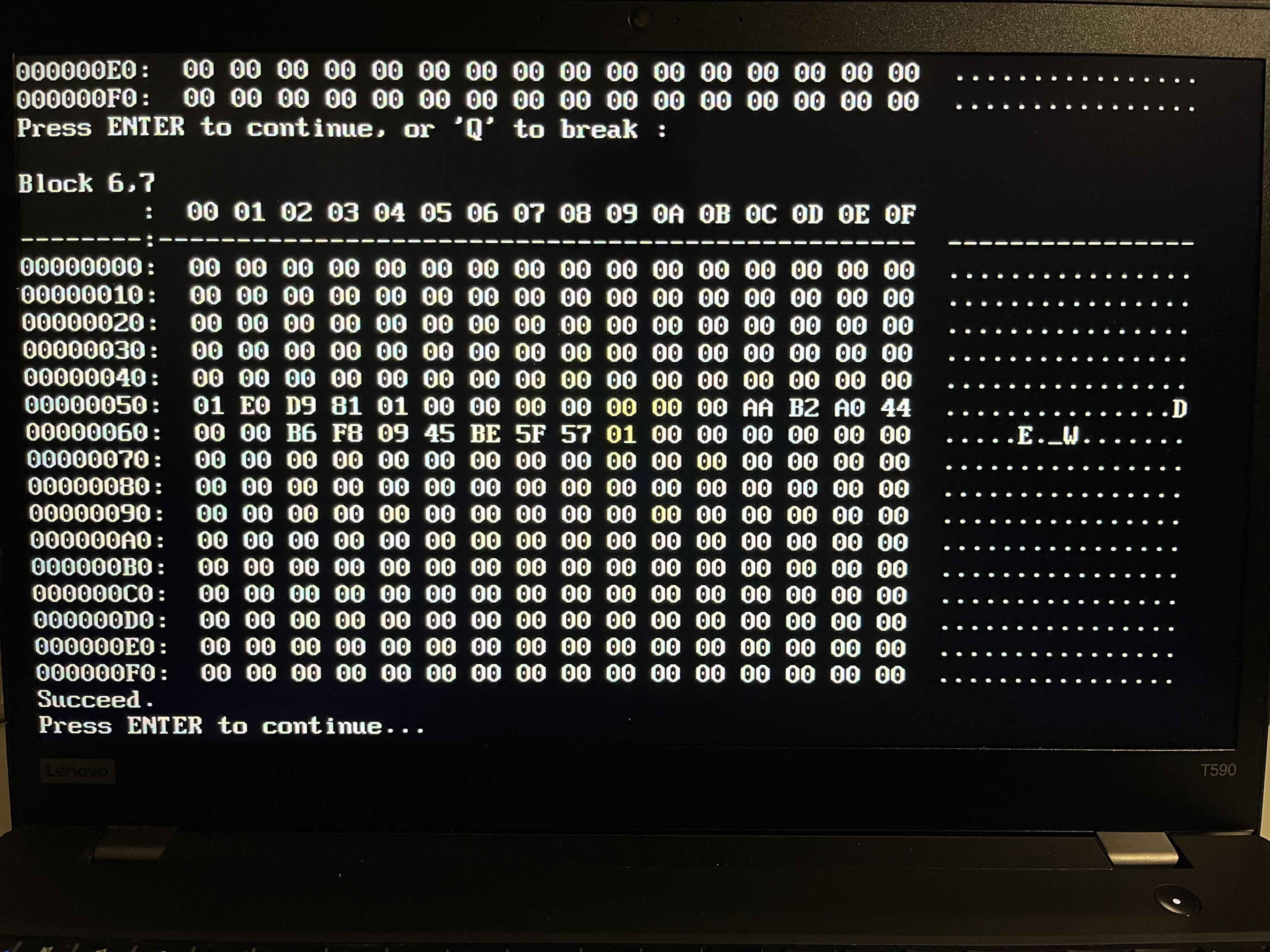

        With dump eeprom i can see Block 0,1 / Block 2,3 / Block 4,5 / Block 6,7

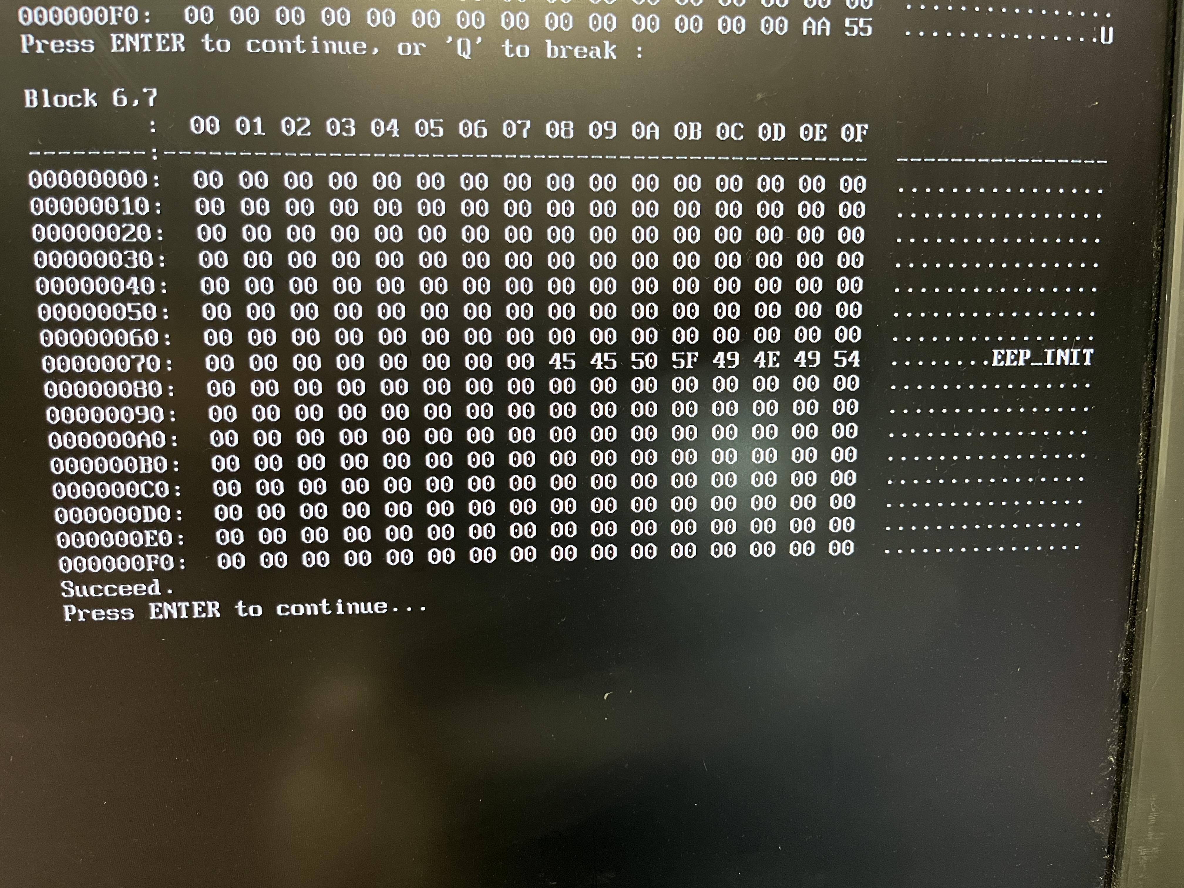

          even initialize it must not be EMPTY
          you can even see the magic number AA55 at the end of the 5 pages
            Click image for larger version Name:	365436541_269263119198220_3988259081739509859_n.jpg Views:	0 Size:	1.36 MB ID:	3156599
            we find the different pages in bootx64 written on EC

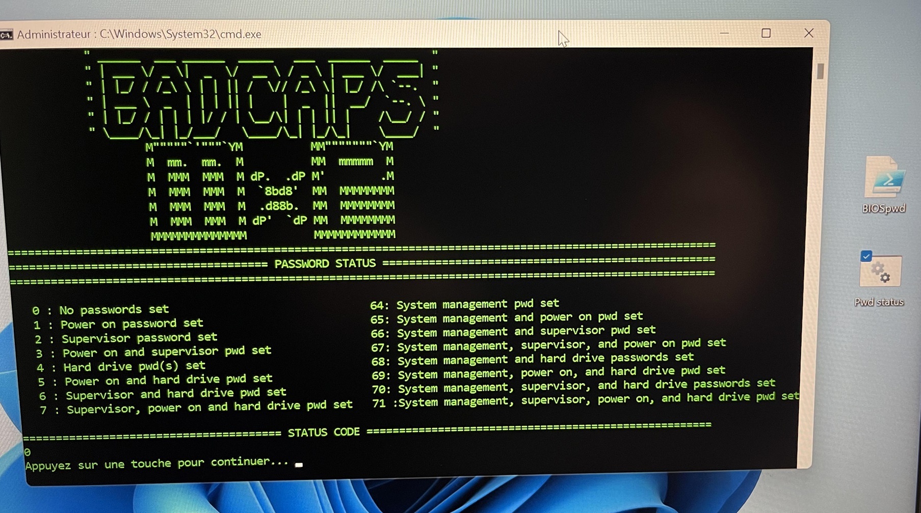

              you can see status of password under windows with script. put both files on the desktop
                with HxD
                and go init eeprom
                I did it but no change. I even dit it in ThinkPadT directory to be sure. Filename in both directorys is BootX64t.efi
                Statuscode is 0

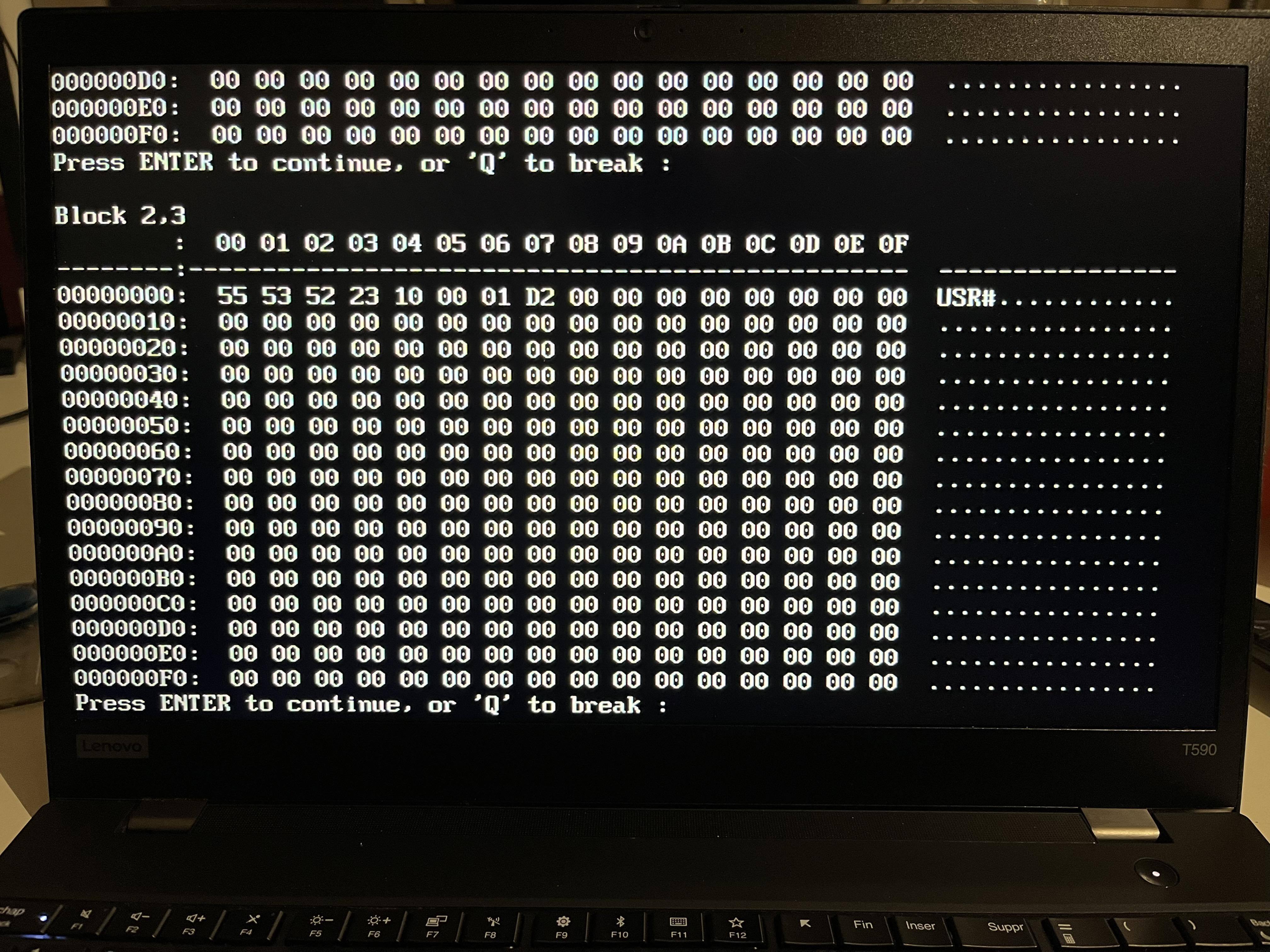

                  Yes but there are no words like SER# USR# or CON#
                  This is not normal, someone with a T590 or equivalent on hand to display the pages.
                  Can you post pics of yours?
                  For me it must have the titles at the beginning of each block

                    the dump is completely blank, that's not okay!!
                    you see that it wants to write SER# in block 0/1 but it doesn't happen because the information doesn't match.
                    Why doesn't he try the other blocks too, he stops.
                    did you put EEPINIT -Y back correctly?​

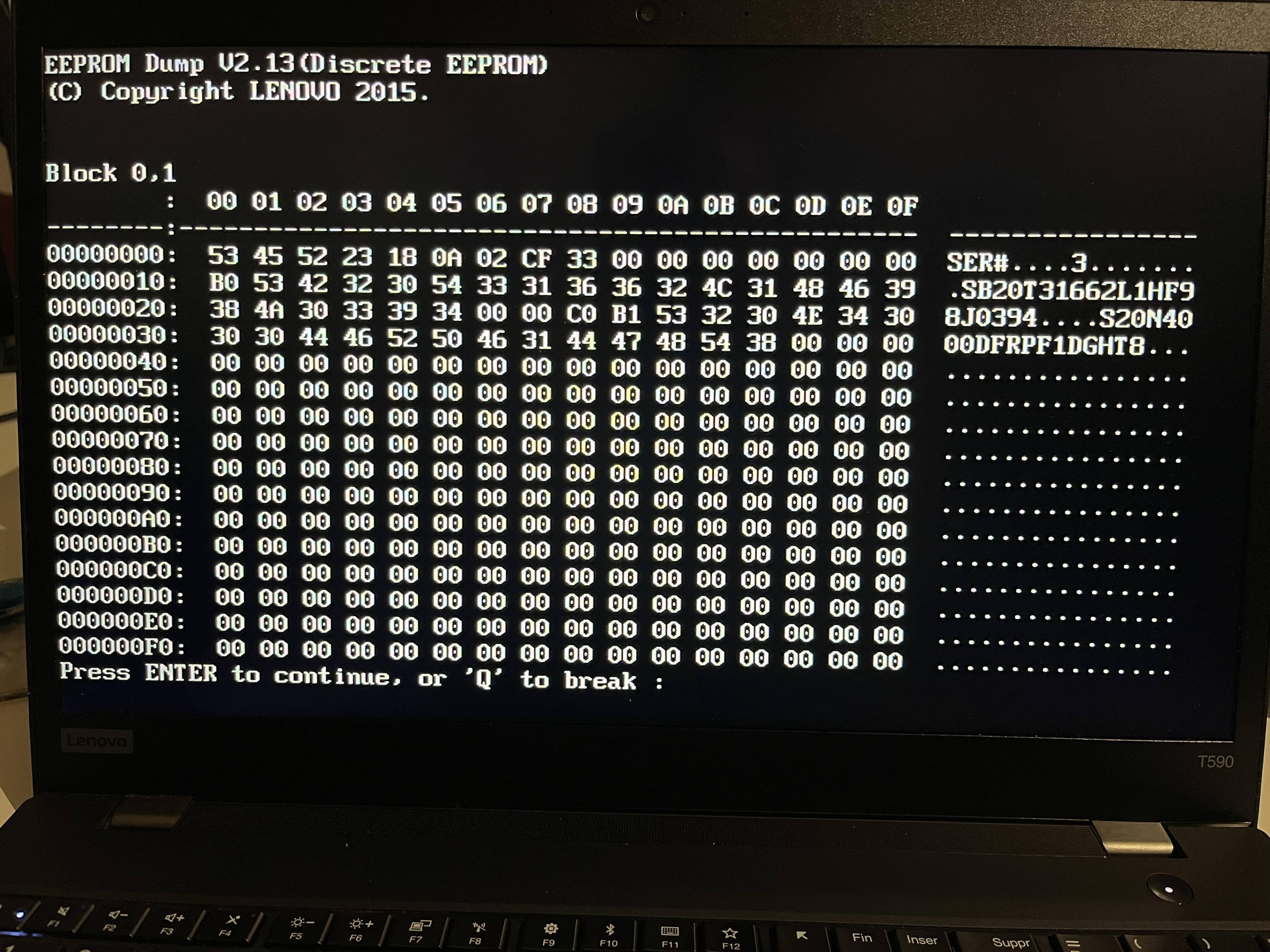

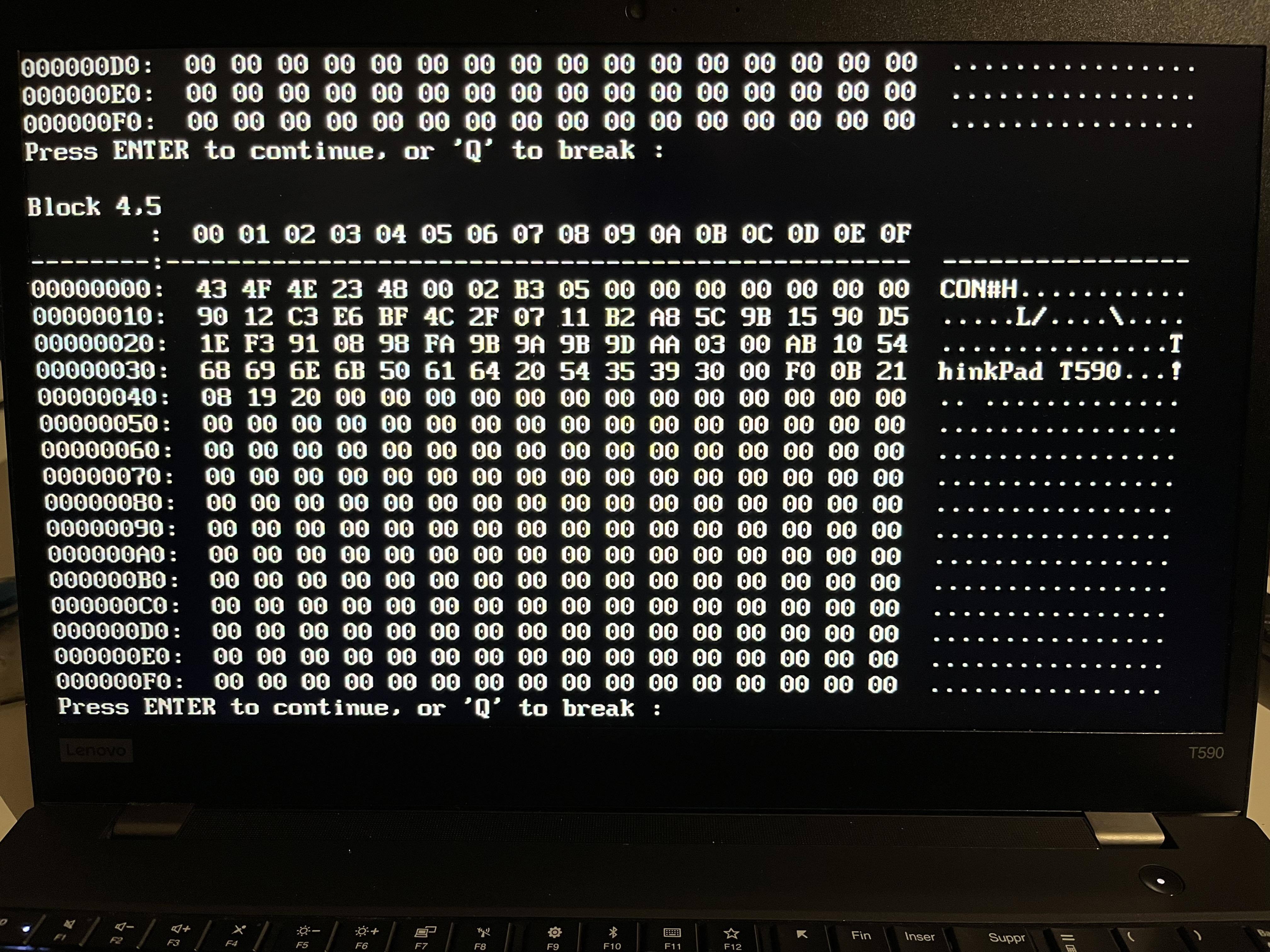

                              here the 4 blocks, read on a T590
                              Click image for larger version  Name:	406360780_843288264147488_6871955227433131275_n.jpg Views:	0 Size:	1.27 MB ID:	3157832 Click image for larger version  Name:	400865812_1088683599243027_2888667166992596740_n.jpg Views:	0 Size:	1.32 MB ID:	3157833 Click image for larger version  Name:	400494683_879831300385520_1758401697899313637_n.jpg Views:	0 Size:	1.28 MB ID:	3157834 Click image for larger version  Name:	406670622_284067567554636_3243226384332222195_n.jpg Views:	0 Size:	1.27 MB ID:	3157836

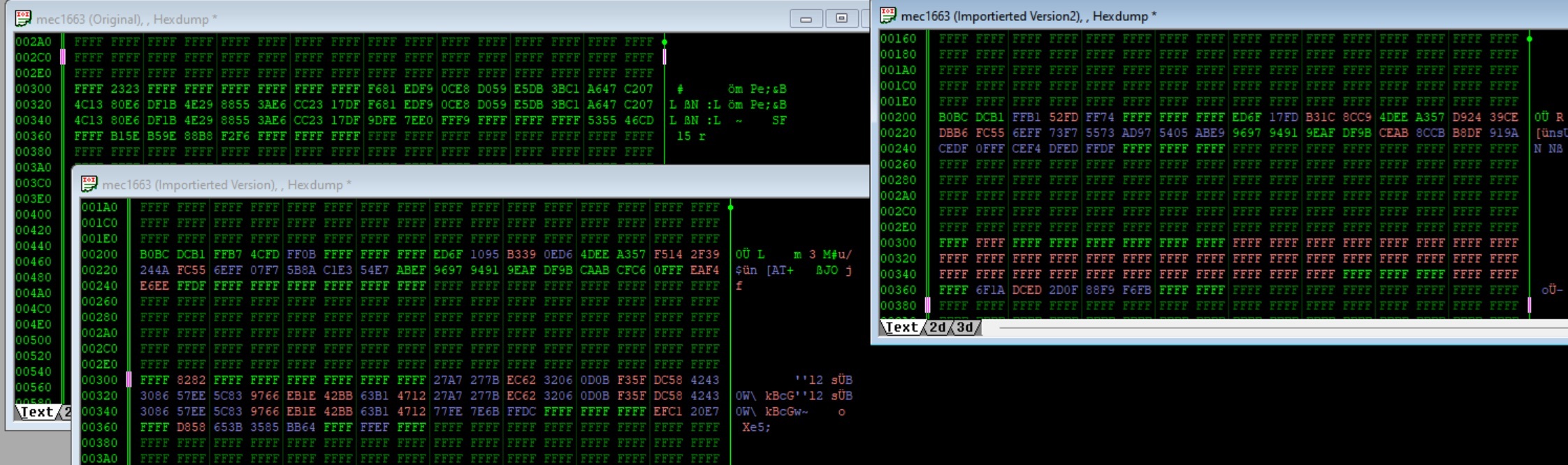

                                The password is once again hidden at 0x300 in EC eeprom
                                I get the impression by comparing.
                                just clean from 300 to 35F maybe necessary?
                                (after analyse 300 to 34F should be sufficient, see photos above of the T590 without password)
                                Click image for larger version  Name:	406360780_843288264147488_6871955227433131275_n.jpg Views:	0 Size:	541.7 KB ID:	3157977
                                here's how it is for me!
                                Maybe I'm all wrong, I don't know,)
                                Click image for larger version  Name:	406360780_843288264147488_6871955227433131275_n.jpg Views:	0 Size:	485.1 KB ID:	3157986
                                the number of header characters is identical and a lot of similarity compared to the photos of the eeprom dump above
                                I'm pretty sure that's it
