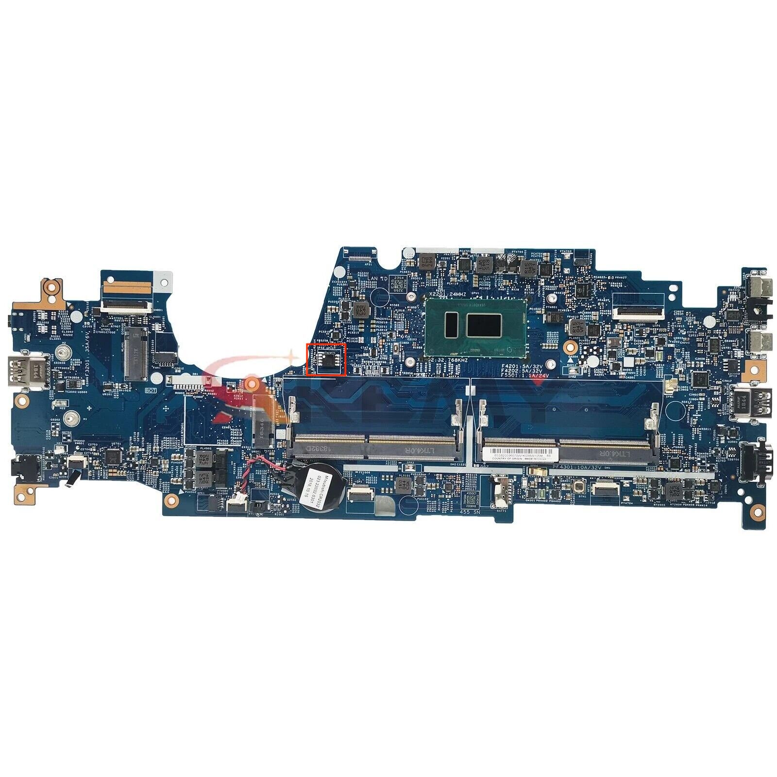

    Hello everyone
    I tried with autopatcher but it doen'nt work.
    I made serveral dumps with a CH341A, when I use the program with any of the dumps it give me this error :
    "Using UEFIReplace to inject 2 DXE drivers...
    [1/2] BootOption (GUID e0746c42-d3f9-4f8b-b211-1410957b9ff5)
    dump.bin is corrupted or does not contain a valid dump.
    There was an error... Aborting."
    - The bios chip is a MX25V80035F
    - I3 Generation 8
    - Serial number R90TAAH9
    Could you please help me to, i join my bios dump

    wrong chipset, try one from the image.

        read the rules, you have to post serial number and motherboard id

          Re: Lenovo L380 Bios Password
          Sorry.
          - The bios chip is a MX25L12873F
          - Bios R0RET37W (1.20)
          - I3 Generation 8
          - Model : 20M6S2YE00
          Thanks in advance

            read again bios chipset, your dump has 1Mb and it should be 16,8Mb
