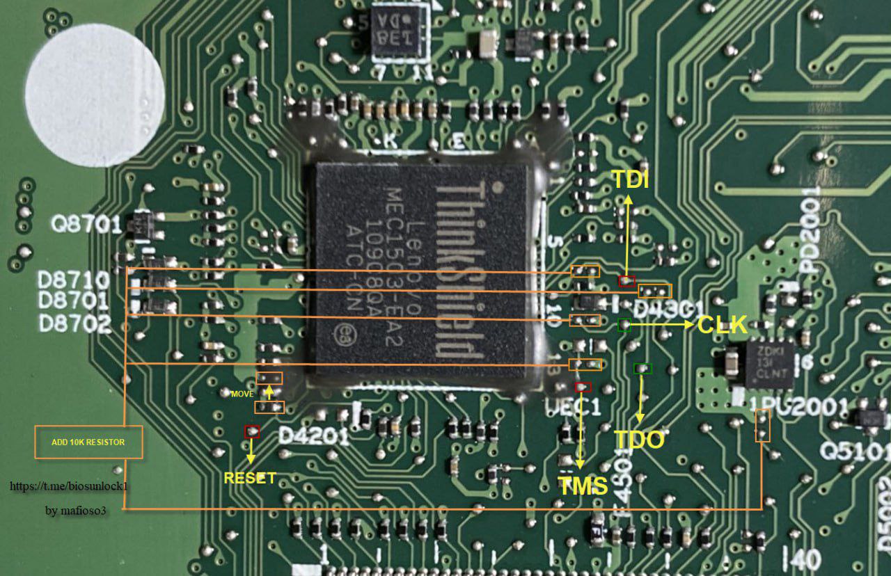

    thinkpad t15 gen2 with mec 1503 pin out
    hi pin out for t15 gen 2 mec1503,havent tried it

    RT809H can't read

      svod 3 can't read
