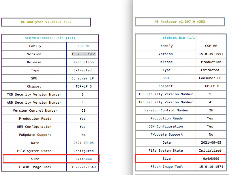

      Hello. I need someone to help me with making new bios from bios update file. I have attached old corrupted dump.
      I have tried to follow the guide on youtube but I stuck in editing and merging the info from old bios in the hex editor after I sucessfuly extracted the bios with AMI_PFAT_EXTRACTOR.
      Can someone expirienced help me make finished bin file so I can try to fix this laptop.
      I have tried some files I found here but I had no luck and I reverted the laptop to the old bios.

        you didn't "sucessfuly extracted the bios", as you can see the length of bios backup and extracted file are different. In the file extracted there is only Bios_Region (among other sh*t) and not ME_Region as well. try this file.
          Unfortunately it doesent work. I have attached original bios update file from Sasmung website before I have extracted it with find_gz125. If you can make something out of it that would be great, if not thank you so much anyways.
            try this one

                      Its the same. I guess problem lies somewhere else. It powers up for 3 sec then shuts itself down. Everything started after bios update through windows update.
                      With the dump corrupted bios in first thread i get samsung logo at least for 1 sec before shutdown. Thank you for help.
                      try clean ME bios without Bios_rgn replaced. And check soldering, it's impossible that if it is a bios problem none of images here isn't working.

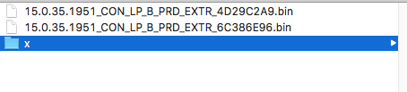

                        Originally posted by phamduy221
                        My original bios #1 still works, the mainboard has a cpu error and I replaced it and bios #2 comes up fast
                        Click image for larger version  Name:	dataurl001339.png Views:	0 Size:	359 Bytes ID:	3473371
                        bios image from post 2 is not working for his laptop, there are 2 ME firmwares 15.0.35.1951 Con_LP_B_Prod_Extr
