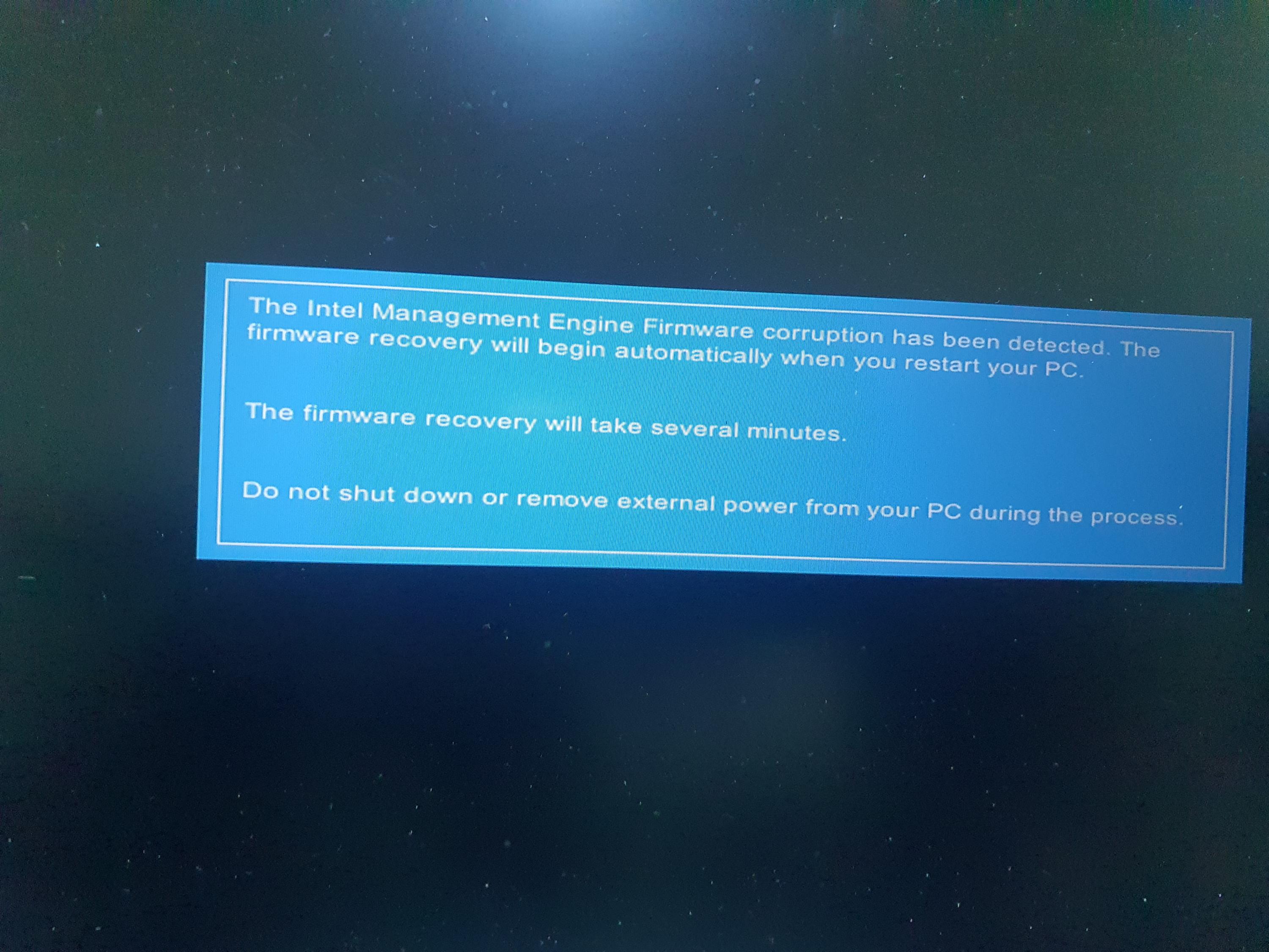

        i have an hp 250 G9 laptop
        after update bios is corrupted
        I need a to fix...pls

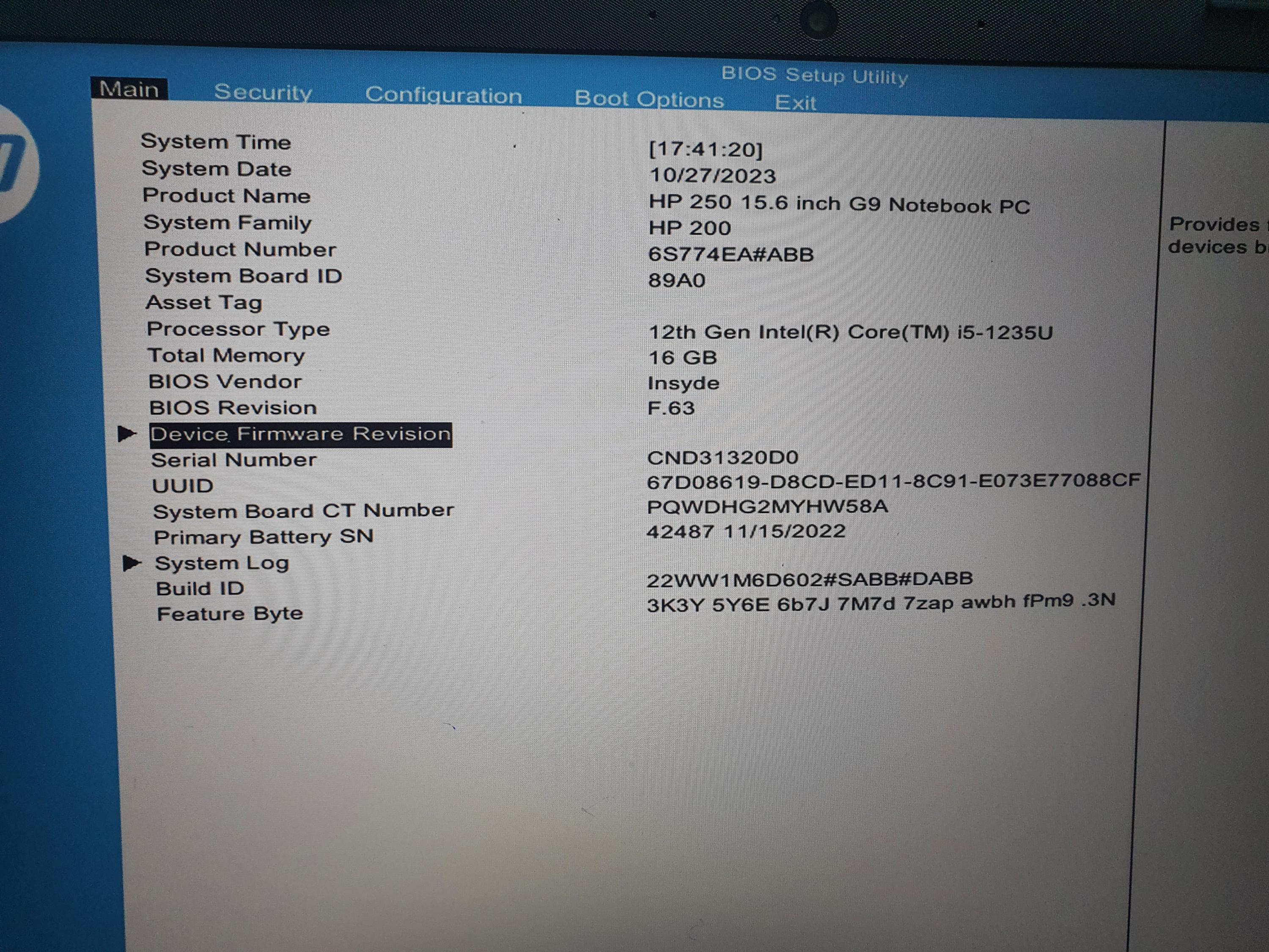

                • Lukian86
                  • Oct 2023
                  • 7
                  • Romania
                  Re: HP 250 G9 New Bios dump needed
                  He's new on this forum so let's help him this time ...
                  @Lukian86
                  try this bios extracted from last update and let us now if works. It was made following the guide made by Vesko356, you can try and see if you get the same result.
                  Thx man, it works perfect!!!!
