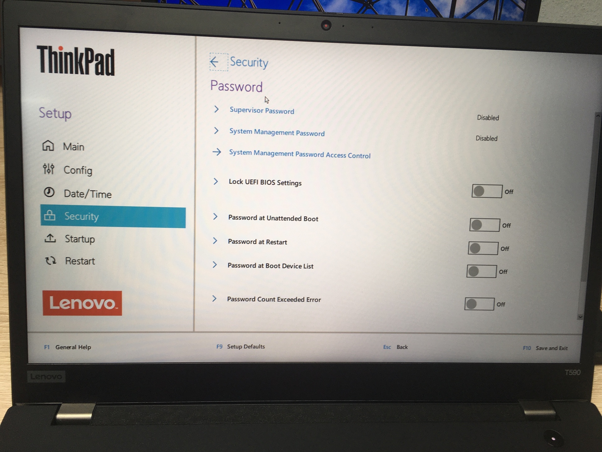

        I would like to ask if anyone has successfully unlocked a Lenovo T590 with MEC163 EEPROM.
        I read a lot about it here and ordered an RT809H programmer.
        I know to read the MEC1663 EEROM, the resistor coming from Jtag_RST has to be moved from pull-down to pull-up.
        Otherwise the JTAG port is not activated.
        I also read that the order should be as follows.
        All powerless CMOS battery battery power supply.
        Connect Jtag port from 1-5 correctly by cable according to RT809H scheme.
        Add 10k resistance.
        Start programmer software.
        Connect the power supply to the motherboard via USB-C.
        Select RT809H from list MEC1663 > read 3x and compare content to ensure that the readout was successful.
        Clear EPPROM.
        Unplug the power supply.
        All powerless CMOS battery + power supply
        All controllers discharge keyboard controllers NVRAM etc.
        Start RT809H again and write back the original EPPROM file.
        I would be very grateful for information.

          Done !!!!

                Originally posted by 12bitvinyls
                Marksu1741
                Hello again, i see that you are online. Will you be able to respond please? i would like to unlock my t590 as well
                Hello!
                Do it like this:
                1.- Read MEC Chip (you MUST select MEC1633_256K - do not select MEC1633#ISP) - read 3x and compare content to ensure that the readout was successful.
                2.- Erase chip
                3.- Unplug power from board for 2 Min and unplug programmer also for 2 Min.
                4.- -Write dump back that we just read.-Password Is now Gone
                Remember to move R/W Resistor Back To Original Position For Normal Operation.
                Then,boot from Lenovo utility disk and insert DMI .
