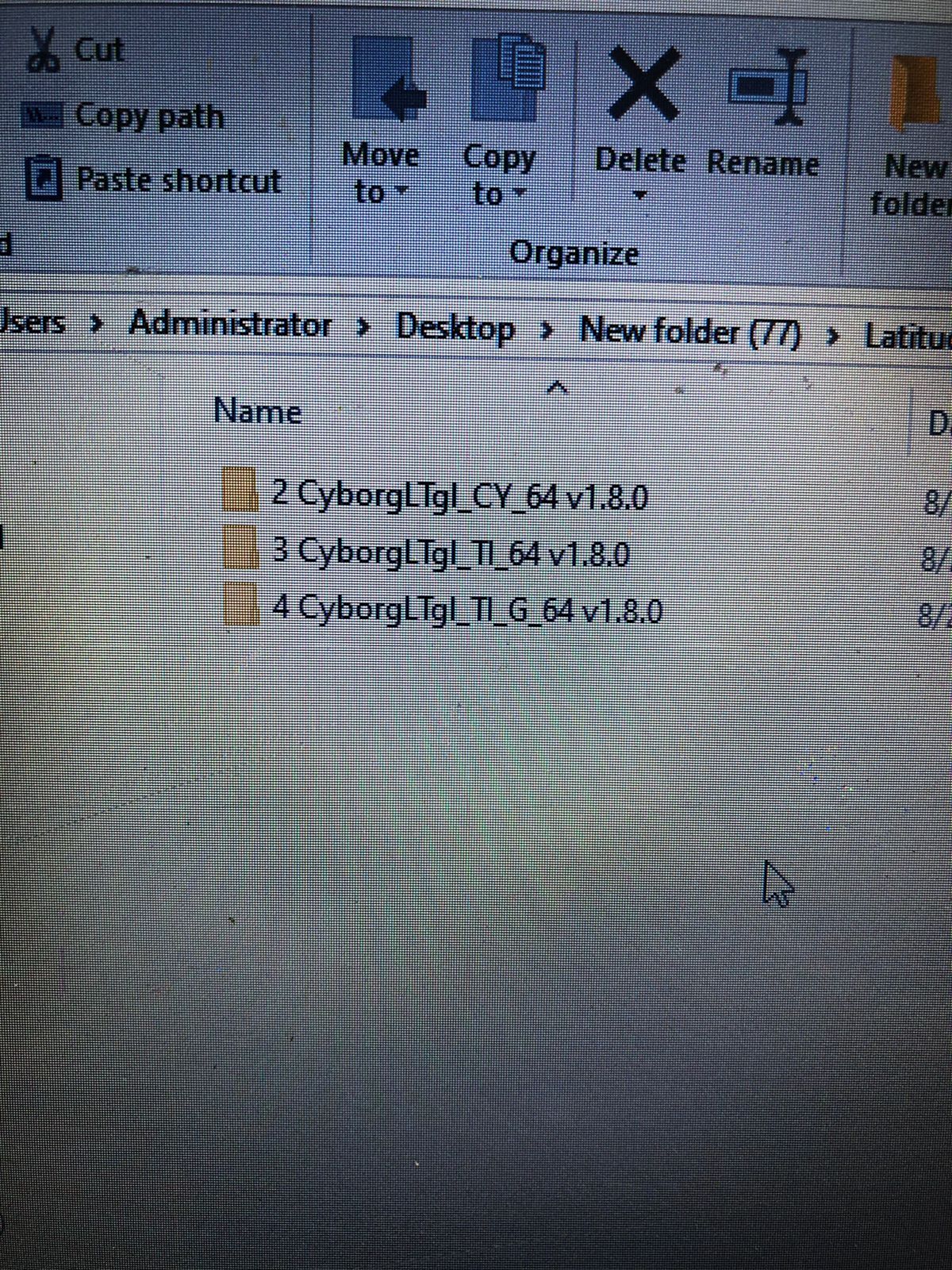

                      I had the same yesterday with a Dell 3420 notebook with 8fC8 password after the modifying with 00FDAA 00FCAA didn't want to start anymore.
                      It worked with locked BIOS.
                      I built a new BIOS and there was a very strange behavior with the 3 series again.
                      I also had the same BIOS version with 1.32.1​

                        #51
                        tried the bios works perfectly.
                        You are correct it worked only on locked bios before maybe the System detects that the entries have changed on some important offsets or else.
                        Strange...
                        But thanks it works again!
                        How do you build a new BIOS?
                        Like is there a programm for it or what?
