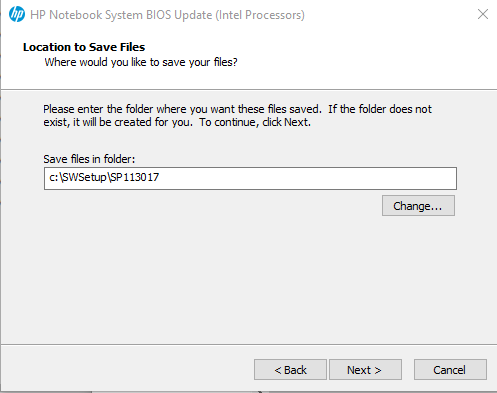

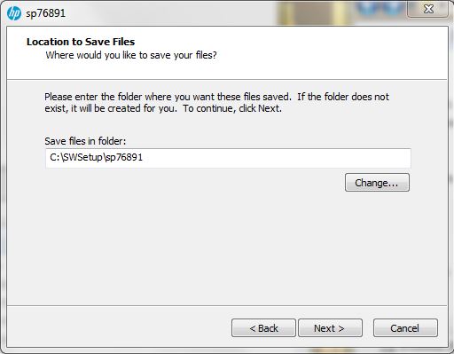

    First the easiest and trouble-free scenario - the files can be extracted the normal way by just running the spXXXXXX.exe update file - double click the downloaded HP update executable file, click next:
    Choose location to save files (or leave the default path C:\SWSetup\SP XXXXXX):

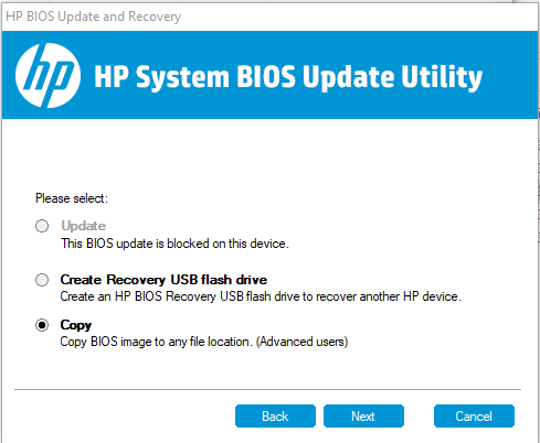

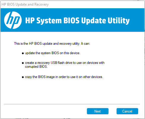

    After a while the HP GUI dialogue box appears, by clicking next giving you the 3 options to choose: update, recovery and copy:
    Select copy, click next, choose destination folder and there you'll find extracted BID.bin file(s) ready for programming. Simple as that.

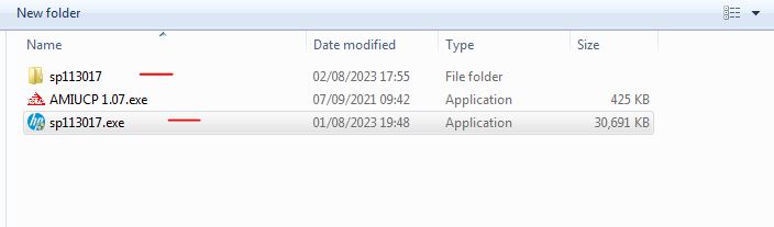

      Now the complicated scenario - in this post there are two bios update executables. Running the exe on Windows 10 will extract the contents to a folder called SWSetup - so far so good.
      But now there is no more dialogue on screen after that and running the file in SWSetup folder named Winflash.exe also does nothing. Checkmate or ...?
      Let's begin:
      This has only been tested on Windows 7 and 10 so far
      ,testing with Windows 11 might produce different results.
      These are some of the more problematic updates you will come across due to different software extraction methods required.
      Each of these updates contains a number of different bios from AMI and Insyde.
      https://ftp.hp.com/pub/softpaq/sp113...0/sp113017.exe
      https://ftp.hp.com/pub/softpaq/sp146...0/sp146979.exe

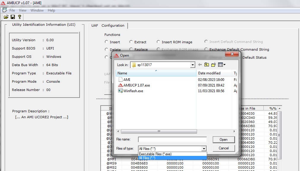

      1. If you are using Windows 10 you can run the sp113017.exe
      to extract the contents (Winflash.exe) to a folder called SWSetup or use 7-zip/WinRAR.
      1.1 If you are using windows 7 extract sp113017.exe using 7-zip/WinRAR.

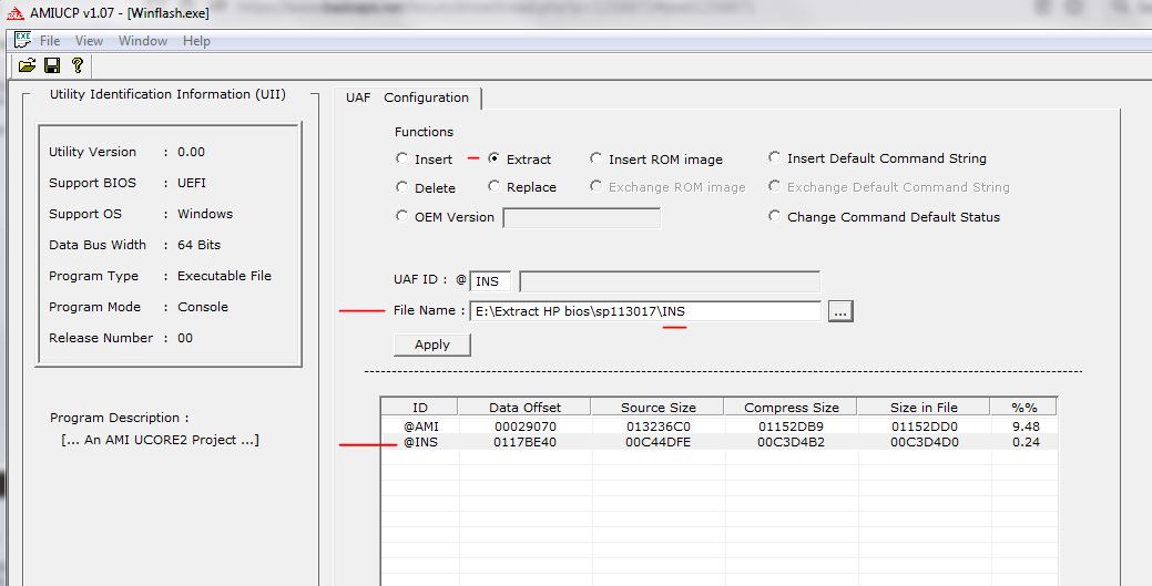

      2. Open Winflash.exe with AMIUCP. Link: https://www.badcaps.net/filedata/fetch?id=2252556
      3. Extract @ AMI with AMIUCP, save as AMI
      The saved AMI file can be extracted with AMI UCP Update Extractor https://www.badcaps.net/forum/showpo...45&postcount=7, or it can be extracted with AMIUCP in the next step.
      4. Open AMI with AMIUCP, use the drop down to see all files in the folder
      5. Extract @R00 and @R01, name them R00.bin and R01.bin
      (Both saved files are full 16MB bios images. In the sp146979.exe
      there are three 16MB AMI bios images

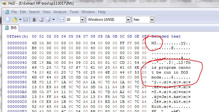

      6. Open Winflash again with AMIUCP and this time extract @INS, name the extracted file INS
      7. Open the saved INS file with AMIUCP, it will fail. We need to find out what sort of file it is.
      8. Open INS with a hex editor, the MZ text and can`t run under DOS means the file is an executable of some sort.
      9. Close the hex editor, rename INS to INS.exe (the file Icon is Insyde bios)

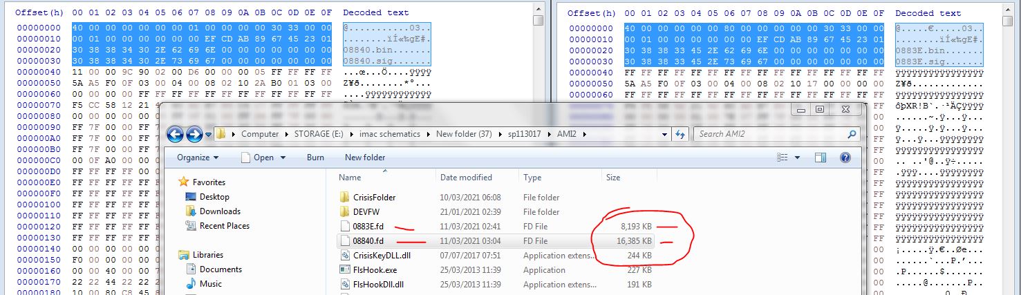

      10. The files can be extracted the normal way by running the exe, the HP GUI dialogue box will give the 3 options to choose update, recovery and copy.
      If you are using windows 7 see #11.
      11. Extract the INS.exe with 7-Zip/WinRAR. Both *.fd files are the bios images, both have a HP sig file attached at the top of the file. Delete 0-3F with a
      hex editor and save.

        Windows 8 laptop example,HP Pavilion Sleekbook 14-b019us
        This bios update will only download from the HP drivers support page if Windows 8 (64 bit) is chosen as the OS https://support.hp.com/us-en/drivers.../model/5351448
        Direct download: https://ftp.hp.com/pub/softpaq/sp765...00/sp76891.exe.
        Running the exe on my windows 7 PC makes it bluescreen.This can happen with some other updates as they will try to install a driver.It is best to run the exe on the same OS that
        the update was intended for,or a later OS.If a later OS won`t run the exe try it in compatibility mode.
        The exe will extract to C:\SWSetup by default,unpack files to another folder sp****** then start the Update and Recovery screen.The bios images in the C:\SWSetup\sp76891 folder
        are encrypted.When you choose the option to copy the bios image to a location it,or they will be decrypted.
        This decrypted bios is 5MB,it has a 1MB EC update together with the 4MB bios image,they must be seperated with a hex editor as the Utility does not do it.
        Encrypted files can be decrypted from the command line with hewprsa.exe,or with phoenixtool if the hewprsa.dll is added to the program folder
