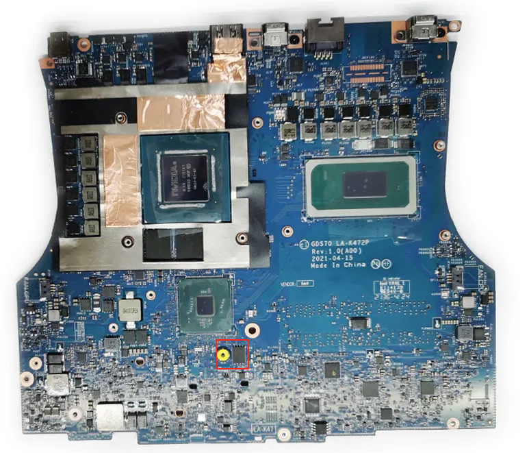

    I have Dell Alienware Laptop P48E001 with system password locked
    Is is possible to clear the password with a cleaned bios dump
    Thanks in advance
    Paul

    Alienware 17 R1 ? , post the full laptop model number ,service tag and suffix shown on the screen (if any) when you enter the wrong password.If there`s no suffix shown on the screen or if there is and its one that can`t be unlocked 8FC8 then post your bios backup.

        attached bios dump
        Thanks in advance

          You dumped the wrong chip.
          The bios should be 32MB in this model.

            Should have known the winbond chip was to easily accessable lol
            Need to strip out the motherboard
            Thanks guys be back soon

              I've stripped it down, but i can only see one other SOP8 chip on the underside
              its a Gigadevice branded GD25Q80CSIG
              can you advise is this the correct device
              thanks

                No.
