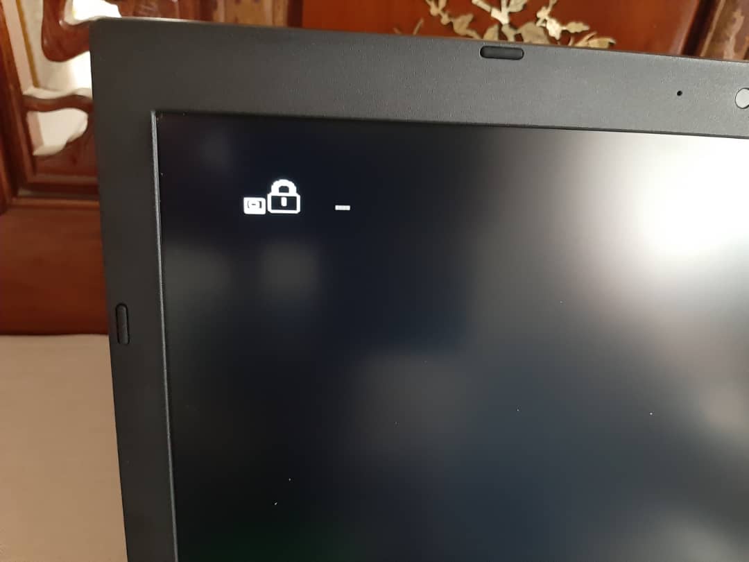

    Greeting to everybody, I read and follow some of the thread here on how to dump out the BIOS by using FPTW64. I managed to dump out BIOS into a file, however I'm not able to find the keyword "Supervisor" in the dump file using HxD.exe editor. What am I missing here ? Could it be the content is encrypted ?
    Thank you in advance.

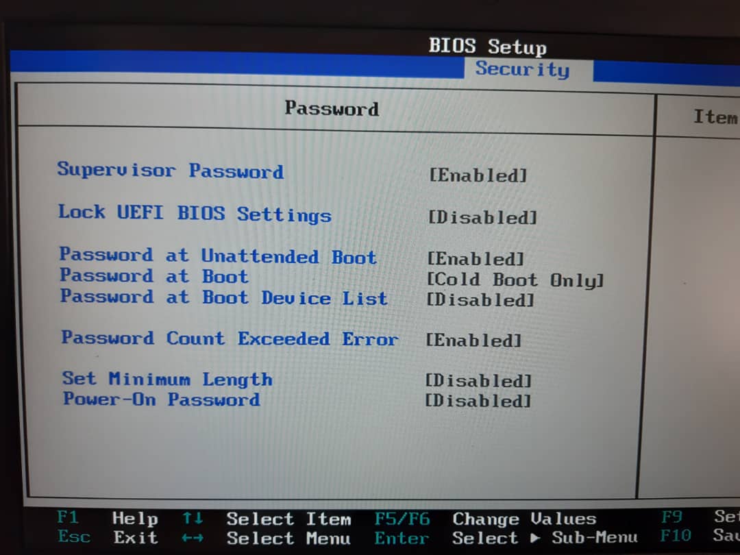

    It's interesting, as it's like a LENOVO ThinkPad BIOS just by looking at the last 2 pictures and after checking BIOS too, so I'm thinking the Auto-Patcher may work, there isn't much information or a motherboard schematic.

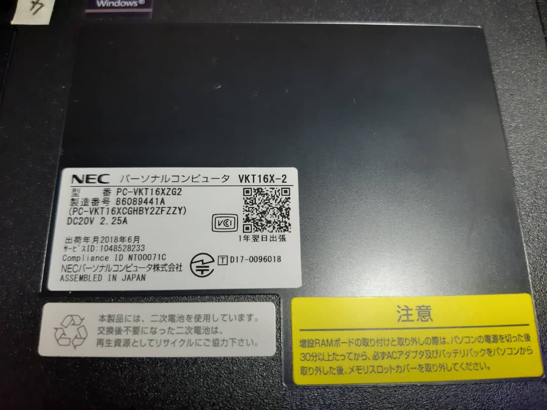

      I also have a NEC VersaPro VKT16XZG2 that has the same supervisor lock (requires supervisor password). Can anyone help me remove it. Details are same as the first post.
      The bios dump file are attached below.
            How did you know it ? looks like Nec uses Lenovo Bios and vice versa:
            https://forums.lenovo.com/t5/ThinkPa...vo/m-p/5115645
