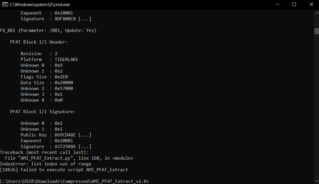

          can someone please extract the 16mb bios file from this BIOS downloaded from official asus site? All I can get is 19mb bios file.

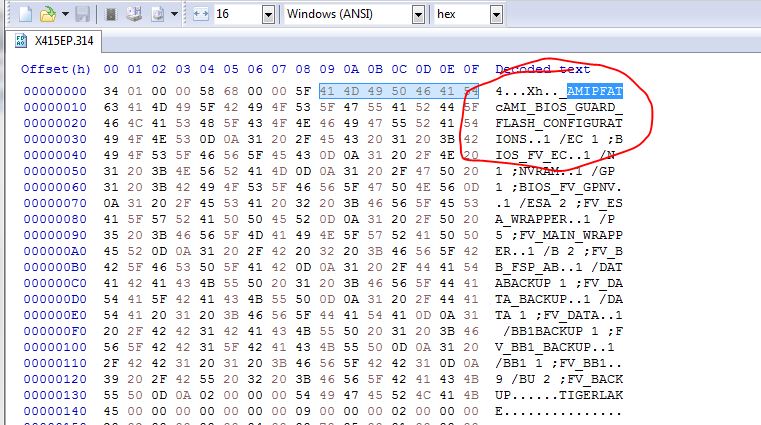

            Re: I need ASUS X415EP bios
            Open it with a hex editor, see the word PFAT .The next step is to extract using AMI PFAT extractor, then it needs further editing to make it the correct size, its only a bios update,not a full image so it will need merging with your backup ,and optionally need the ME firmware cleaning,then after that you can copy the DMI from your backup to the new bios.
            If you can`t do that let us know.
              "failed to execute script AMI_PFAT_Extract"

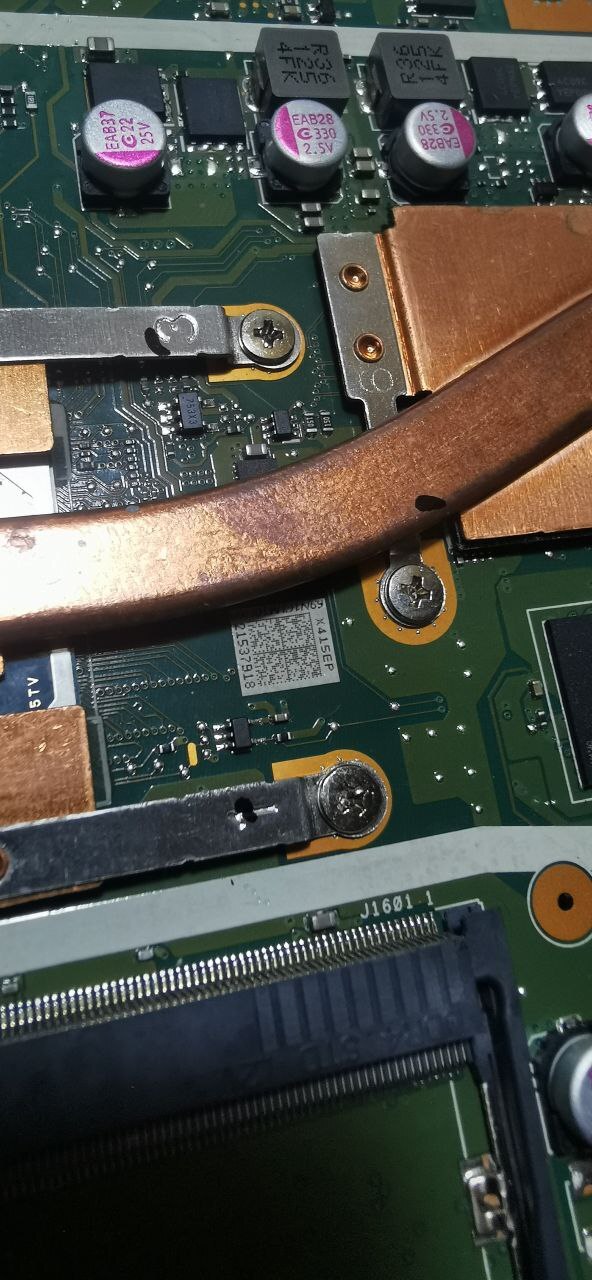

                  Hi, Please help me with my laptop, I try to flash with X515EA , the keyboard works but some keys wont work and SSD wont detect
                  Is there any correct bios file for my unit ? The Model is Asus X415EP on the barcode and X415EA R6.0 printed on the motherboard
                  thanks

                    Please type the serial number, no pictures. https://www.badcaps.net/forum/troubl...before-posting

                      i am sorry, here my sn and complete pictures
                      S/N : MAN0CV026762408
                      Model : Asus A416EPO-VIPS752
                      Boardcode : X415EA R6.0
